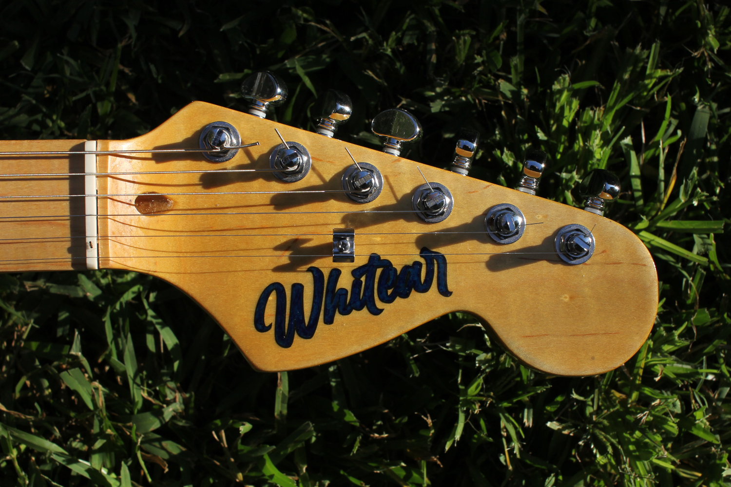

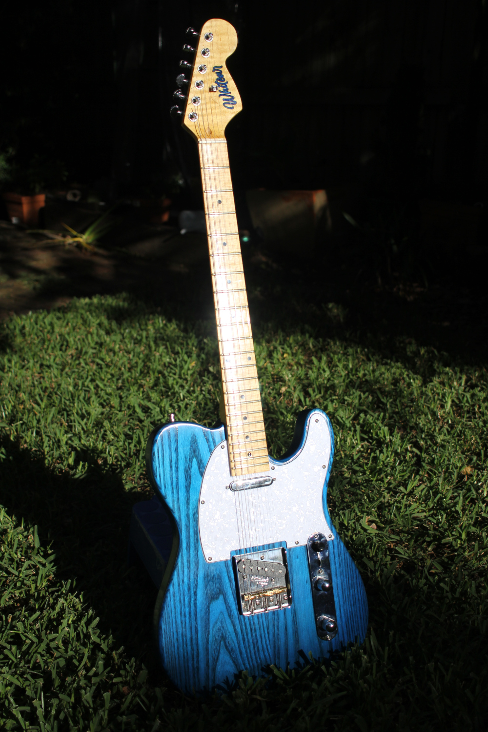

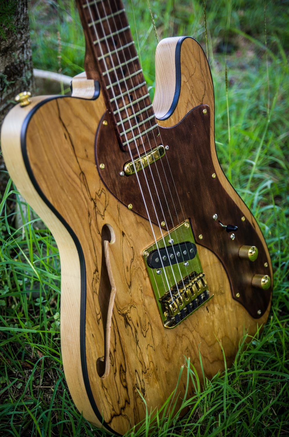

    This is the first kit guitar I've ever put together. I chose the TL-1TH because although I don't have any Telecaster body guitars I've always like the shape. In addition, I had a couple of Seymour Duncan humbuckers lying around that I finally figured I could put to good use. There were three things I was going for which I believe I had moderate success doing. First, I wanted a "burst" appearance where the stain is darker towards the outside binding. For the most part I like it. Second, I added a very few specks of glitter to the finish here and there hoping to occasionally catch the light. Unfortunately they look more like artifacts in the finish. Lastly, I tried to give it a bit of a "relic" look which is why I intentionally bled the stain onto the edge of the guitar along with sanding the edge here and there to replicate wear. Again, didn't come out quite like I had envisioned but overall I'm happy and the guitar sounds killer. Way to go Pitbull!

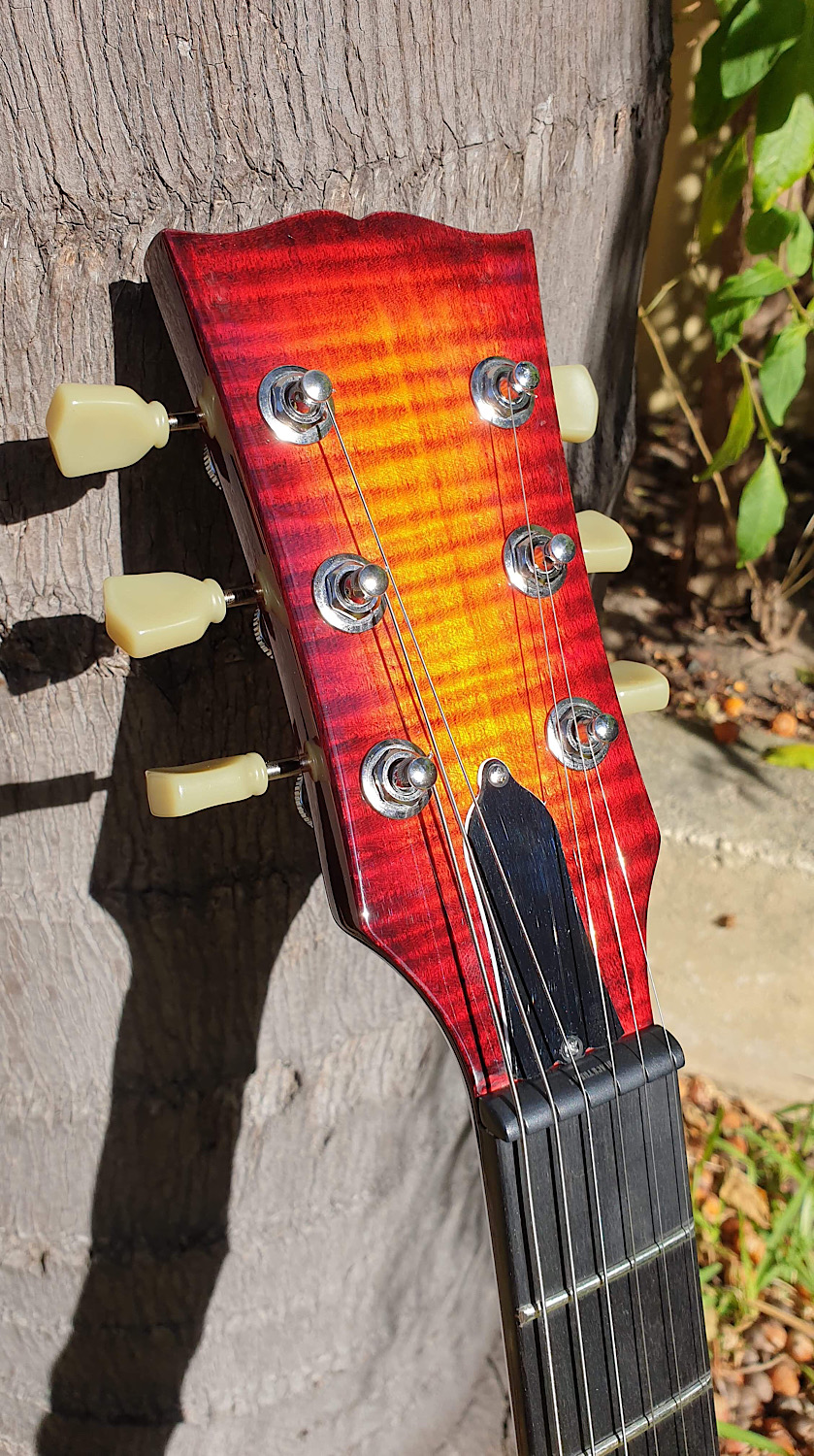

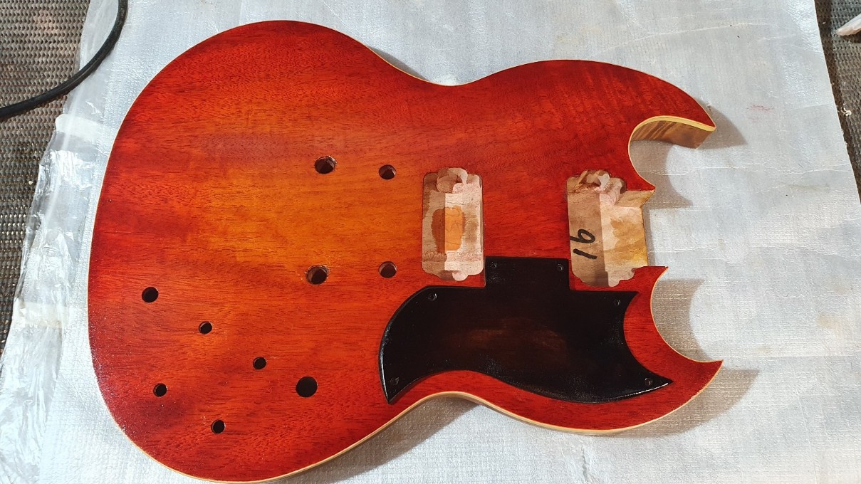

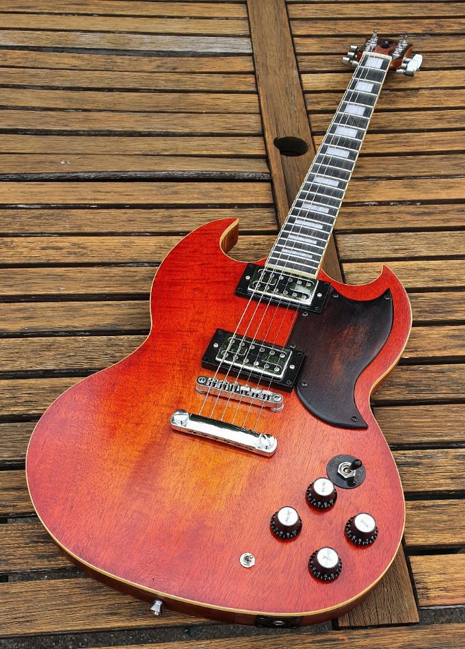

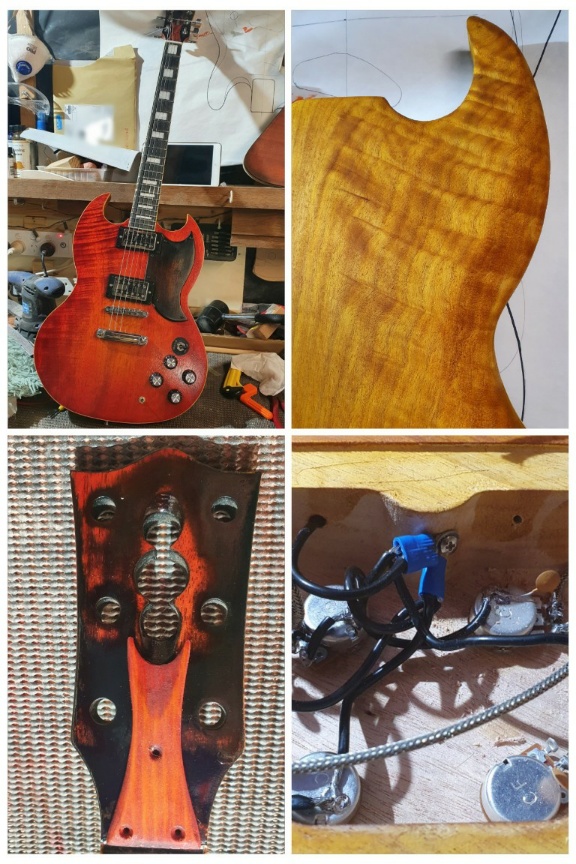

    Here is my SG kit.
    This was a returned custom order.
    Mahogany body with white binding and no contours.
    I have carved in the back contours, stained the top with crimson stunning stains, finished with trueoil, Click image for larger version.
ID:	39154yellowed the binding, moved the output jack to side of the body and popped a switch for coil splitting in.
    Trussrod cover, scratch guard and headstock are my own touch.

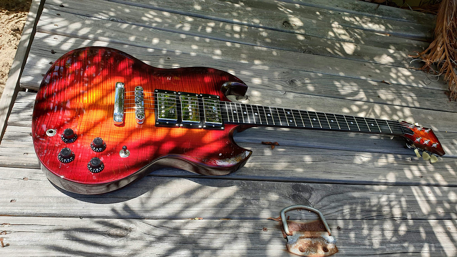

    AGM-1F modified.
    This is my AGM-1F kit that I modified to a stop tail piece, mahogany body and neck, ebony fret board, finished with a stained burst top and a little candy over the top, headstock to match and the back is also stained, all clear coated in 2k clear.
    Guyker locking vintage tuners,
    Wilkinson roller bridge and tail piece,
    Iron gear Blues engine PAF’s with their Alchymist P90 in the middle,
    Tusq black XL nut,
    Bourns pots,
    Orange cap.
    Wired so the PAF’s are selectable from the three way switch, and the P90 is constantly live, all three pickups have individual volumes with one master tone.

    Well done..this is a very nice piece and you should be proud of the work

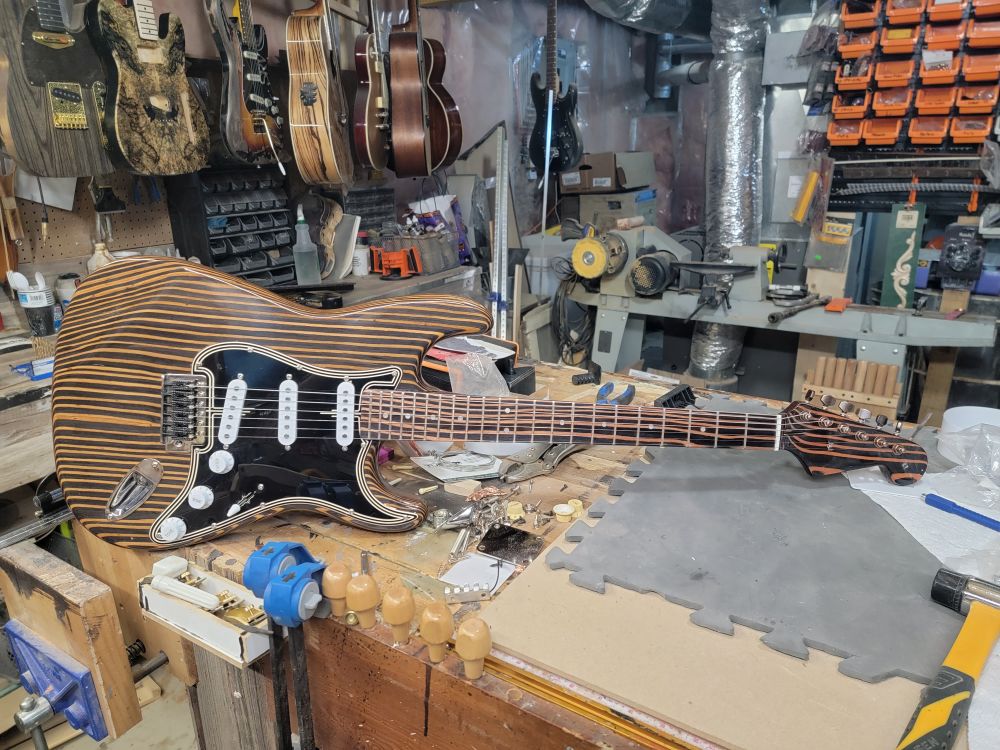

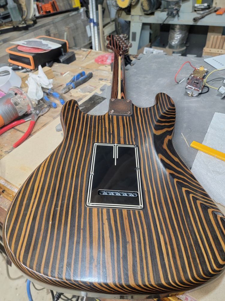

    Entry from Ron M:

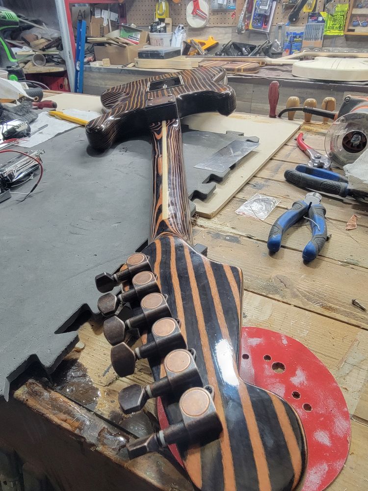

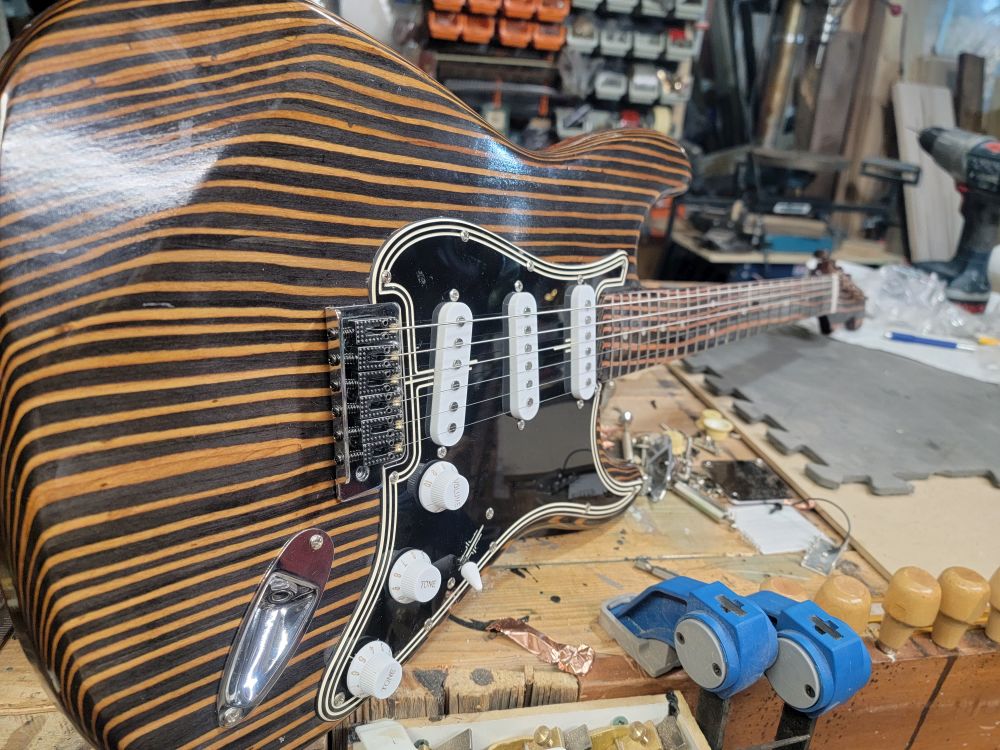

    I can not say enough good things about Pitbull...I ordered this mid covid and had the standard shipping nightmares ( I am in Western Canada) The kit itself when it arrived was epic and the grain match is spot on. fitment is very good and any communication with Pitbull and Adam was excellent. Since i posted this guitar up on some of the builder forums i have been overwhelmed with questions and requests so thank you for sending me something I can be proud of... you guys are true legends and ill be ordering again soon.

    I want so badly to build a zebra strat. That looks awesome.

    Would be nice to hear how it was finished.
