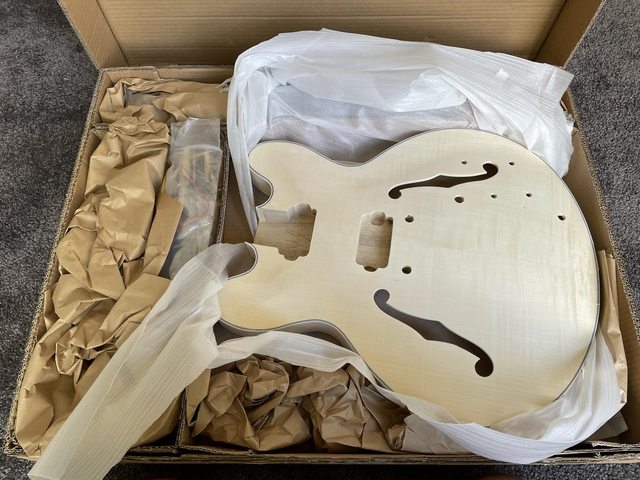

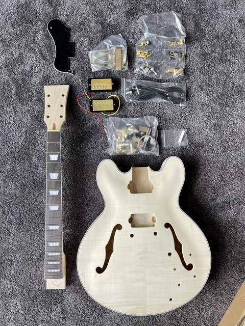

    I did a quick layout and check everything was included in the package

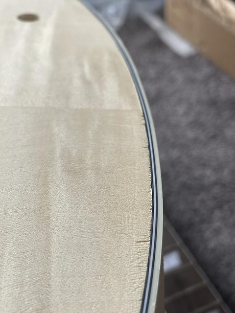

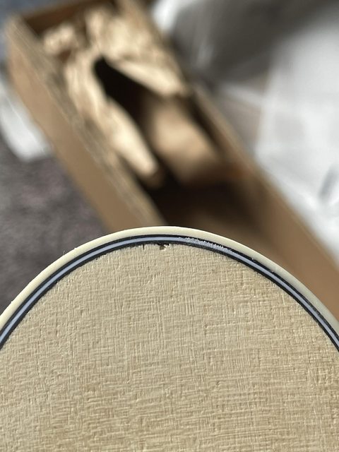

    Some small things that I noticed upon doing an inspection of the body:

    None of these I am overly concerned about. Seem to be fairly standard for these kits from what I have seen.

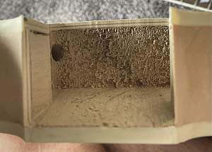

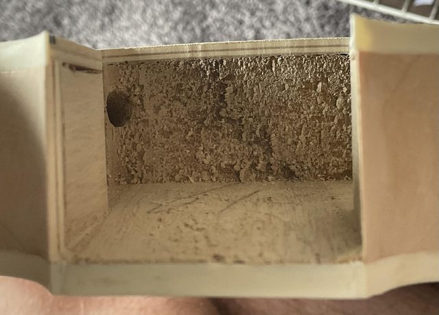

    One thing I did notice that I wasn't sure about is the area where the neck fits in:
    Is it normal for this to have a gradient? I assumed that it would be fairly flat and square with the end of the hole that the neck would fit up against. It's a bit hard to explain but its shallower towards the nut and rises up towards the bridge. I'll whack the neck in there this week and see what angle it comes out on but seems perhaps a bit too much of an angle to it.
    Yes the angle in the pocket is correct. It allows for the proper break angle of the neck.
    You should temporarily install the high and low e tuners as well as the bridge (Just use some tape around the posts, no need to install the inserts) then clamp the neck in place and run some ordinary string down to the bridge. This will tell you that the bridge is properly aligned with the neck and also show that there is enough break angle to allow the bridge to sit up off the body by a couple of mms.
    Also it's very rare for the tang on the end of the neck to fit hard up against the cavity wall, there should be a gap there usually. Using the above method also allows you to check the scale length (628mm for a 'G' scale) from inside of nut to the high E saddle when adjusted most of the way forward.

    Hi there Glen, although I have never build an ES-1 kit it is completely normal (indeed necessary) for the the neck pocket of an arch top guitar to have a few (or more) degrees angle. Being an arch top body the bridge sits higher than on a flat body and the neck angle is needed to "ramp" the strings up to the bridge. When you do your mock-up build you will be able to check to make sure that everything sits right.
    And regards to your first post, just know there are no "stupid questions", only stupid answers.
    Enjoy the build mate.

    Thanks Sonic and Robin!. I thought there would be some angle to it but it seemed like a lot! I'm sure once I put the neck on like you've instructed things will be more obvious. Thank you kindly.
