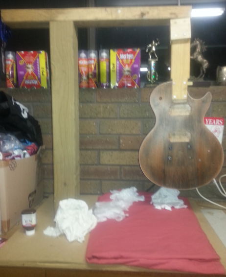

			Hi Alkay, clean water is all you need and yes you do the same with micro mesh pads. Not sure what other liquids may be used as it doesn't need to be that complicated.
Without meaning to insult anyone's intelligence here........you grab a sanding block, a cork one is my preference, wrap your wet & dry paper around it just like you do for normal sanding, then dip it in the water to wet the paper, now start lightly sanding on the dry body or neck, these parts will become moist/wet and the sanded bits will look milky and this residue should be wiped away with a damp cloth. Need to dip the sand block & paper in water frequently as this stops the paper clogging up and also helps keeping things wet/moist on the surface being sanded. It is also a good idea to lightly run your finger tips over the wet sanded surface to feel how smooth things are becoming and also identify areas that need a bit more work.
Don't be fooled into thinking that not much is happening due to lesser effort being put in as you can strip lots off in a blink of an eye if not too careful, particularly when using medium range grits.
Once you get up to the micro mesh pads lots of water becomes your friend as you should not be putting in to much effort and pressure at this stage otherwise you may introduce scratches from gunk caught up on the surface of the pads. When they arrived in the mail they looked a bit small, about 35mm x 35mm perhaps and around 3mm thick however you line them up between index & ring fingers on the surface to be sanded and away you go, hence why you needs lots of water or the light touch will not get them moving.
WARNING: if you have any freshly drilled holes or unfinished bits they will most likely swell once wet and a good idea would be to pre-drill all holes before top coats are done so that you can get a bit of moisture protection down into them holes.
