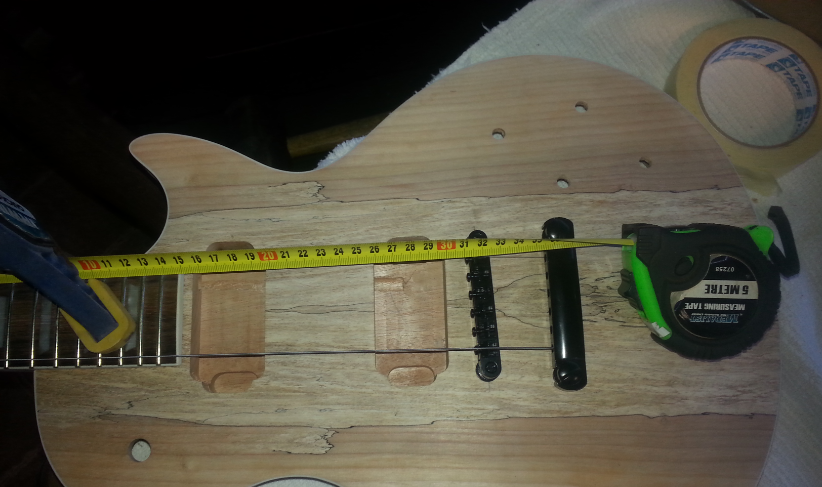

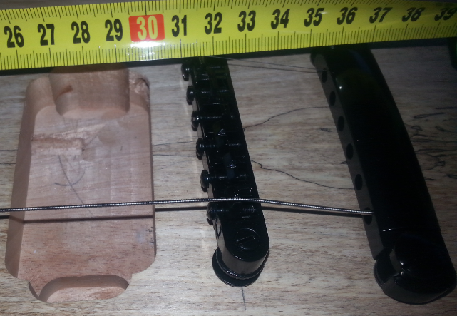

    I would appreciate some help as I'm currently in the mock build stage and there is a problem with the scale length. After researching here are my measurements from the middle of the fret board:
    Inside of nut(opposite side of headstock) to the middle of the 12th fret = 313mm
    12th fret to center of bridge saddle position on body(continuing from center of fretboard) = 320mm
    So the neck is 7mm to long for the neck pocket.
    The neck is clamped and I havent drilled the missing bolt on holes in the neck yet. Its flush in the neck pocket just to rule out measurement issues with the scale length.
    The strings are touching the entire fretboard with the bridge in about the middle of the adjustment range.
    Tilting the neck up gently improves this. I believe I need a shim. The intonation guide here on PBG is good from my last build.
    Before I do anything I would appreciate some help on my first issue for the scale length?
    Cheers Alkay.

    Hey Alkay, there is compensation required for the width of the string, so generally the low E string distance 12th fret to saddle will be about 3-5mm longer than nut to 12th fret.
    Clamp the neck in place, wind both E string saddles as far forward as they go and please give me the distance centre of 12th fret to centre of each E string saddle groove?

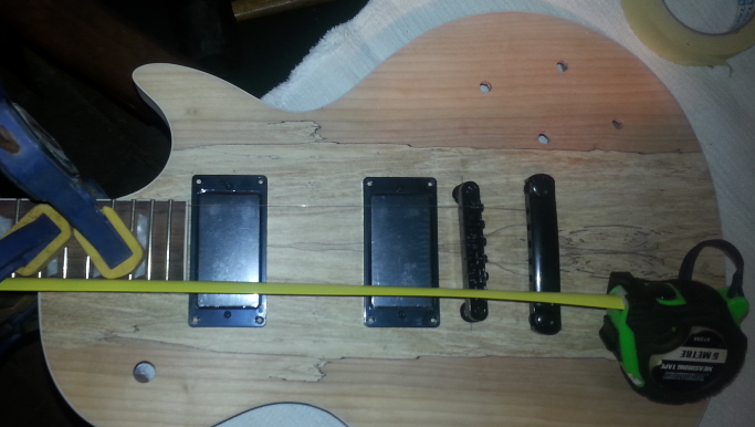

    Hi Wokkaboy,
    Thanks for your help.
    Its a lespaul type shape. I'll attach some photos below.
    I wound the E string saddles forward(direction of nut).
    Centre of 12th fret to high E saddle groove centre = 315mm
    Centre of 12th fret to low E saddle groove centre = 320mm
    Bare in mind the saddles on these kits have a taper on the saddles where actual string contact is made. Three are orientated one way and the other three are orientated in the opposite direction.
    From the high e, b, g the flat vertical edge faces the nut.
    From the low E, A, D the taper is opposite and faces the nut.
    I hope that makes sense and if it is abosolutely critical I can measure the exact contact point the strings make on each of the saddles but you did say centre.
    So I'll leave that one up to you I'm a newbie at this.
    Alkay.

    Hi Alkay, damn I mixed my F and G type scales, of course it's a G type scale !
    so is this a bolt on neck ?
    the measurements sound ok, if we take nut to 12th fret as 314mm (half of 628mm scale) I think you should be able to get the bridge intonated.
    If there isn't much play in the neck pocket and both E string offsets to the each side of the fingerboard frets look fairly even you might as well drill your neck screw holes.
    Usually the screws for the bridge saddle adjustment face the bottom of the guitar so reverse your bridge.
    Once you reverse the bridge please re-check those distances. Bit worried that 320mm is a little far for the low E string but you won't find out till its all assembled and tuned.
    I usually measure to the front (nut end) of the bridge saddle as this is the point where the string will vibrate from

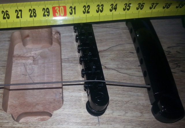

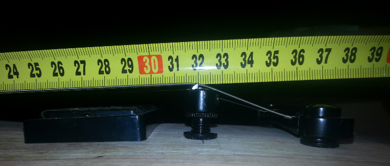

    Hi guys,
    Back to following the instructions. Maybe I was jumping ahead. Just wanted to give more info.
    I was waiting on a third hand to help me with clamping the neck again which is done now.
    I did the following:
    -Bridge is reversed and the screws are facing the bottom of the guitar instead of the nut.
    -Clamped neck again. There is about 0.5mm travel on one side of neck pocket closest to feet. All other surfaces a flush.
    -Tuned both the high E and low E.
    Measurements are as follows after adjusting both saddles forward, towards the nut:
    Centre of 12th fret on high E to nut edge of bridge saddle = 314mm
    Centre of 12th fret on low E to nut edge of bridge saddle = 319mm
    Please tell me some good news hahaha.
    Anyway here are a couple of pics.
    Alkay.
