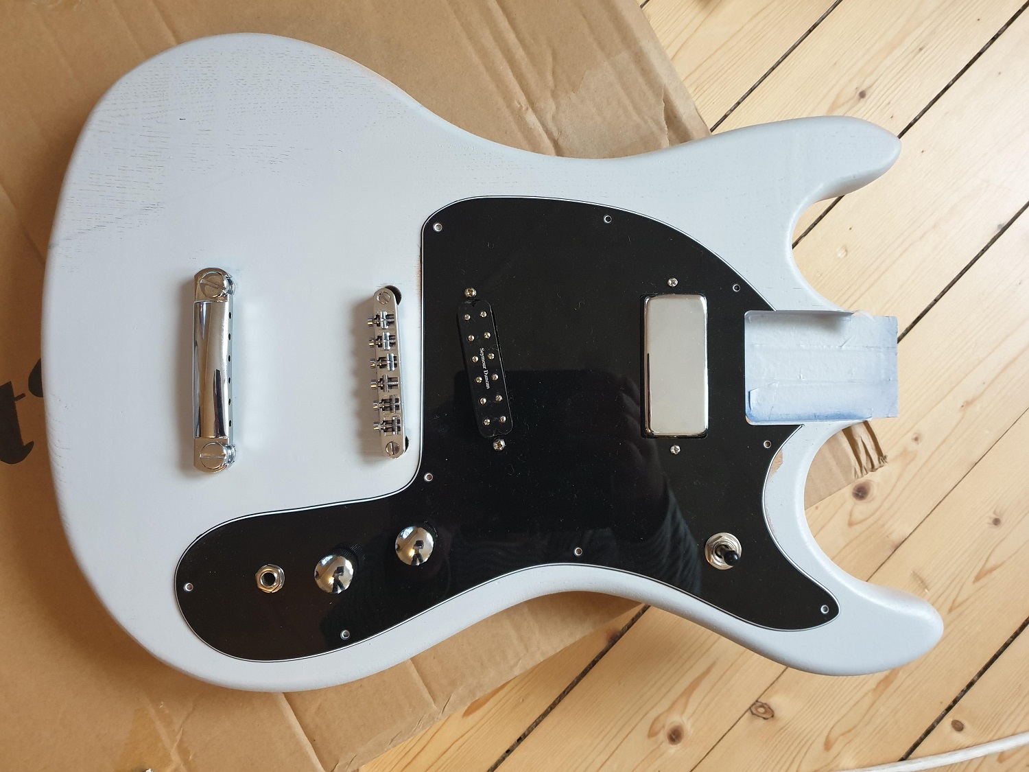

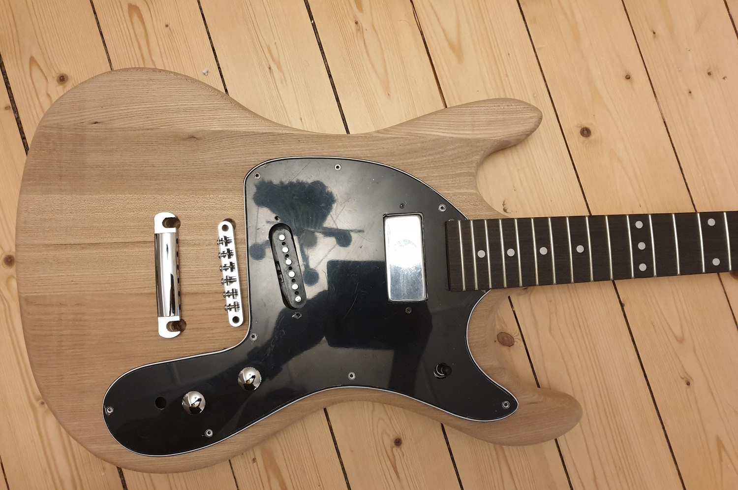

    Moved the holes for the stop bar to a more “Johnny like position”
    Spray coated the body with filler, base coat and first layers of white (note how obvious it is that I did not use filler on the part I slanted for the arm….).
    I’ve also changed the stock pickup to a Seymour Duncan Lill 59 (will later change it to a Dimarzio FS-1.

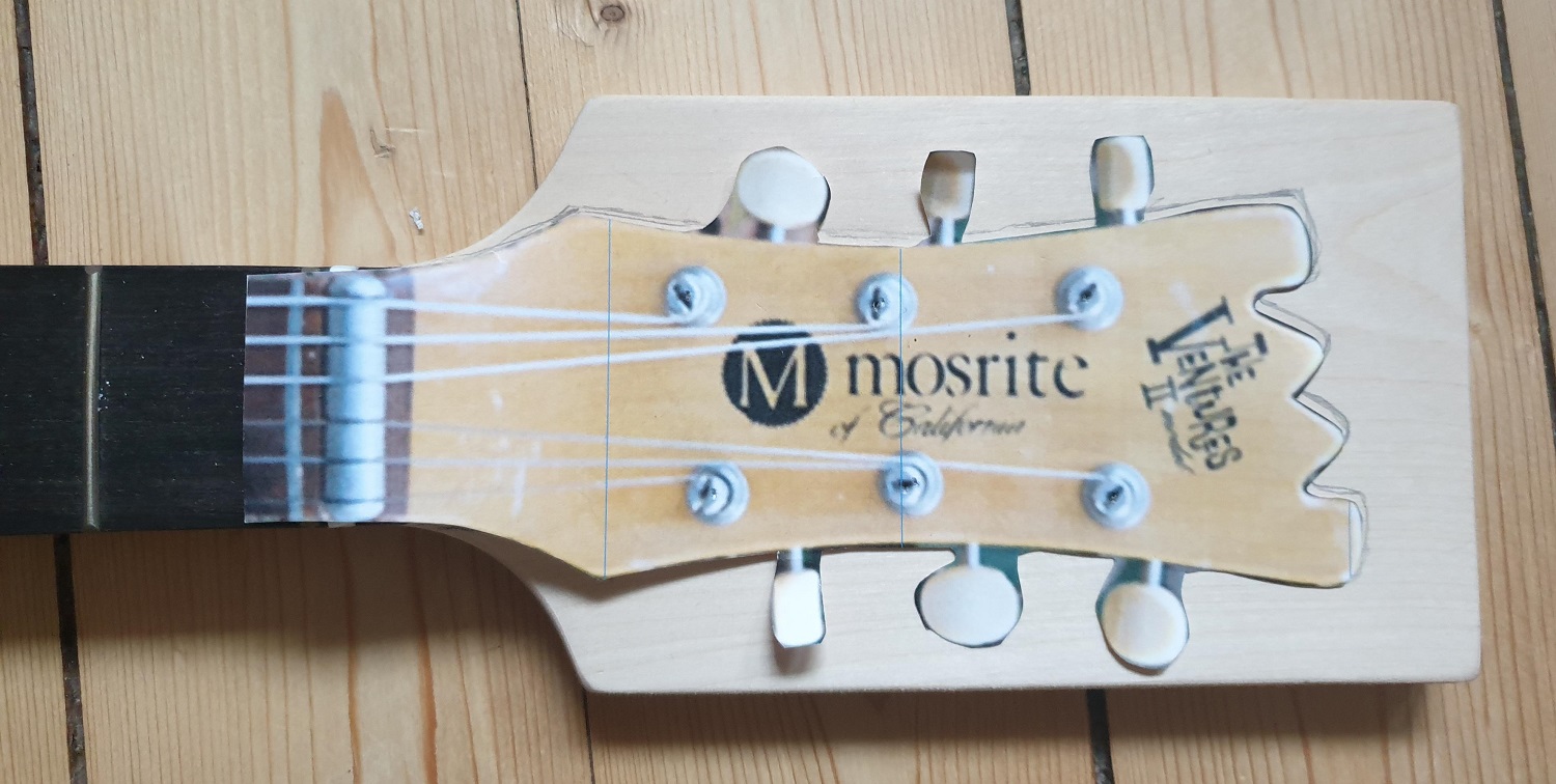

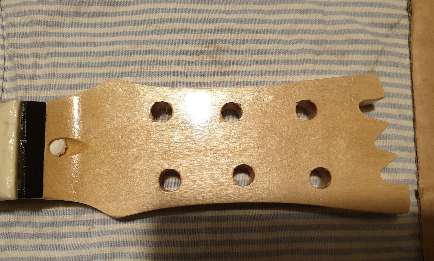

    Outlined the headstock on the paddle head.
    Used a picture that I’ve scaled from dimensions I found on the net AND then adjusted to an average of what I could measure from pictures of Johnny’s guitar.
    The headstock on his guitar IS (I guess that at least) more narrow than most Mosrites. I guess that it is in fact even more narrow than the headstock on the modern Mosrite-copies produced as “the Romones guitar”.

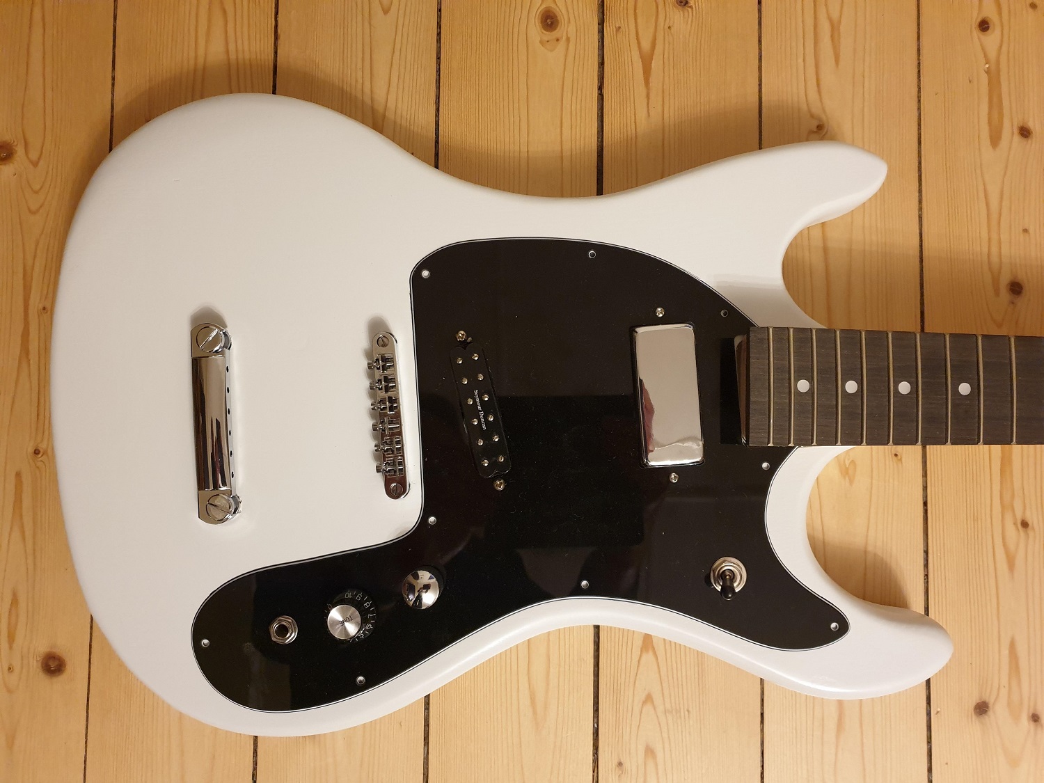

    Changed the white color to one with a bit more yellow as the first turned out to be a bit cold/ almost light blue/grey. Think it will look good! Have also changed the tone knob to one from a SG.
    Next step is to apply autographs from the original members of Ramones. I will seal them on top of the guitar with clear coats.

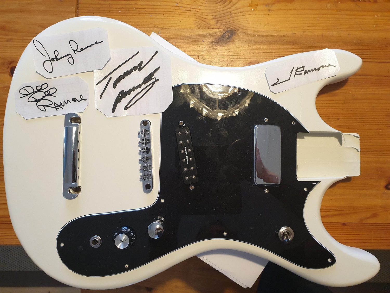

    Playing around with the signatures...

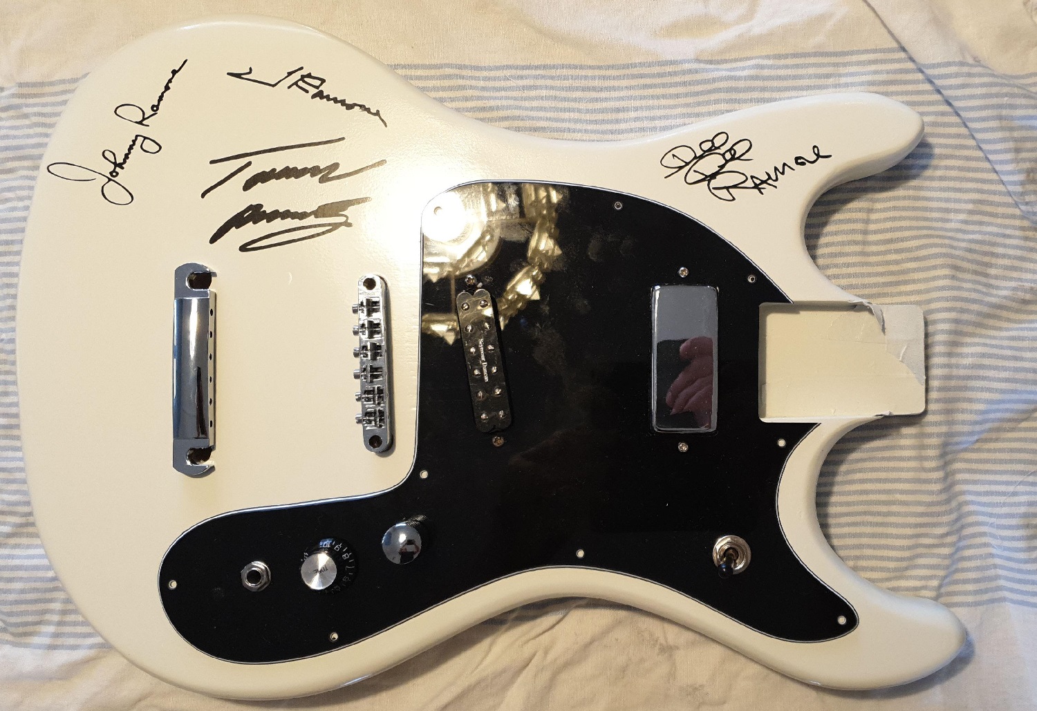

    Ready for a few layers of protective clear coat. I do like it so far!
