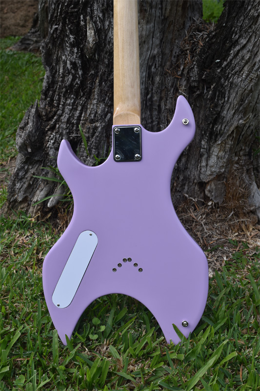

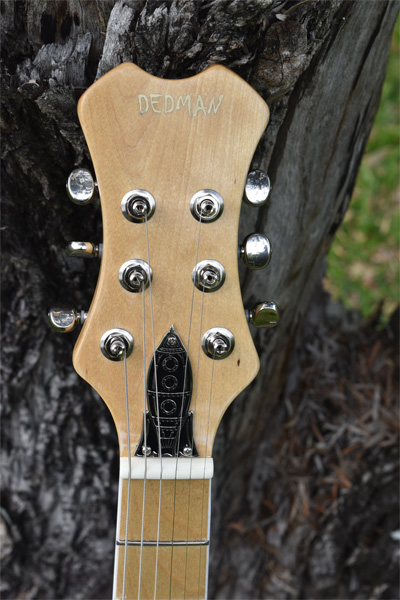

    my Kustom ordered WL kit. Ordered with no bridge or trem routing.
    So this build was intended to answer the question no one asked "What if Leo Fender had designed the Warlock?"
    Basically I rounded off all pointy bits quite a bit. I had ordered white fretboard dots but the factory did black, so I replaced them with whiteish MOP. My first attempt at drilling a string through and even though I used a drill press one is wonky on the back. Speaking of the back I made a control cavity cover from some 3 ply scratch plate material. Bridge is a Schaller roller, I really like these. Tuners are Duesenburgs, I'm kind of partial to those too. Pick ups are GFS Gold Foil alnico's, they have a bit of a generic sound, nothing to be excited over. I have them wired to split on the volume and tone pots. I bought 3 LP switch surrounds and flipped them over to give me 3 plain white rings around the controls, the knobs are clear chicken heads with part of the inside painted in the body colour which incidentally is LILAC not pink! It's a late 50's Oldsmobile colour in keeping with Fenders use of auto colours. And last but not least the truss rod cover is from Hell Guitars in Japan.

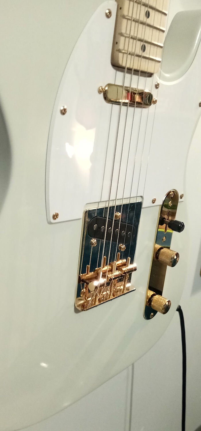

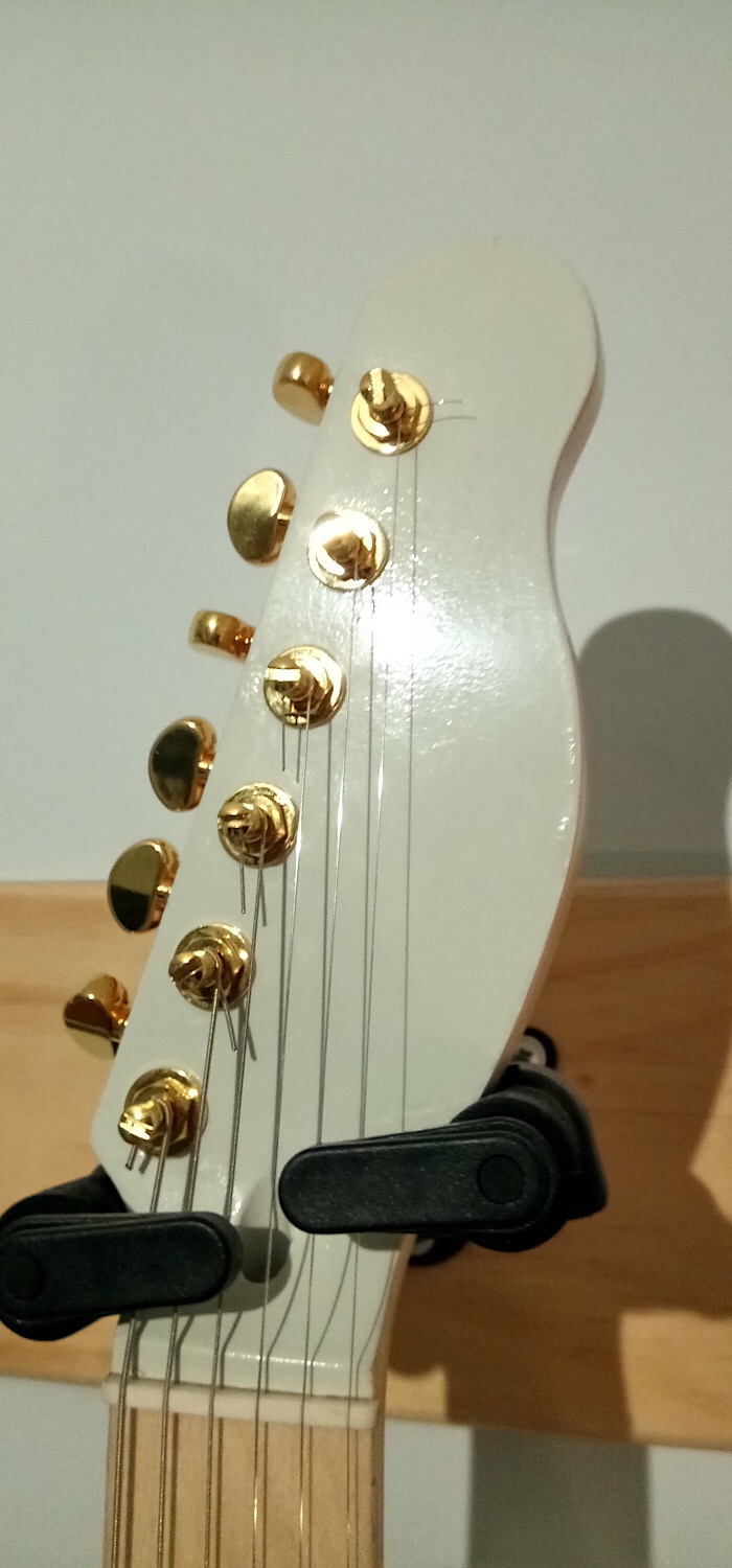

    Hello

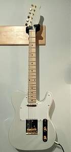

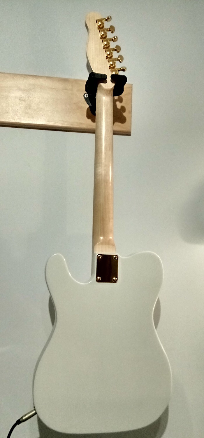

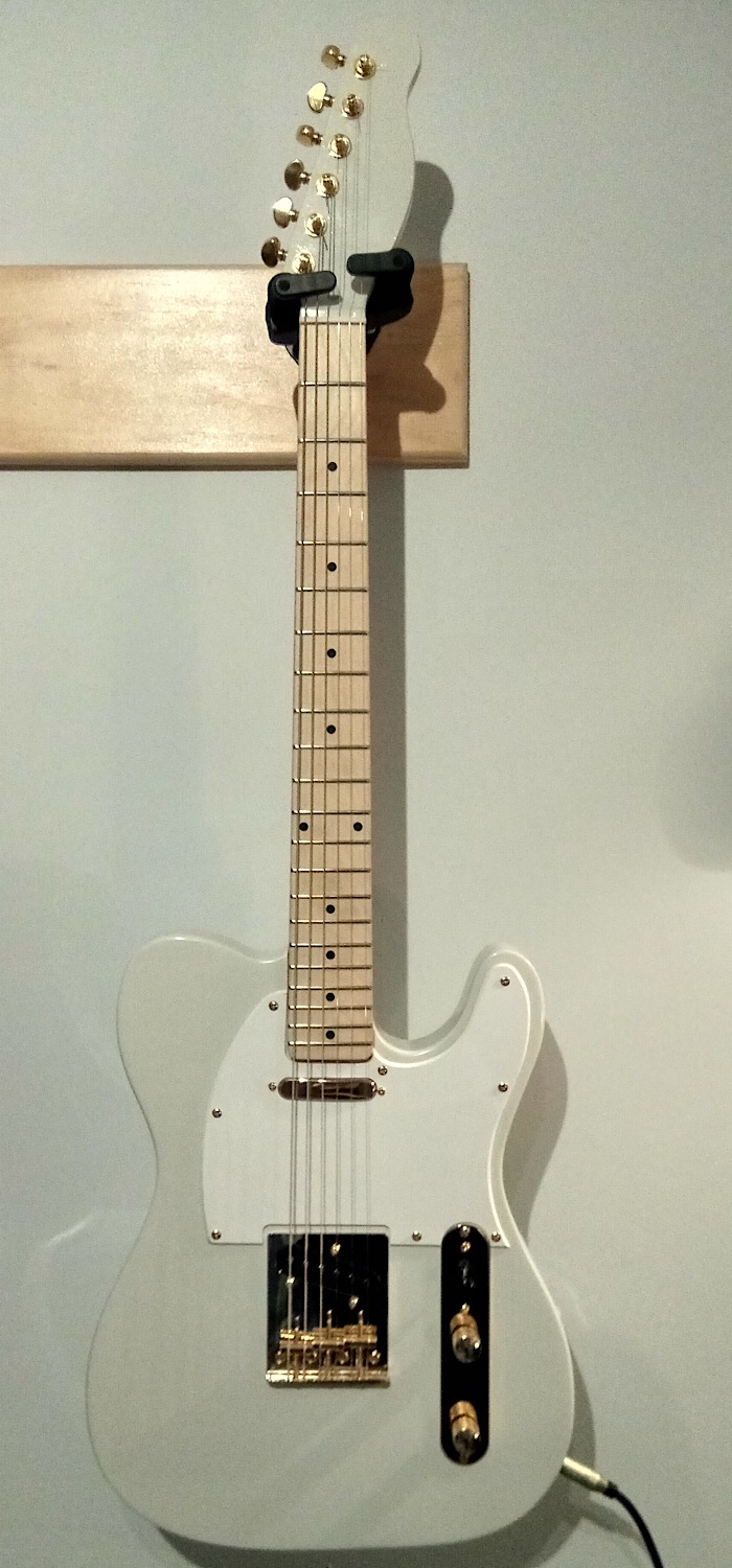

    Here is my recently finished TL-1 kit, the very first kit I’ve ever made and entered into GOTM. I got it for my birthday and I have spend many weekends working on this. I went with a Tele as I heard it was a good place to start and I sure am glad I did. I love the white and gold colour scheme and it feels different to play than my Strat but a good different. Along the way I didn’t have too many problems and whatever problems did occur disappeared quickly.
    Not only do I think it’s great, my friends at school all love it and can’t get over the fact that I made it. Someone even offered to pay me to make one for them.

    Couple of fine looking entries there, Dedman awesome as always & huge congrats on your first guitar Diggy!
    Really nice work Diggy, looks mint for a first build, well done!

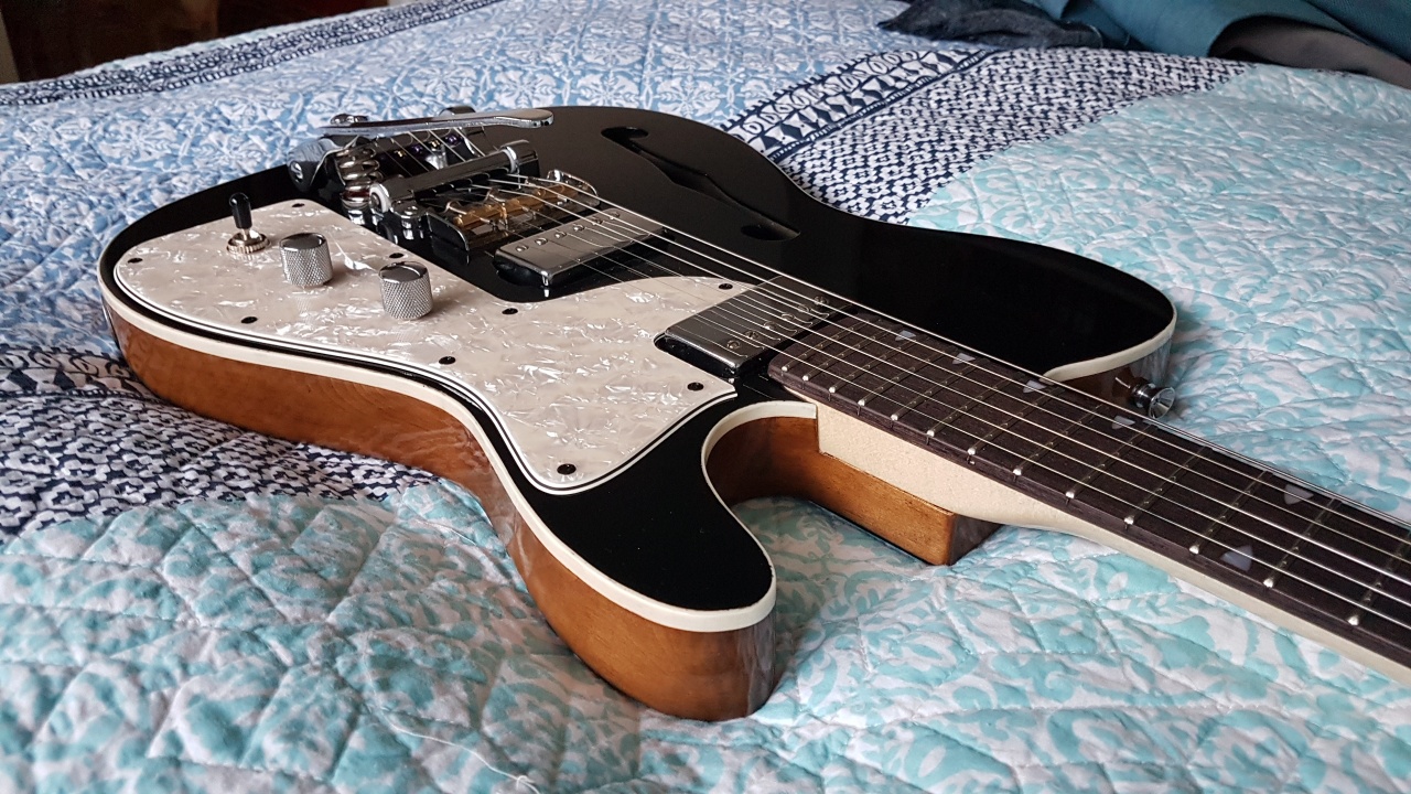

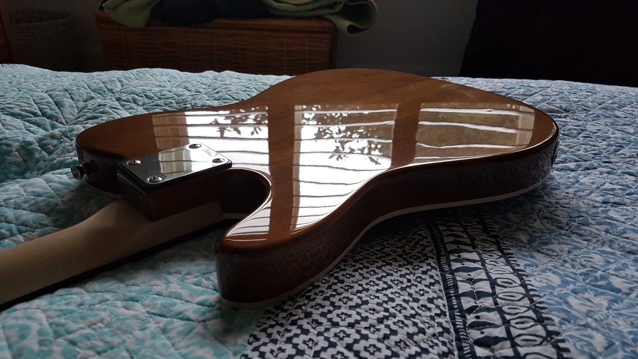

    Here's my completed JTL-1 "Tele-Master"
    Natural TruOil finish.
    Tusq nut, Grover mini rotos.
    Fully adjustable tele bridge.
    MusicLily pups.
    Recessed Jack.
    Oakes Grigsby 4 way switch wired for 4way tele options. Orange drop cap with cloth wire.
    String thru body with neck ferrules.
    More info and sound demo in my build diary, link in signature.

    You've got to be happy with that!
