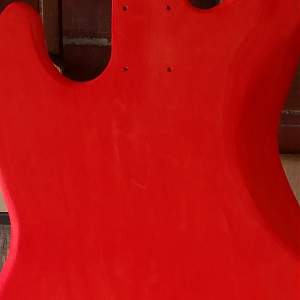

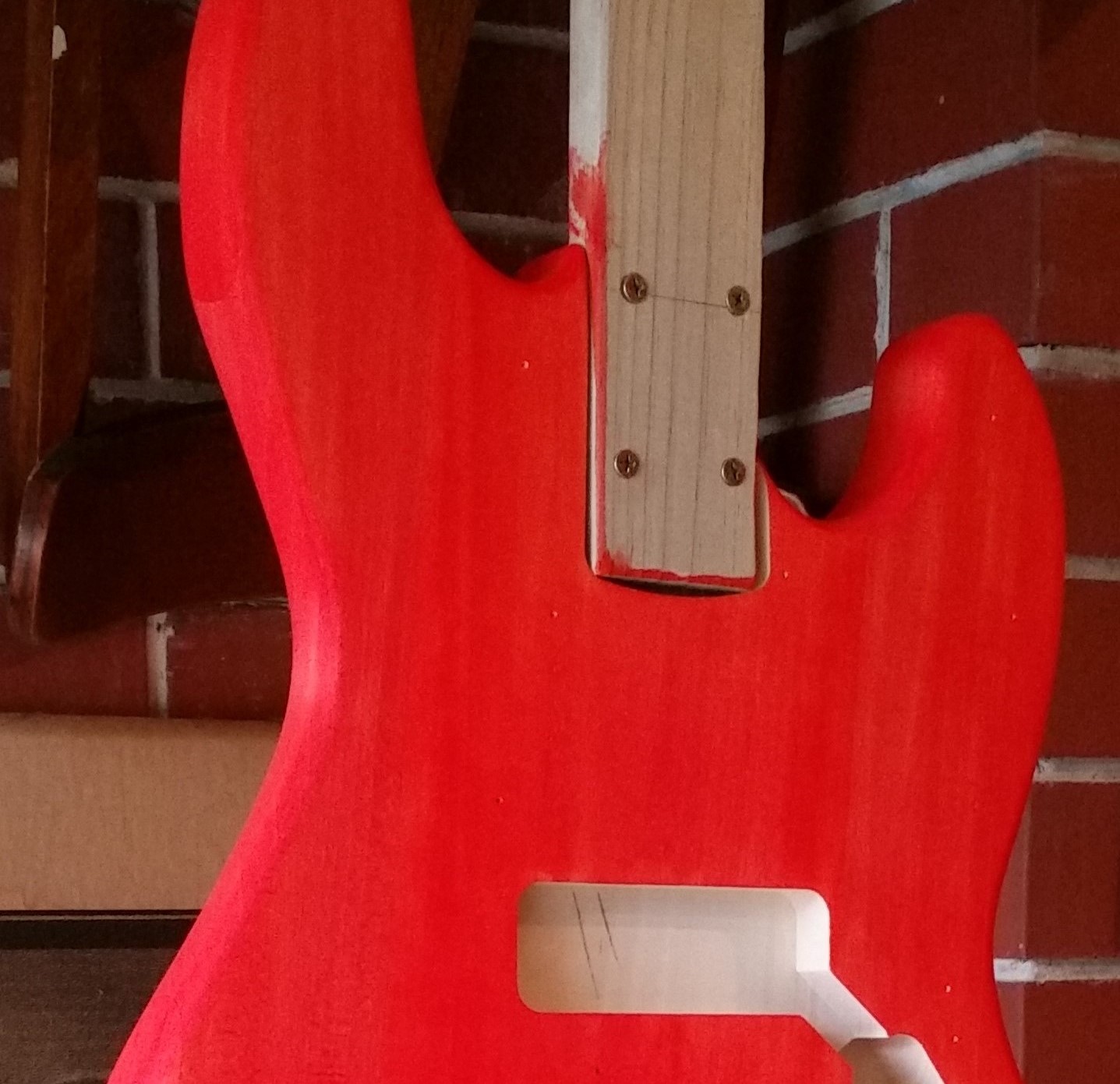

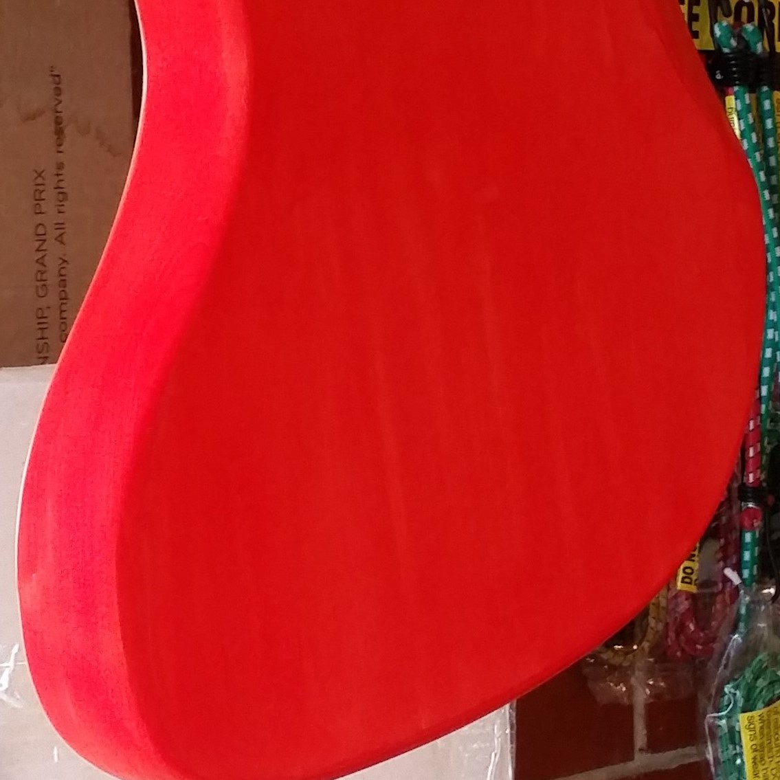

    First coat of dye is on! Am using Jacquard Basic Dyes - powdered aniline type dye mixed with metho. It looks a bit red, but is actually a burnt orange.Click image for larger version.

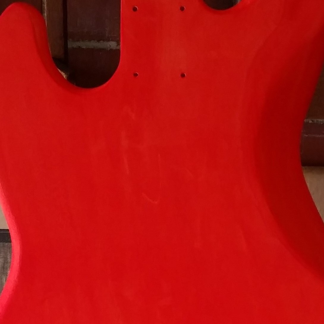

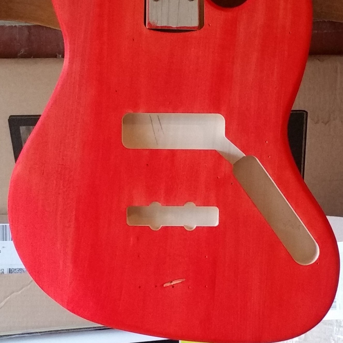

    Have now added 3 more coats of stain & am happy with the deep burnt orange colour. 3 full coats of Tru oil & the micro mesh pads have arrived. When I start to wet sand - what do I use for the "wet" & which grit to kick things off?
