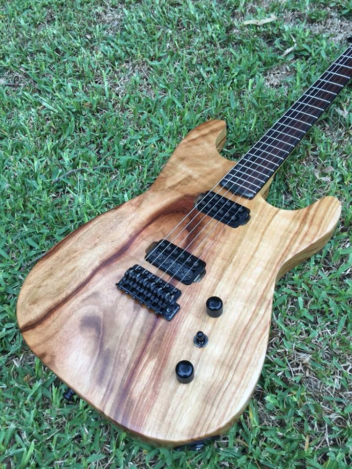

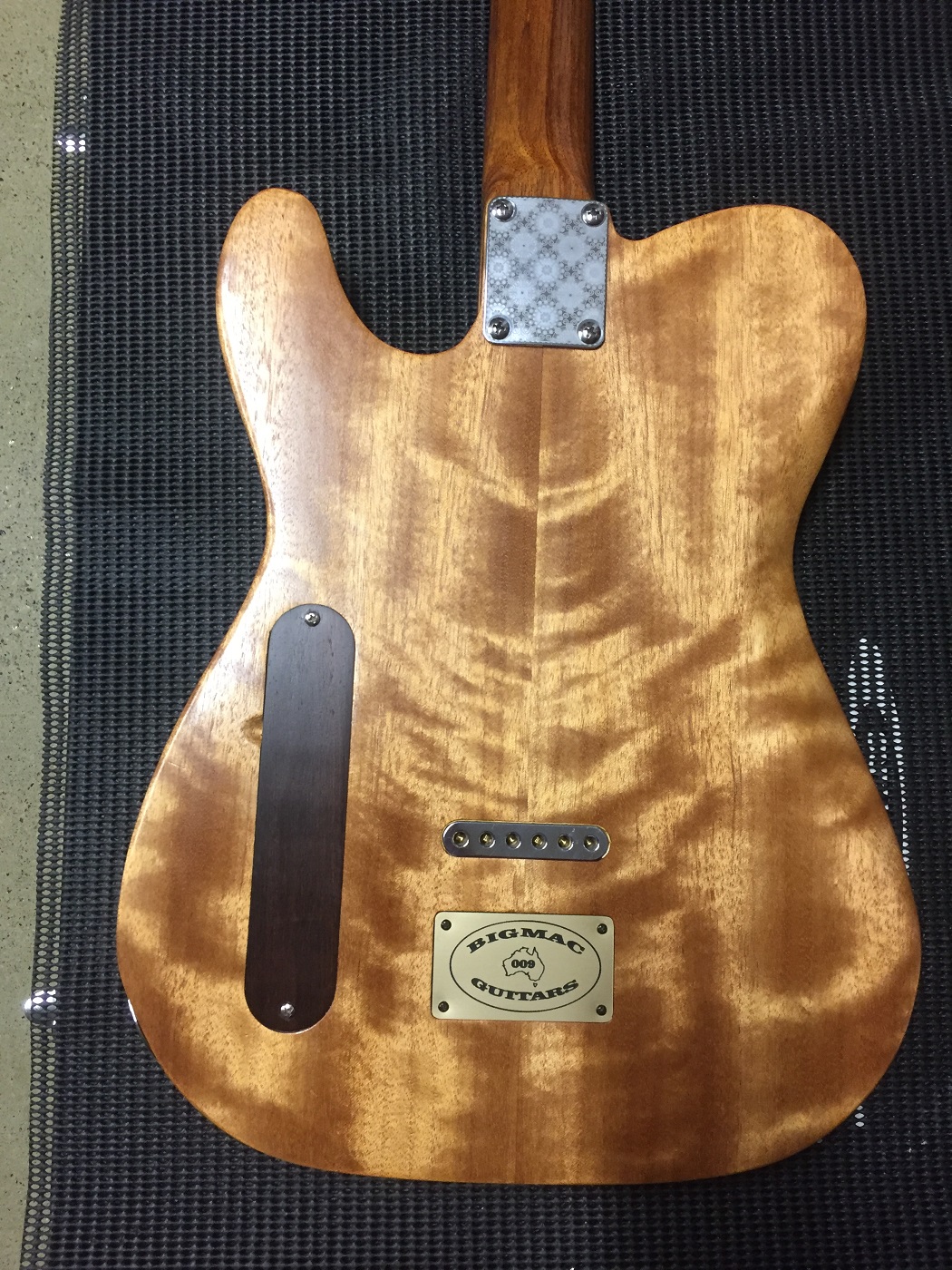

    Mentor vh2580's Avatar
    Cleveland Qld
    1,184
    Camphor laurel, Queensland maple.
    Both can have nice figure and not bad on the weight
ID:	31232   Click image for larger version.
    Tony

    @ vh2580 - Like thte way you "hardtailed" the vibrato for a string-through on that tele! Cool idea.
    Canberra, ACT
    249
    I think you'll find they're two different guitars. Top is Camphor Laurel and the bottom is Queensland Maple.
