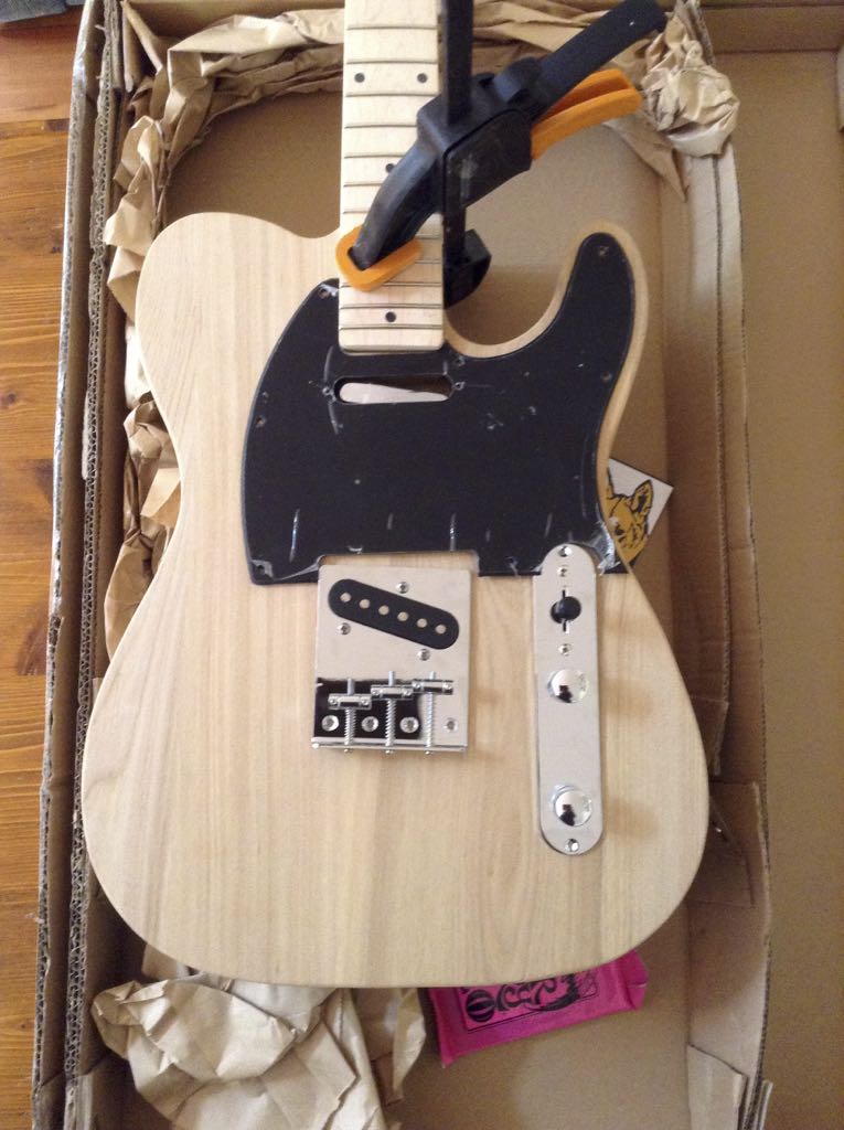

    So.....its arrived.....positively shitting kittens with anticipation.....
    So first things first......managed to get the packaging open without destroying anything.....result.

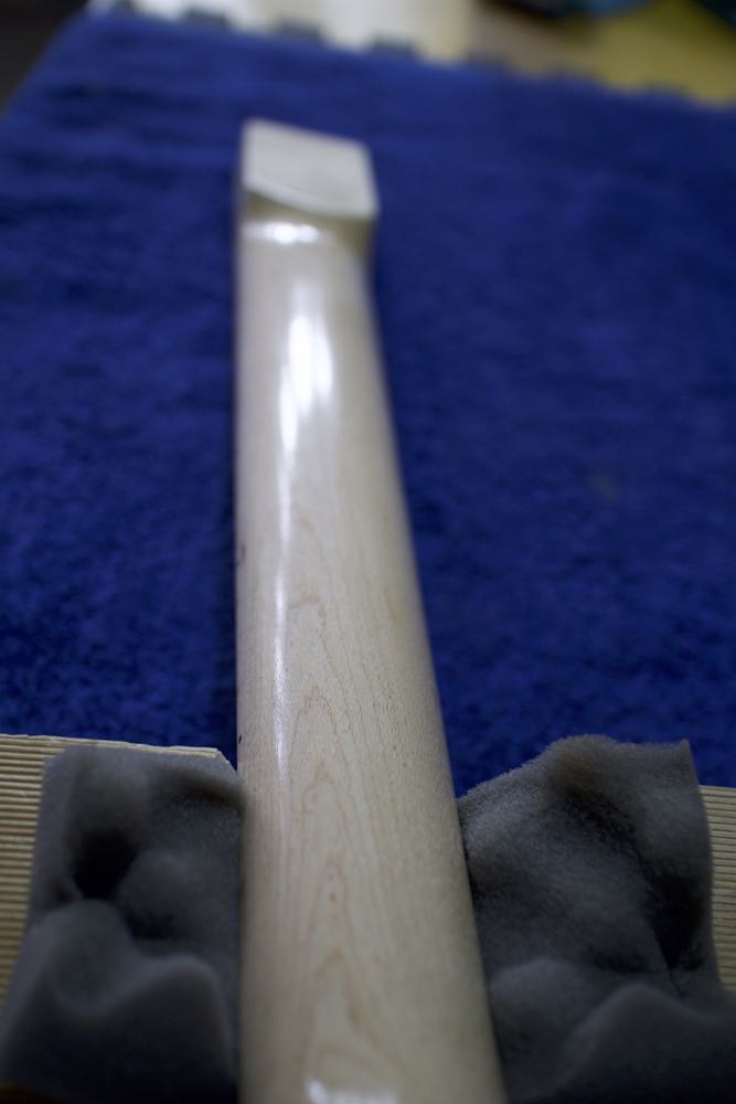

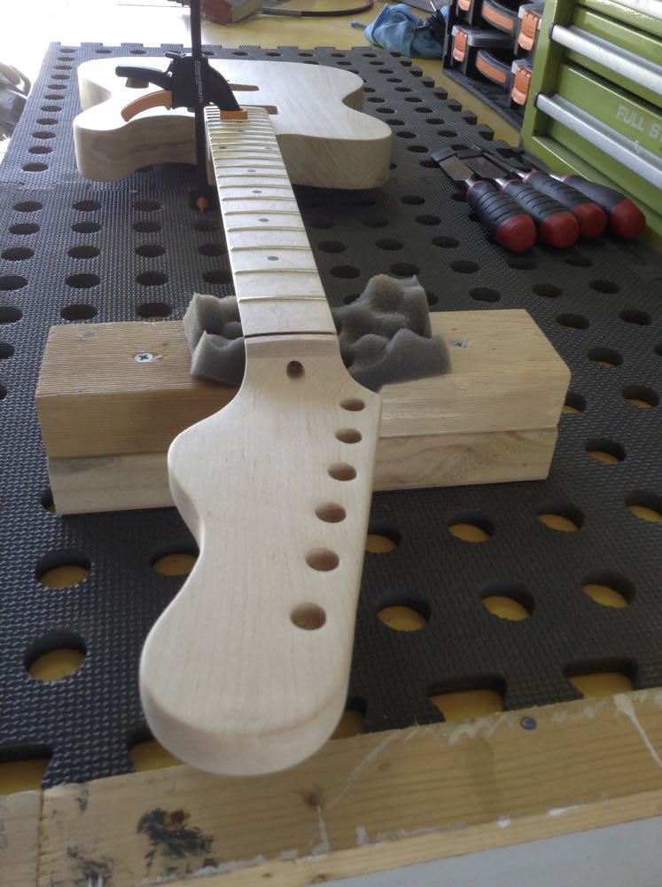

    Took some pictures with neck clamped on and a few bits in place.... Will need to rescale the pictures on the computer before I can post them...
    First impressions....
    Nice grain .... Hoping to go with a light coloured stain and satin finish....
    Glad I opted for the groves tuner upgrade.....
    Kicking myself I didn't order the bone fret nut.....the plastic one looks cheap....
    Tone riders doh......later date I think....

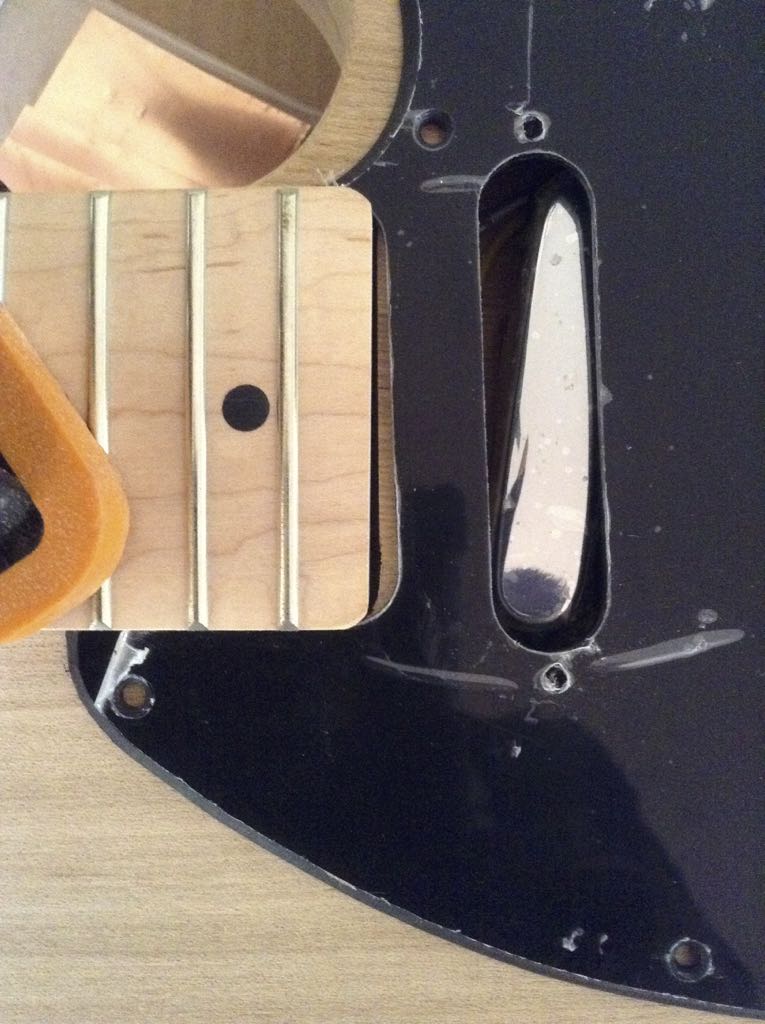

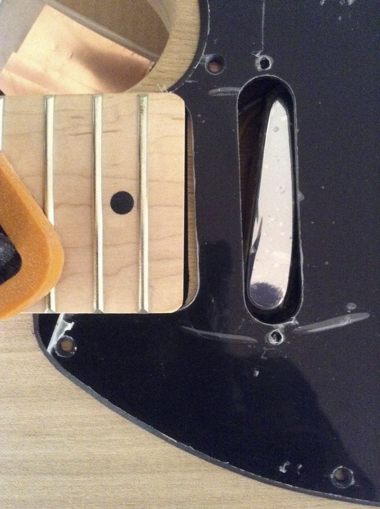

    Pick guard will require so minor adjustments to fit.....
    Wiggle room on the neck....
    Frets will need levelling and profiling....took a straight edge to the neck and has either a curve or frets need a lot of work
    No pre drilled holes for the bridge so may look at a wilkinson unit....
    First Question.....re Mock build....should I be drilling any holes at this stage or simply....make sure everything is there and fits together ish.....

    Hi BSB,
    the mock build is to make sure everything fits together. probably best you drill your bridge holes once the strings are on and you can line up the neck alignment.
    I'd say your neck has has front or back bow out of the box so don't worry about fret levels till the neck is flat.
    bourbon sounds good for the sanding process

    So heres the first three photographs showing the grain....and scratch plate / neck detailing that will be required.

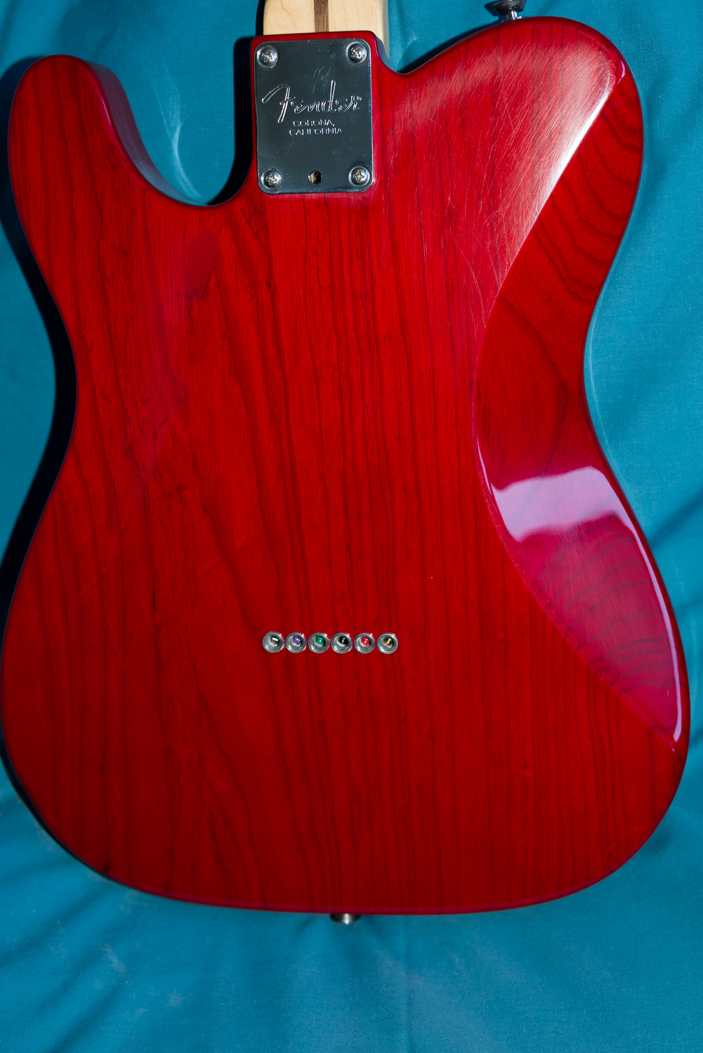

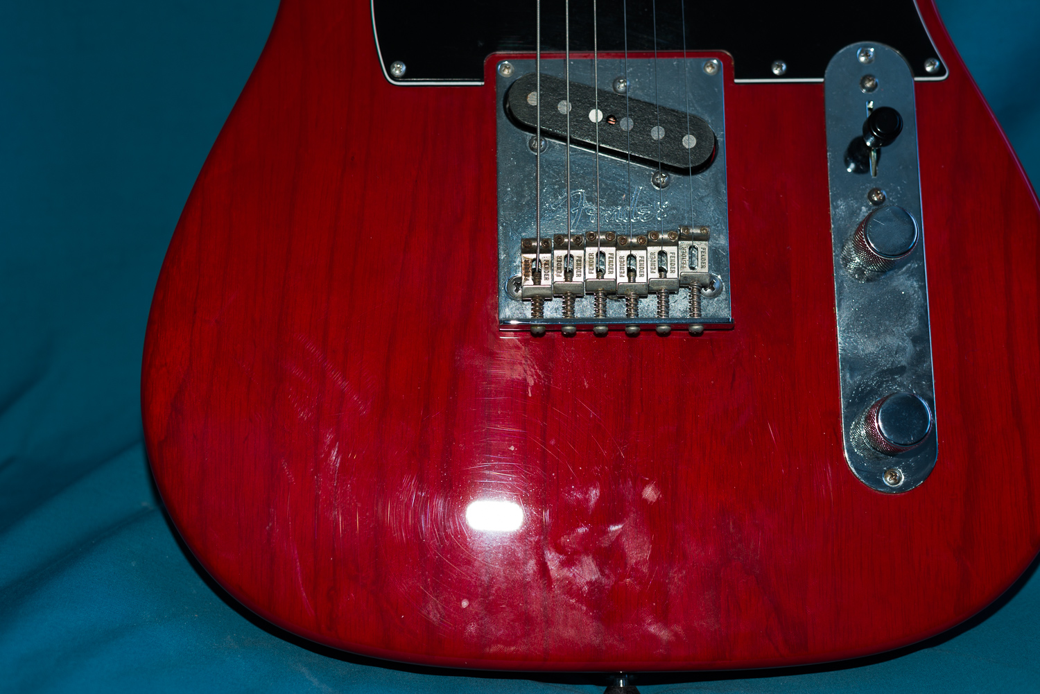

    That seems like a very nice piece of wood [well the front at least] it would seem a shame to cover it with a solid colour.
    I've got a US Fender Tele that is a transparent crimson.[Pardon the finger marks all over it ]
ID:	8610Click image for larger version.
    It's got the typical Fender Hi-gloss finish on it, but the grain is still visible beneath it, if it pops enough for you then go gloss, if you want to see more of the grain then, some sort of satin like finish would be better, dingo bone finishes fit that bill.

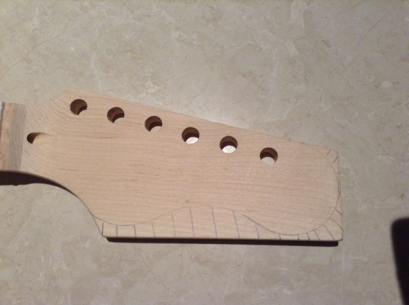

    thanks for the advice Tweaky.....still trying to decide colour for the body.....saw a really really good Green....think it was a dingo tone....and i think i want to do the neck the aged telecaster maple look....can anyone tell me what it is....

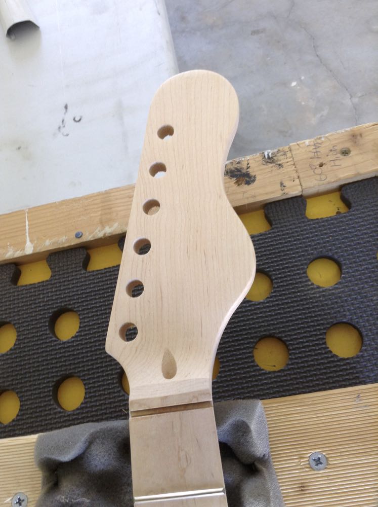

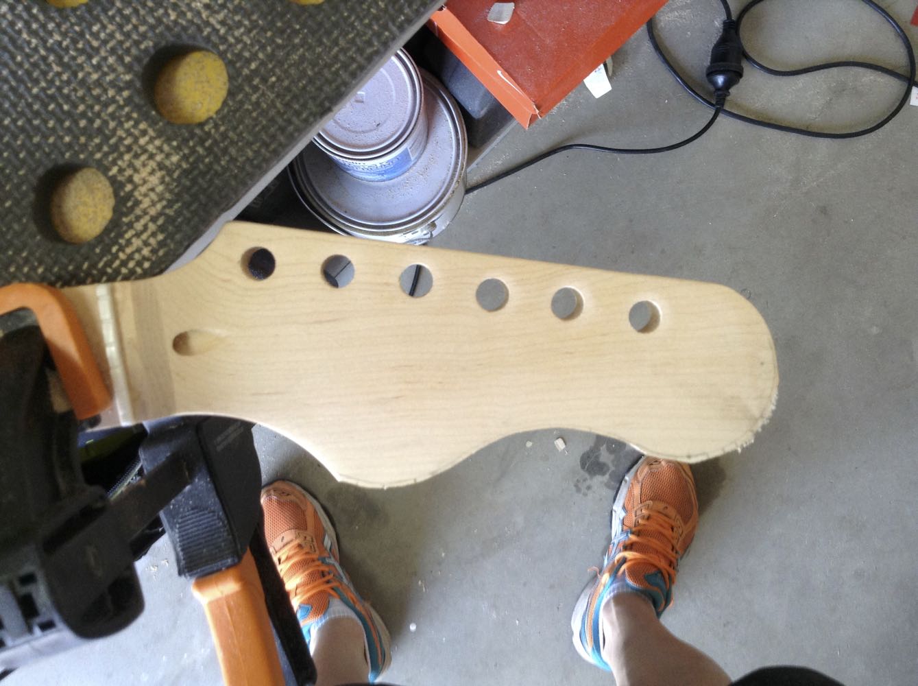

    Anyway here is a few updated photographs.......headstock shaping.....tools used for the shaping.
    Coping saw,
    Dremel Multitool with drum sander attachment.
    Sandpaper started on P100 then 160, 240 so far.....
    So Graphite Nut or Bone.......
