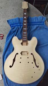

    So I jumped on the DIY closing down sale too and got a 12 string 335 style kit.
    I also got a set of Wilkinson humbuckers from them as they were pretty cheap (no idea if it was really worth it...) and 2x sets of Wilkinsons tuners (same as the pickups I guess...).
    For finish I'm planning to go with a clear natural and I wanted to try Aussie Oil, so I got a bottle too.
    Pretty happy with the kit and the flamed maple top it all seems to get together pretty good:

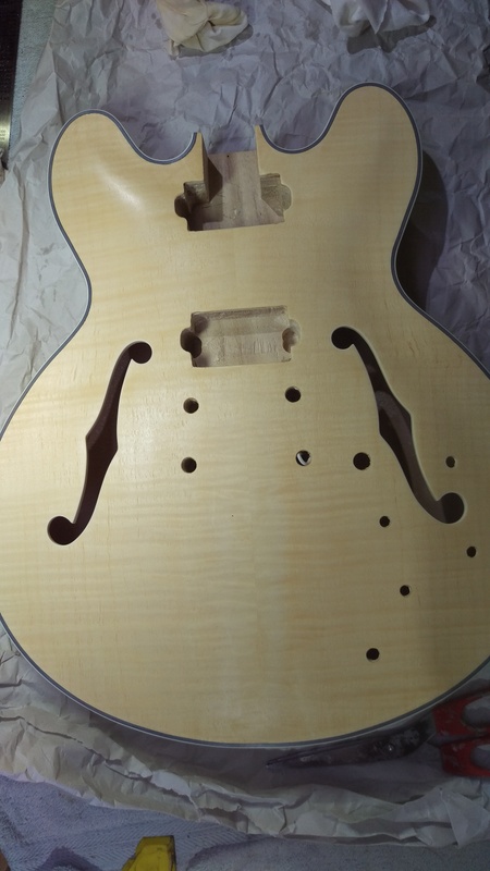

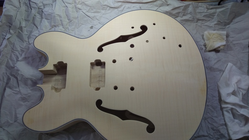

    I've prepared the body, sanded with 180 and 220, and then grain filled with pine colour timbermate as it seemed the be the best colour match:

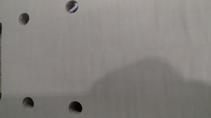

    I then sanded with 220, 320, 400 and finished with 600... and I almost went through the veneer!
    I was mega careful with the edges as I read everywhere on this forum how easy it was to go through, but I started going through on the middle line.
    I stopped just on time and there is only a small area impacted, very hard to see if you don't know where it is (and I won't tell!):

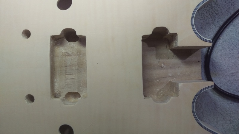

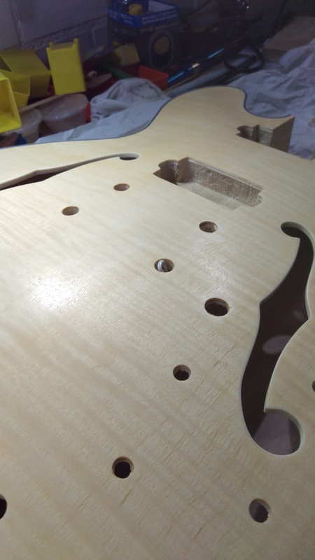

    Anyway, I had to widen the pickup routes a bit as the wilkinson humbucker are a tiny bit bigger than the kit ones and they didn't fit. So I got the dremel out with the routing bit and slowly squared the pickup routings:
    Before:
    And after:

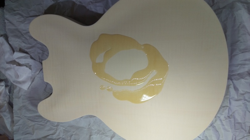

    Then I read 20x times Gavin turner's blog entries on his experience with Aussie Oil and I got started.
    Thanks heaps (again) Gavin for your very detailed blogs, build diary, etc. it's great to see how it progresses and get the explanations/rationale behind everything!

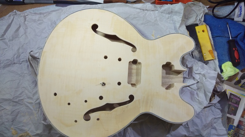

    So I started by a first soak coat for the body, with a generous amount of Aussie Oil on the back of the body:
    I then spread it as evenly as possible with my cloth and buffed it a bit with a clean cloth. I used the soaked cloth for the sides, and then for the front, adding oil as needed to get a nice coverage.
    Pretty happy so far, it's not glossy yet, but the flamed maple looks very nice now. Also it's made the part where I almost sanded through the veneer disappear, so pretty happy with that!

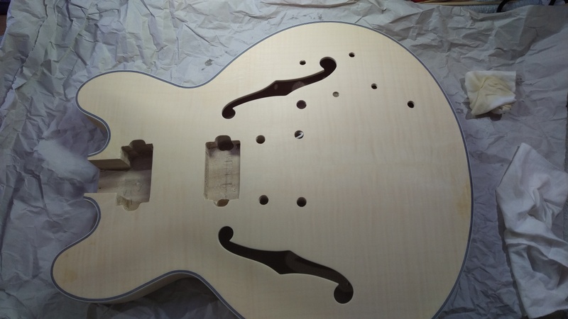

    Before:
    And after:
ID:	8067 Click image for larger version.
    Since then I added a second coat. I used the same quantity of oil for the 2nd coat and that was way too much. I guess the wood was very 'thirsty' for the first coat and will be much less now. I did leave some streaks this time, so I'll have to remove them with 1200 sandpaper or steelwool. But nothing too scary.

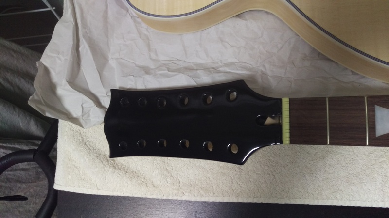

    In parallel I've painted the front of the headstock black:
    I've ordered an inlay sticker, we'll see what it looks like. I'm thinking I'll finish the headstock with clear acrylic once the sticker is on.

    nice start to the build Fred, that aussie oil looks really good after just one coat in the photos.
    If you are okay with working with the neck glued in place and somewhere to hang it, I'd glue the neck early and get a nice neck to body transition

    @Swanny: I don't plan to go darker, I'm happy with the natural look, the flamed maple looks very nice now that it's been oiled.
    The first coat changed the colour of the wood, as if it was wet, but the second coat didn't change it further, it just builds up the thickness to protect it and based on Gavin's experiments should allow to buff it to a gloss finish after.
    @wokkaboy: I actually haven't hung the body at all with the Aussie Oil so far. After about 20-30mins of buffing the oil with the cloth it feels quite hard already. I've been starting by the back of the body and buffing this until dry to touch, then turned it around with the back straight on a protective paper with a towel underneath, and worked on the front. I've not noticed any marks on the back afterwards where the body was resting on the paper. Pretty happy with Aussie Oil so far.
