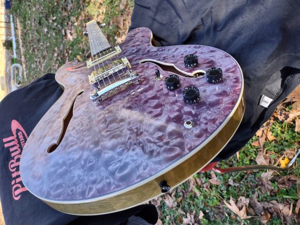

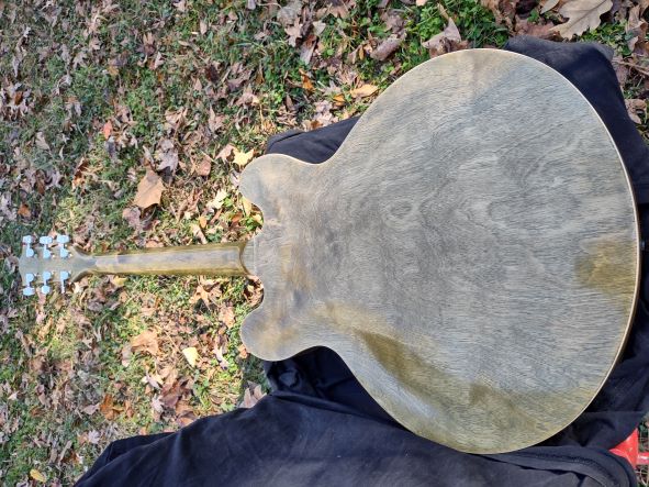

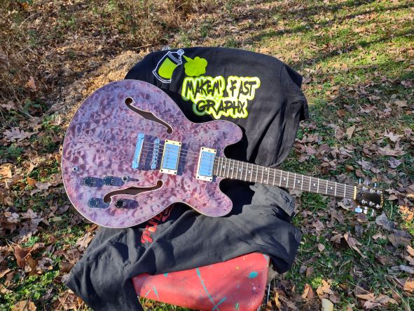

    Bumper March GOTM

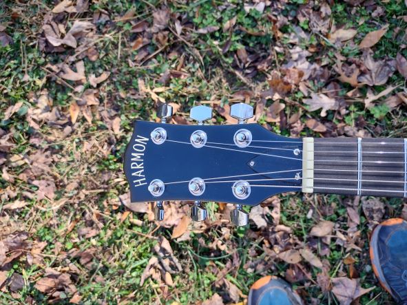

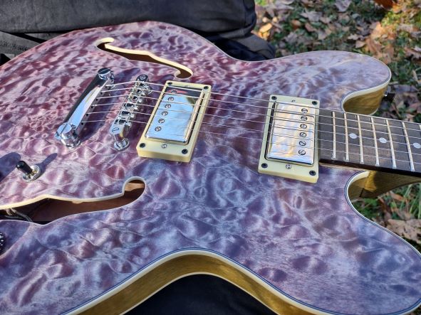

    This is a ES-1Q build I just complete.It's only my second attempt at Nitro Lacquer. I was really surprised at how these colors came together. The stains and Nitro lacquer are from ColorTone. I would've loved to use some Dingo Stains but can't have it sent to the US. The back and side is a special blend of Vintage Amber tinted down with a tad of Tobacco Brown. The front was stained in water and alcohol with 3 different colors (black, cherry red, and blue) to achieve this purple, then sealed and cleared over. She's been wet sanded from 600 to 2000 grit then polished with medium and compounds plus swirl remover and buffed with drill attachment. The head stock decal was made at a local company near home. I always wanted a hollow body guitar and now I finally have one. Hope you enjoy it as much as I have.
    The upgrades are as follows:
    - Seymour Duncan Jazz Neck and JB Bridge Pickups
    - CTS 250K Pots
    - Emerson Paper and Oil Capacitors (.22uf)
    - Steel Braided wiring
    - Switchcraft 3-way switch
    - Bone Nut
    - Custom Gold Left Headstock Decal
    Used from the Kit:
    - Tuners
    - Strings
    - Bridge and Saddle
    - Output Jack
    - Pickup Rings
    - Truss Rod Cover
    - Cavity Covers and Treble/Rhythm Plate

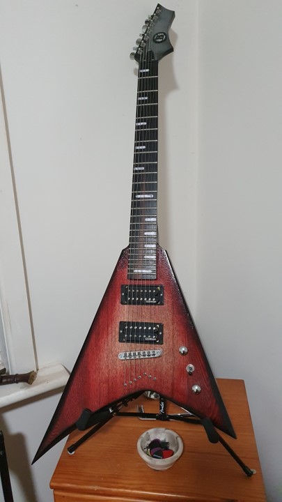

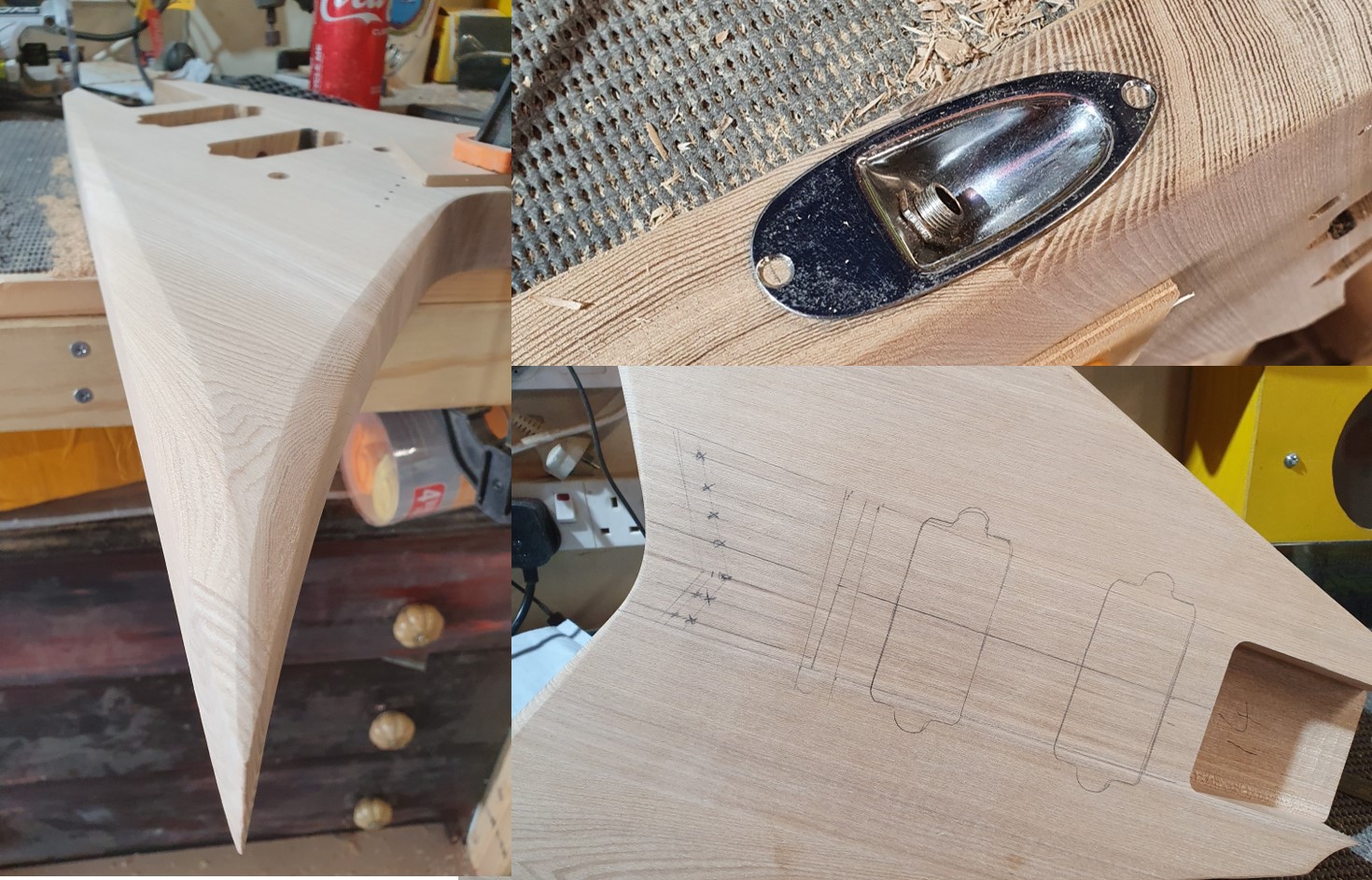

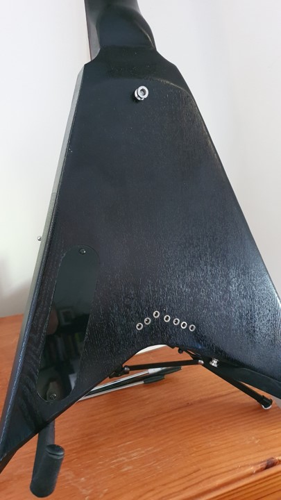

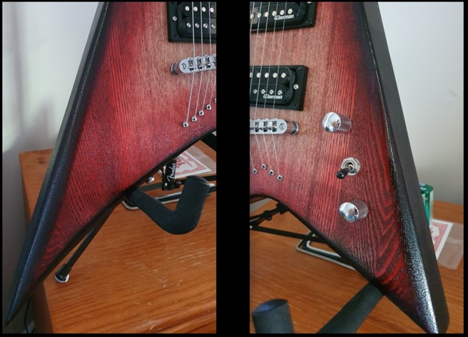

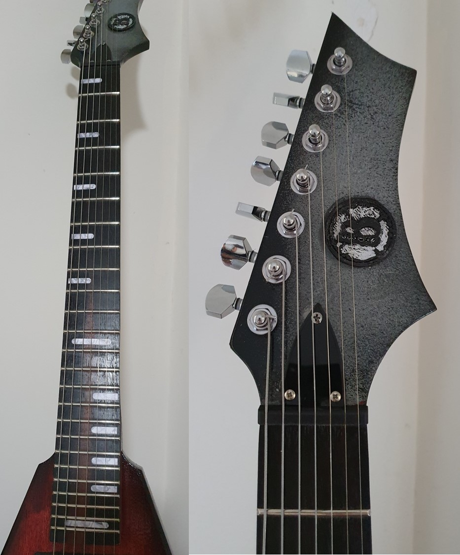

    Here is my newest guitar
    JK-7 Kit (7-String V) - Custom Special
    This is a 7 string, set neck and has a 27" scale with 24 frets.
    The nut has been upgraded to graphtech.
    I have reshaped the body and carved the integrated neck.
    This kit was a blank canvas so all the routing and bridge placement was done by me.
    The finish is Crimson stunning stains and duramax top coat.
    The black base is a spirit stain and the red is water based.
    Pickups are pair of matched HOT overwound Deadly Sinners from the UK by Warman.
    Wiring is fairly standard with a 3 way toggle push/pull volume and a tone pot.
    I retained the bridge but replaced the stock tail piece with string through ferrules.
    Fret markers are from Fretlook in Germany.

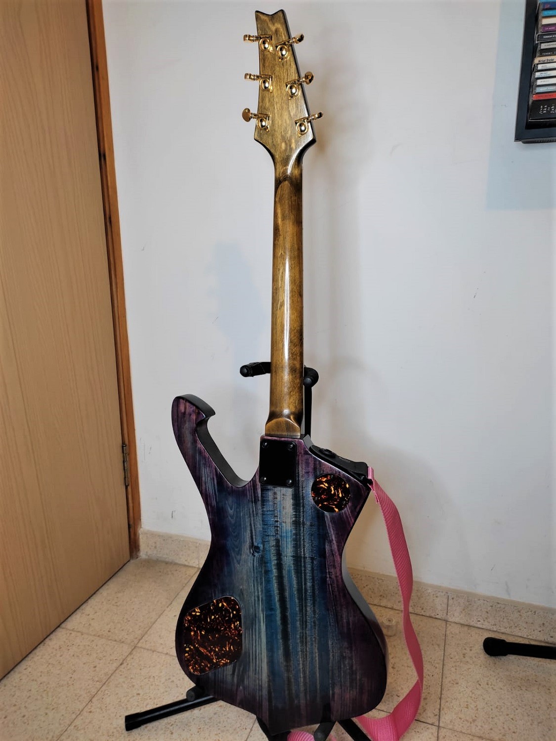

    Bumper March GOTM

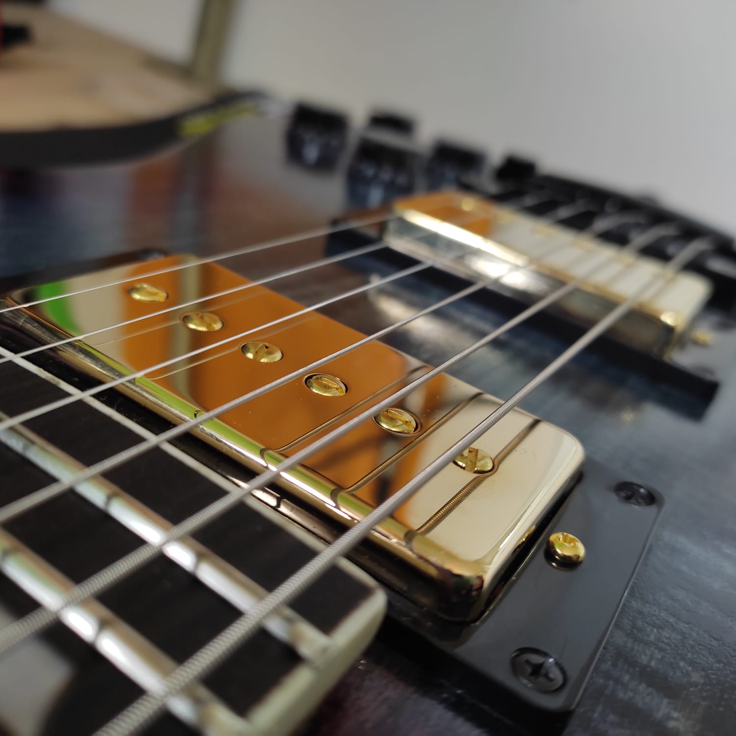

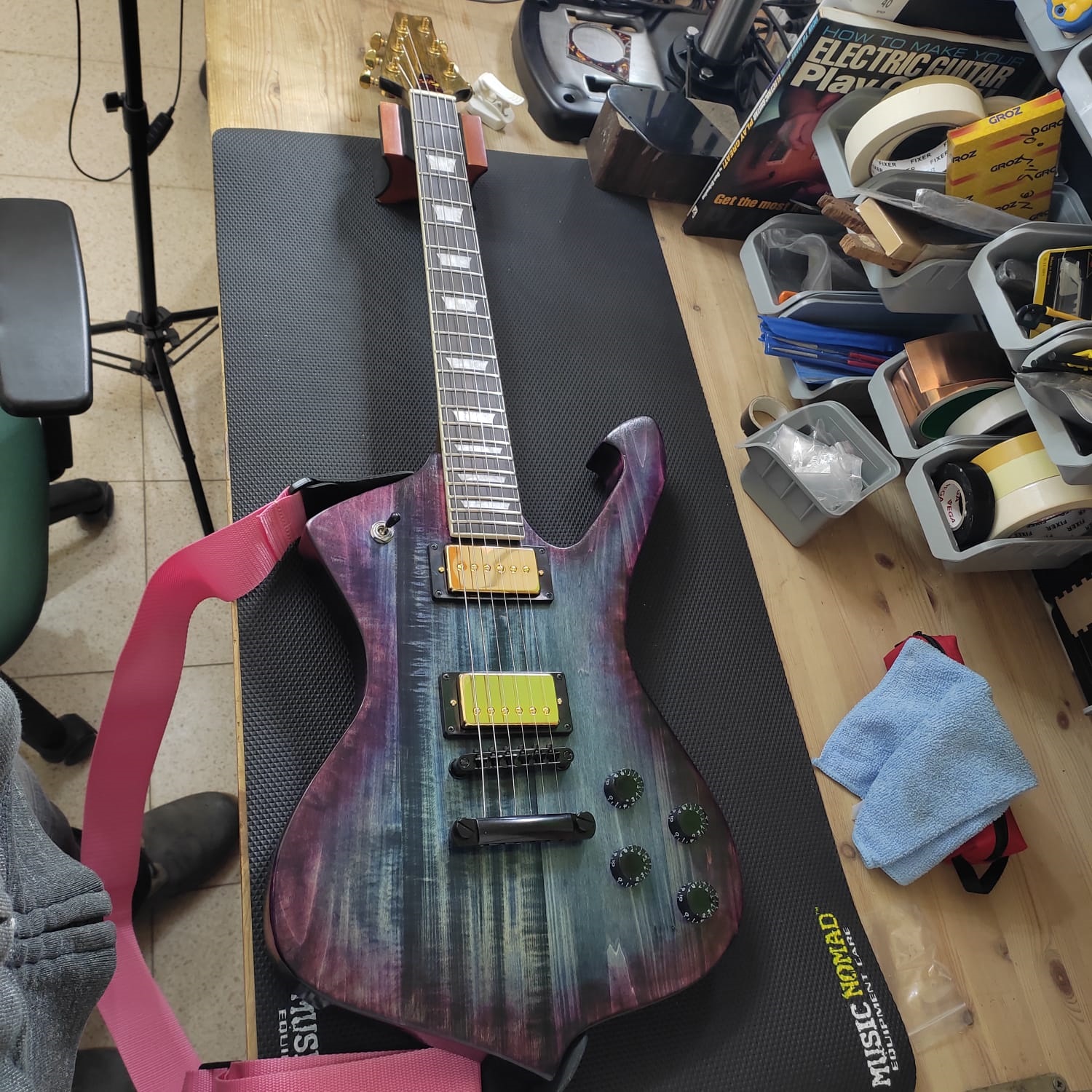

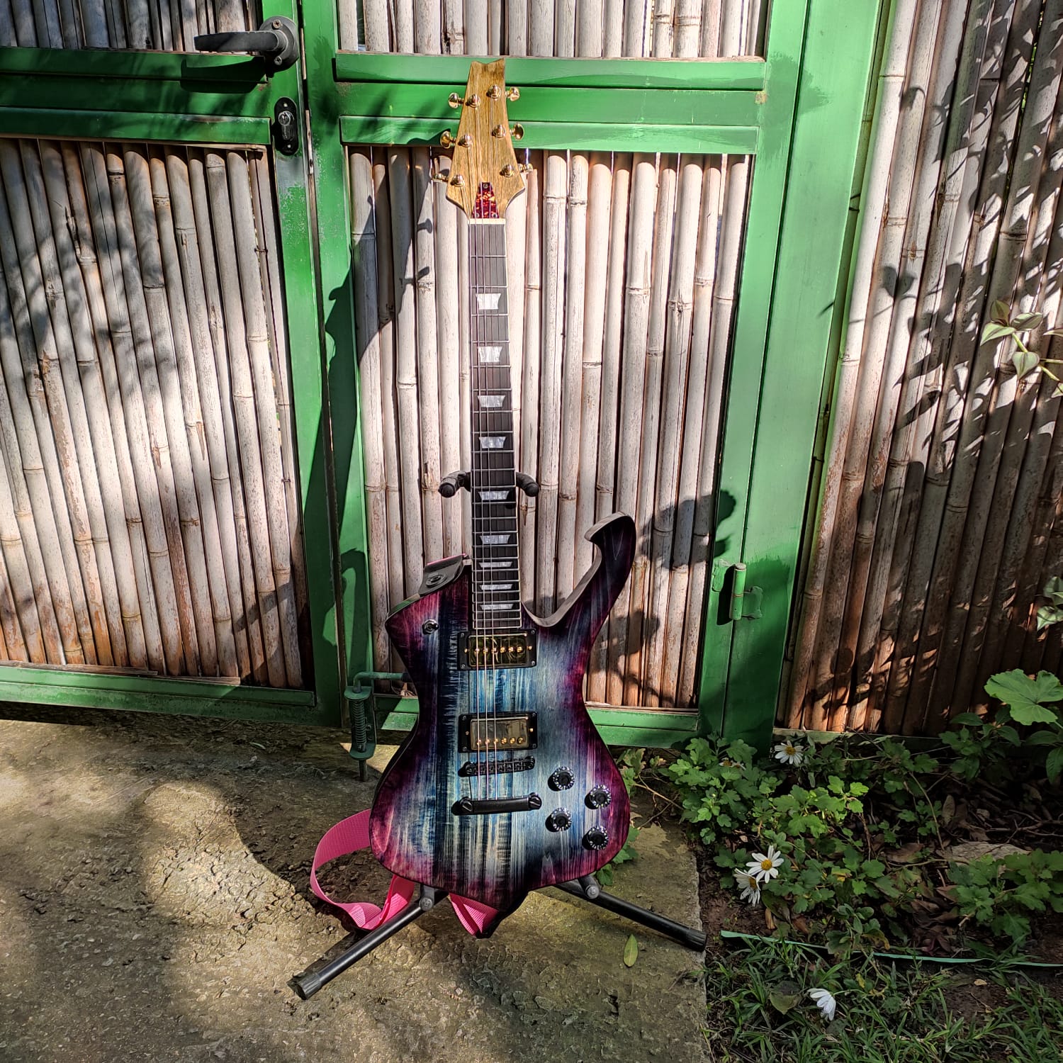

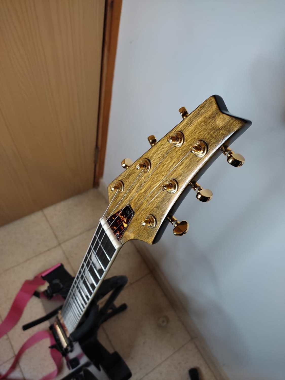

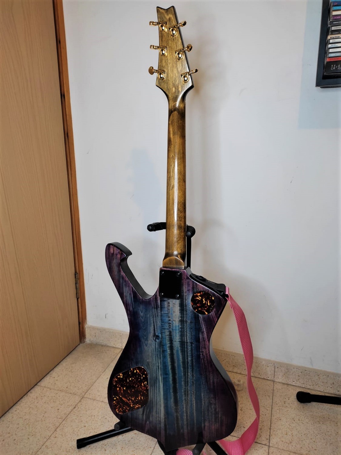

    This is a IC-1 kit
    I used Keda dye, for the first coats of oil I used Crimson Guitars Penetrating Guitar Finishing Oil, and for the rest I used Tru oil, 22 coats in total.
    mods:
    Tonerider pickups
    Grover tuners
    I also made a bone nut, the cavity covers and the truss cover instead of the black ones that came with the kit.

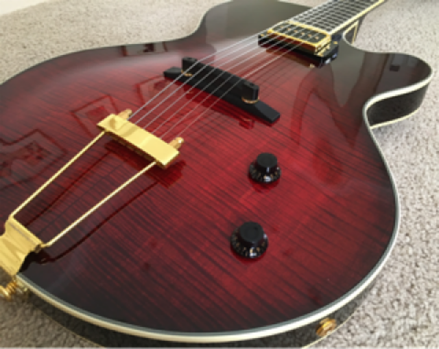

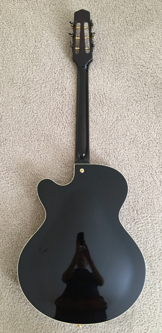

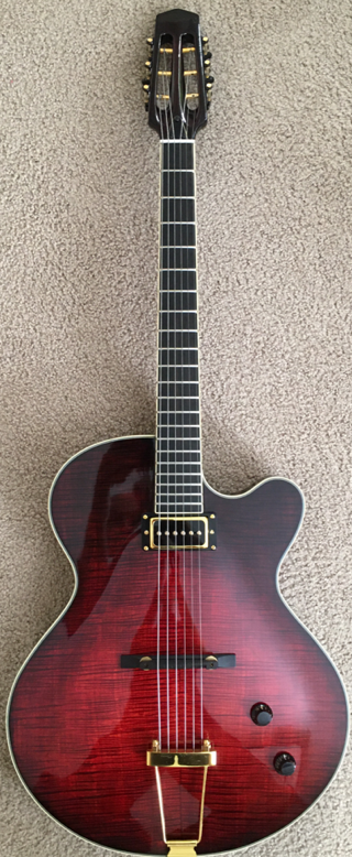

    AES-1 Modified
    I wasn’t going to enter but these folk need a competition.
    Here’s my ‘Special’s’ buy on an unwanted custom kit.
    I made some modifications to the headstock.
    More photos to follow.

    The intimate side.

    Up close and personal.

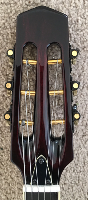

    Headstock. (I know judges…no decal &#128521.

    Gotta be pretty happy with that!
    It looks great DM
