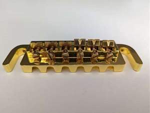

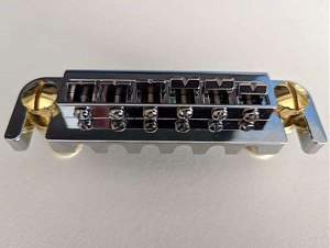

    Re the bridge, I am trying to work out out to remove the saddles and saddle screws. Below is a picture of the chrome one with the gold pins. How do I get the screws out so I can remove the saddles?

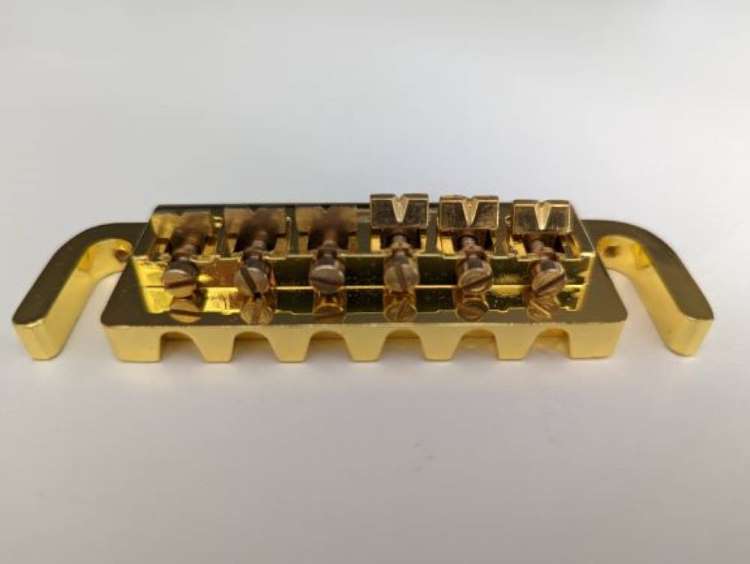

    The gold version of the bridge has a different type of screw and an openingfor it to slot into:

    Also can you show a photo of the screws you’re trying to remove from the bridge?
    Yes, I'm unfamiliar with how the kit wrap-arounds are assembled, and there are different ways that intonation screws are terminated within the bridge. Some have wee tiny nuts, some C clips, or other types of retainer. A pic of the end of the intonation screws should tell us.

    Just to reiterate my pervious post, a photo of the "back side" of the chrome bridge should show more on what is required to remove the saddles. The gold one, the intonation screws will just prise out once the saddle moved to about the middle of travel. There's no retainer wire like on some traditional TOM's.
    The intonation screw threads are hopefully the same. (commonly M2.5 from memory*)
    *Edit: for import/metric bridges - M2.5 with a thread pitch of .45mm

    The back is totally sealed - no access to the screws.
    I'll have a go at the gold one, as you suggested, to see if I can getthe saddles out of that
