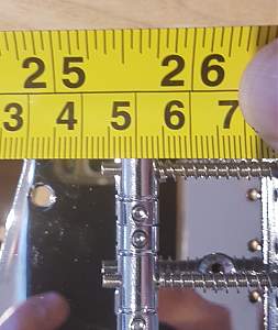

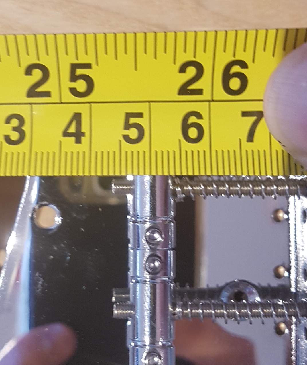

    Measurement of top E from inside of nut.
    This is using the re-drilled holes for the bridge but if I use those it's clear that some routing of the cavity is required in order to fit the pickup.
    Am I on the right track by sticking with the pre-drilled holes and dealing with the pick up problem by some minor (ie about a mm or two) routing?
    Thanks in anticipation
    That looks good to me as you have enough thread left on the intonation screw to get the saddle within the margin. FWIW, the treble E strings on my guitars can intonate between 647-651mm. Some are bang-on 648. There aren't always hard and fast numbers with these things. As Simon detailed above, there are lots of variables.
    Now, one thing I will say re: using a tape measure vs a steel rule is that the metal cleat on the starting end of a tape measure can have some play in it and vary the measurement depending on whether you're pulling or pushing the tape.
    If you do not have a long enough steel rule yet (or can't get one) you can "calibrate" the tape measure by checking it against your 600mm rule. By determining the variable between the pull/push measurements, you can account for it in your scale length measurement. I know that all sounds a bit dodgy, and ultimately a 100cm rule is a better option, but sometimes we have to improvise.
    I have a Stanley tape measure that is spot-on in both directions, so sometimes it's not an issue, but I still use a steel rule for critical set-out measurements.
    That should be fine, but check that there is enough length in the bridge plate that it will cover the extended routing. You can position the bridge using the pre-drilled holes and scribe a line with a fine pencil at the neck end of the bridge. The line will show you how much wiggle room you've got from the edge of the pickup cavity.
