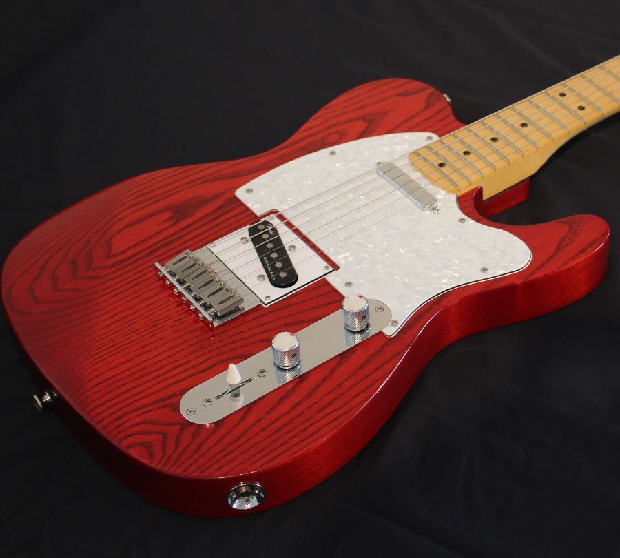

    I used a ebony grain filler on the tele to contrast the grain more.
    This is a gloss poly, but you get the idea:

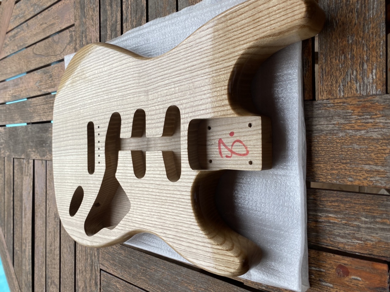

    I’m 6 very thin coats in and it’s starting to look pretty good. It goes on much thinner than Tru Oil and is very even but will take a lot more coats to build up a really deep gloss shine.
    I need to work out how to post photos on here!

    I’ll take a better photo tomorrow when the oil has hardened.
    Looking good Chris!
    I think I can see a reflection of you taking the photo. If you're getting a that level of gloss after 6 coats, that's very good IMO.
    I don't think I've experienced that quick a build with Tru Oil. (presuming it's not still wet in the photo)

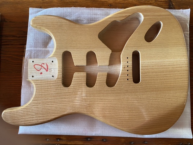

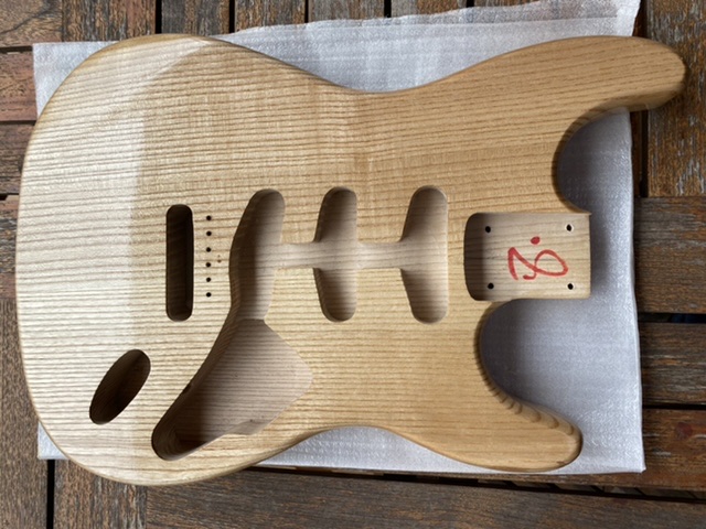

    Seventh coat now dry. I gave the sixth coat it a very gentle rub with 0000 steel wool and it’s starting to achieve the look I’m going for.
    I’m thinking of about 5 more coats.

    Nice. I've seen a few builds recently with no stain, just a clear coat over the natural timber. I have to say it's a look that's growing on me!
