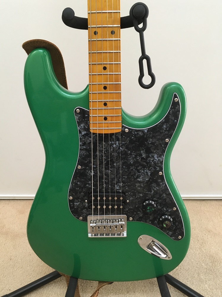

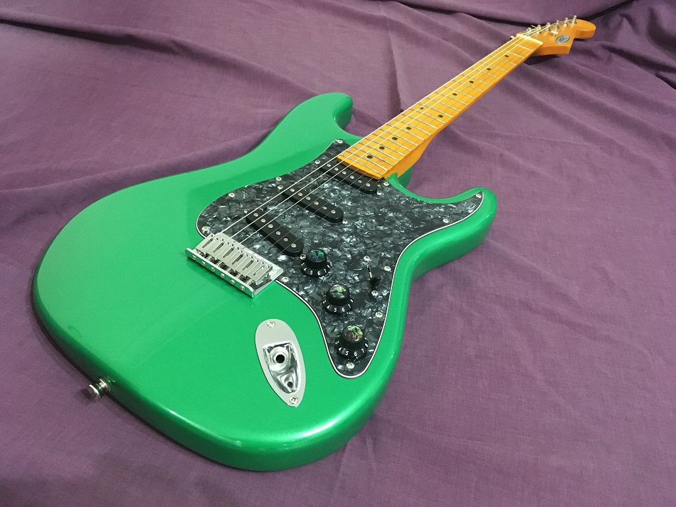

    This is a hardtail strat I built in 2019. (all non-PBG parts)
Name:	Current config.jpg
    It has been through a couple of changes recently. Most significantly a neck refinish.
    It was the last neck I had sprayed with acrylic lacquer, and I just didn't like the feel of it even after a good "de-gloss".
    So I pulled the frets and completely stripped it, re-stained with FW Golden Teak, re-fretted and sprayed with satin poly.
    Satin poly has been my go-to for necks since building this strat.
    Most recently I rewired this (and a couple other ST's) with Leo Fender's PTB (Passive Treble Bass) Circuit. However, I have one more revision planned. I've ordered a single humbucker pickguard (also black pearloid) and a Tonerider Alnico II F-spaced bridge humbucker.
    I am generally not a humbucker guy, particularly neck HB's, but I do like the sound of a bridge HB. So not having a "one pickup guitar" (and having multiple 3-pickup strats) I'm going to convert the Green Machine into one.
    The pickguard I've ordered has a single control hole for volume, but I will be adding a tone control as well. I just like the idea of having it there rather than not.
    It's obviously a slow news day, as I'm posting this mostly just for something to do while having a coffee... (and it's raining!)

    Part of the genius of the strat is that they are almost infinitely configurable and reconfigurable. The colors are great on that guitar. Will the new pickguard be the same black pearloid?
    Yes, different retailer and manufacturer, so will a variation of black pearl.
