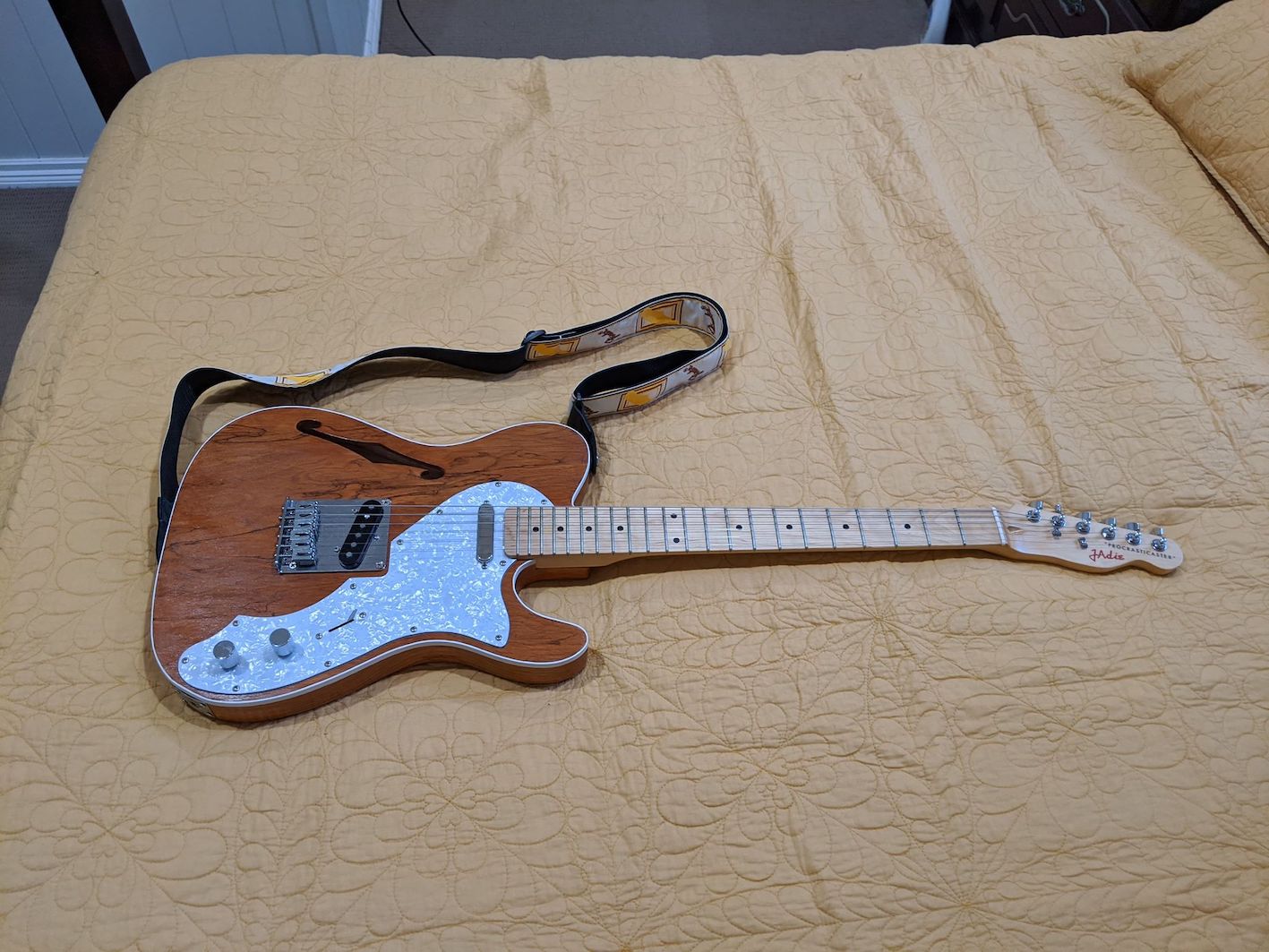

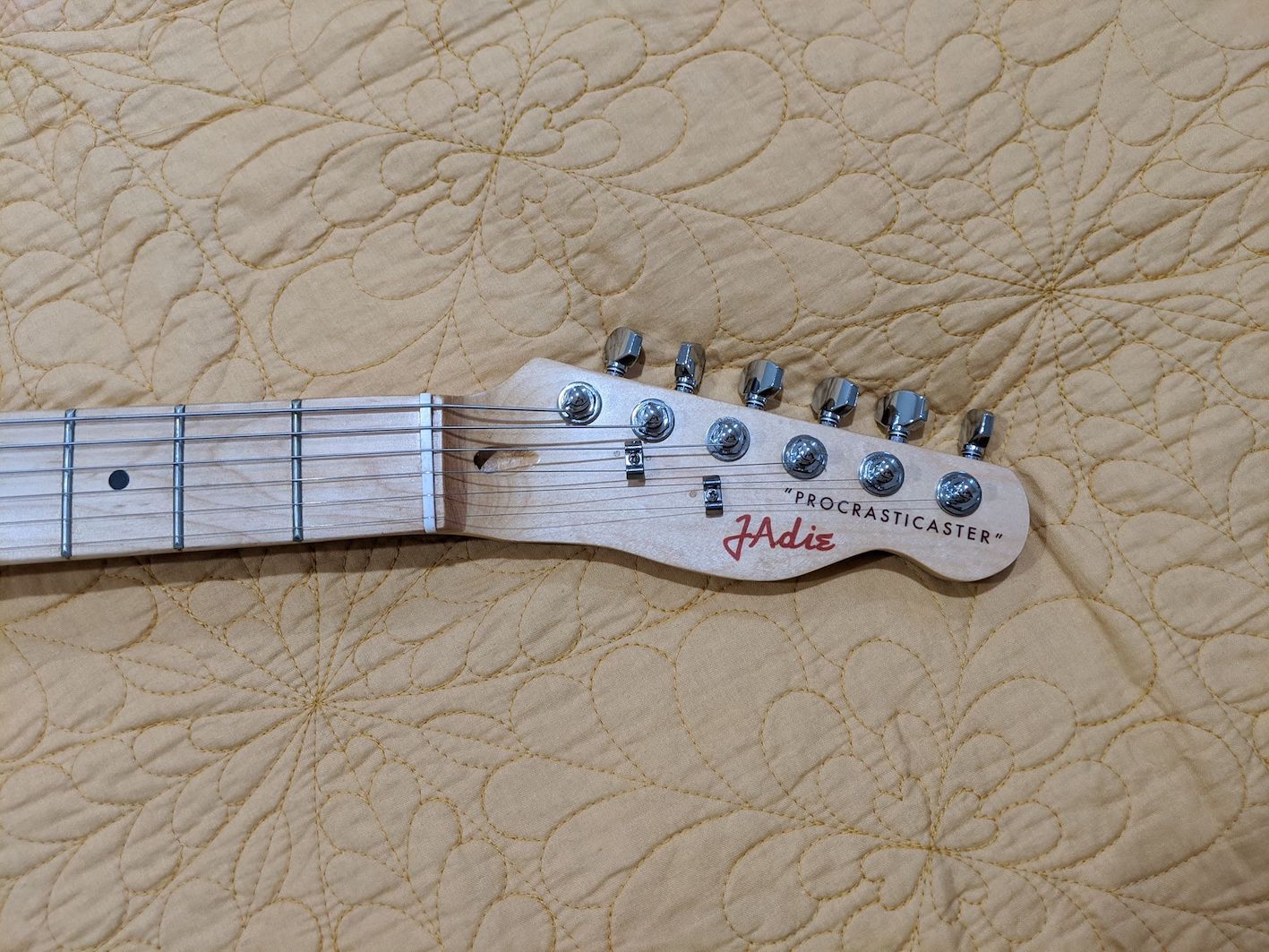

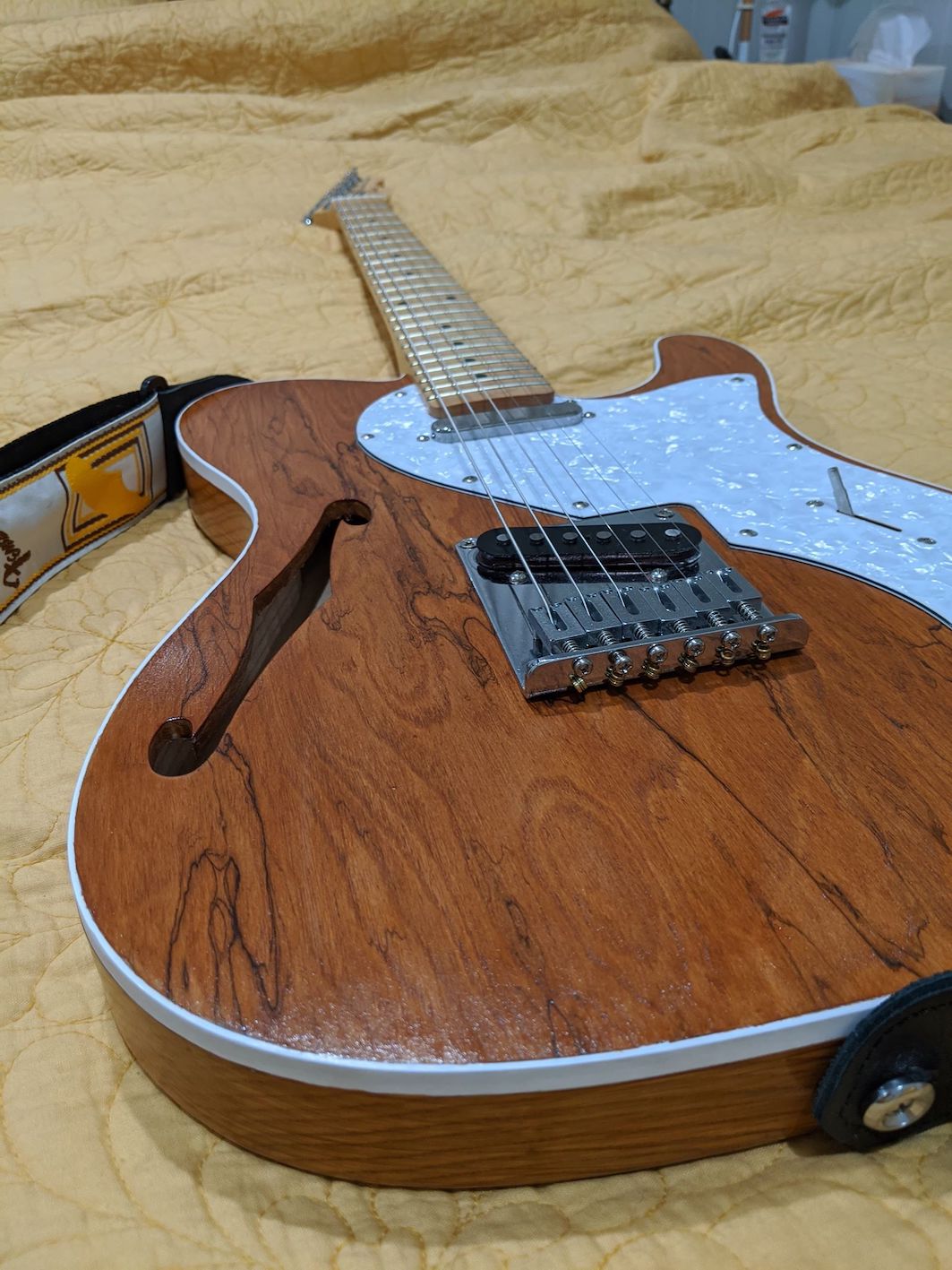

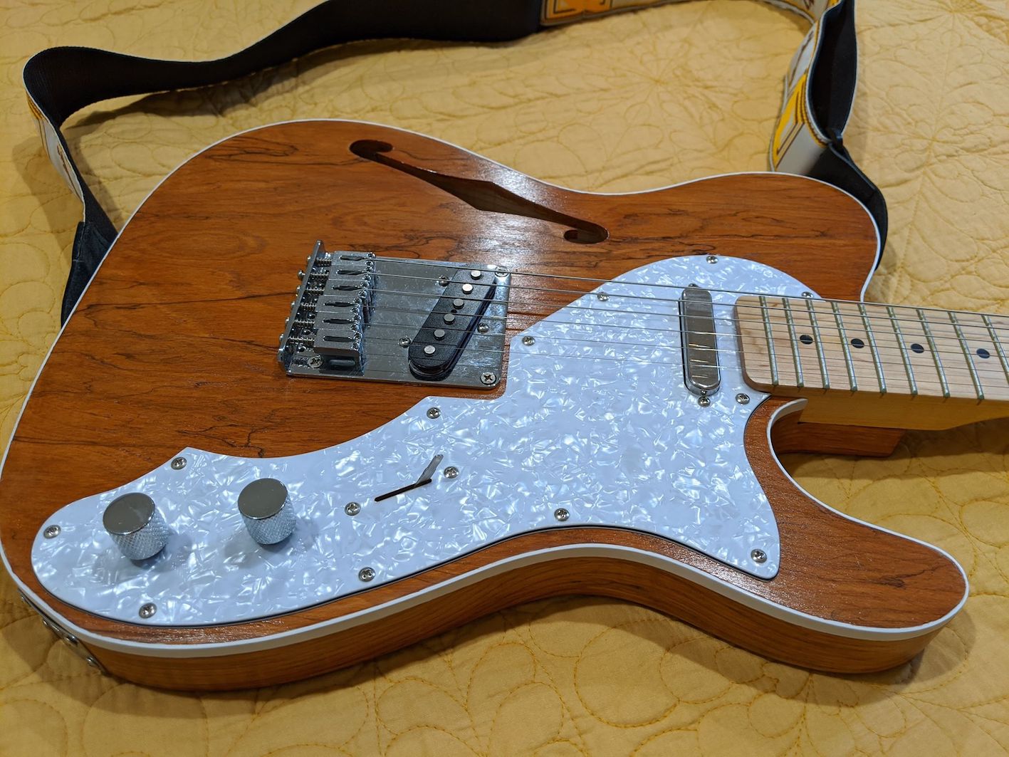

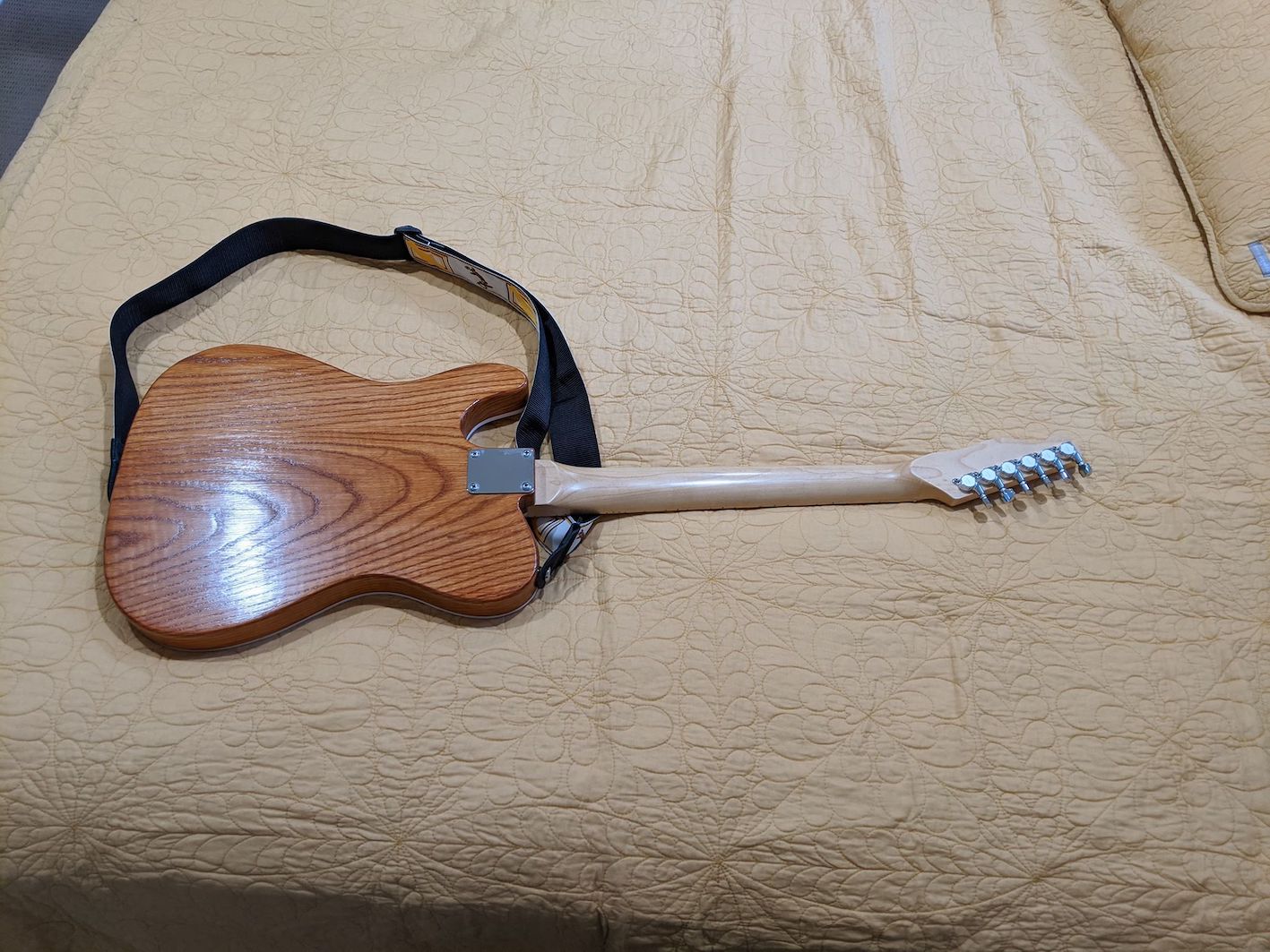

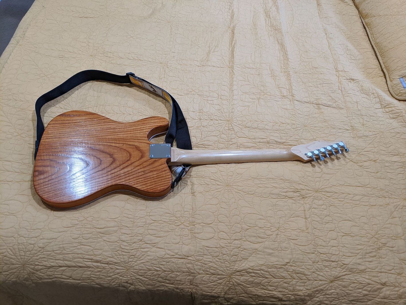

    I nearly finished this in April/May, but thanks to COVID the pickups took forever to get here! Finally done at the start of July.
    The Procrasticastor: https://www.buildyourownguitar.com.a...t=10290&page=3
    - ATL-1SW kit
    - Upgraded to Gotoh SG381 Tuners
    - Upgraded to Gotoh S21 Solid Steel Saddles
    - Cabot's Jarrah Satin stain & Varnish on the body
    - Danish oil & Cabothane poly on the neck.
    - Pickups: Wilde (Bill Lawrence) Alnico Microcoils. Stunning pickups, extremely pure even when you crank it, and practically silent to boot!

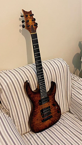

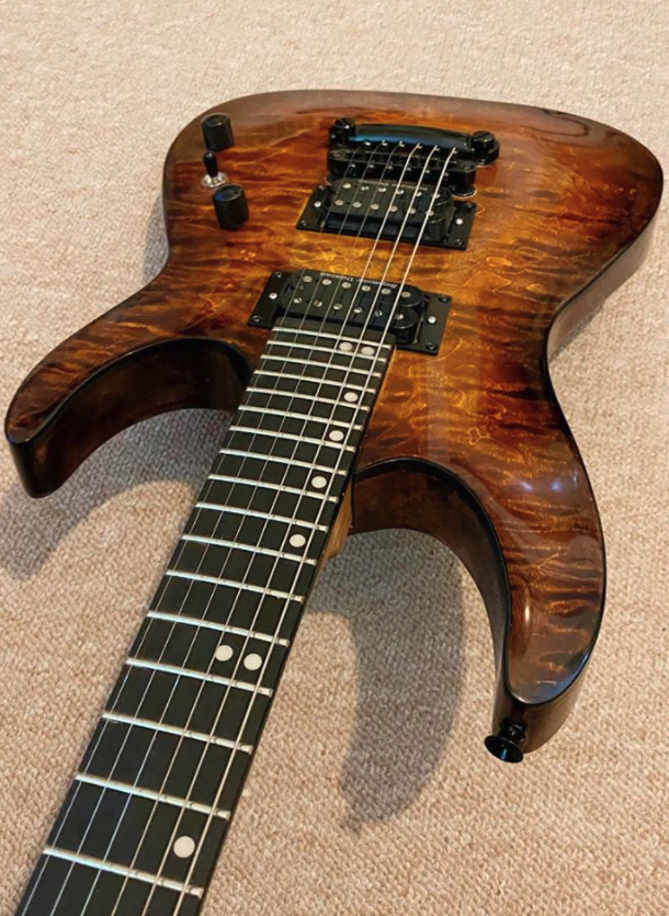

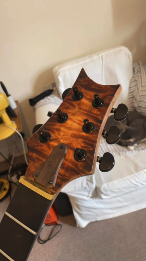

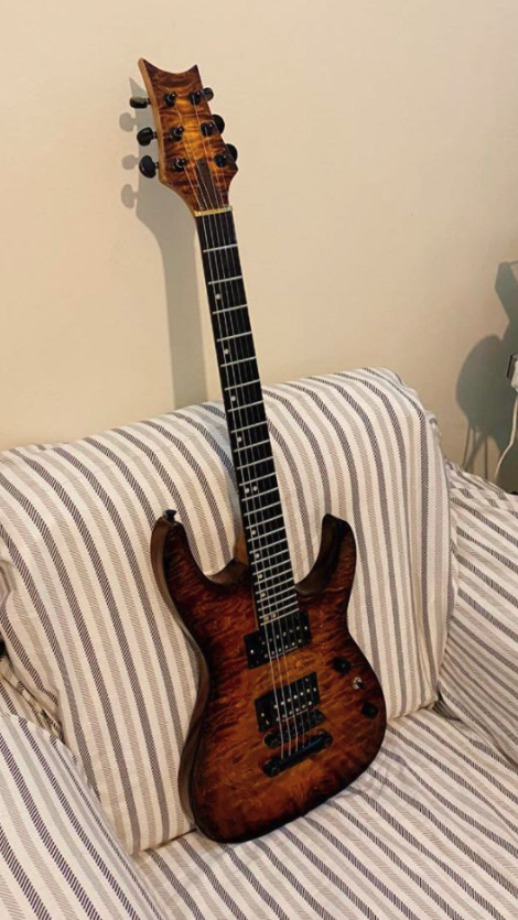

    My GS2Q kit, ordered without hw and electronics.
    - Gotoh GE103-BT bridge
    - Gotoh GE101-A stoptail
    - Kluson locking head tuners
    - Seymour Duncan Sh4 pickups
    - brass nut
    - custom maple control cavity cover attached with magnets.
    Finished with crimsons stunning stains brown, orange, amber, yellow and nitro sealer and clear.

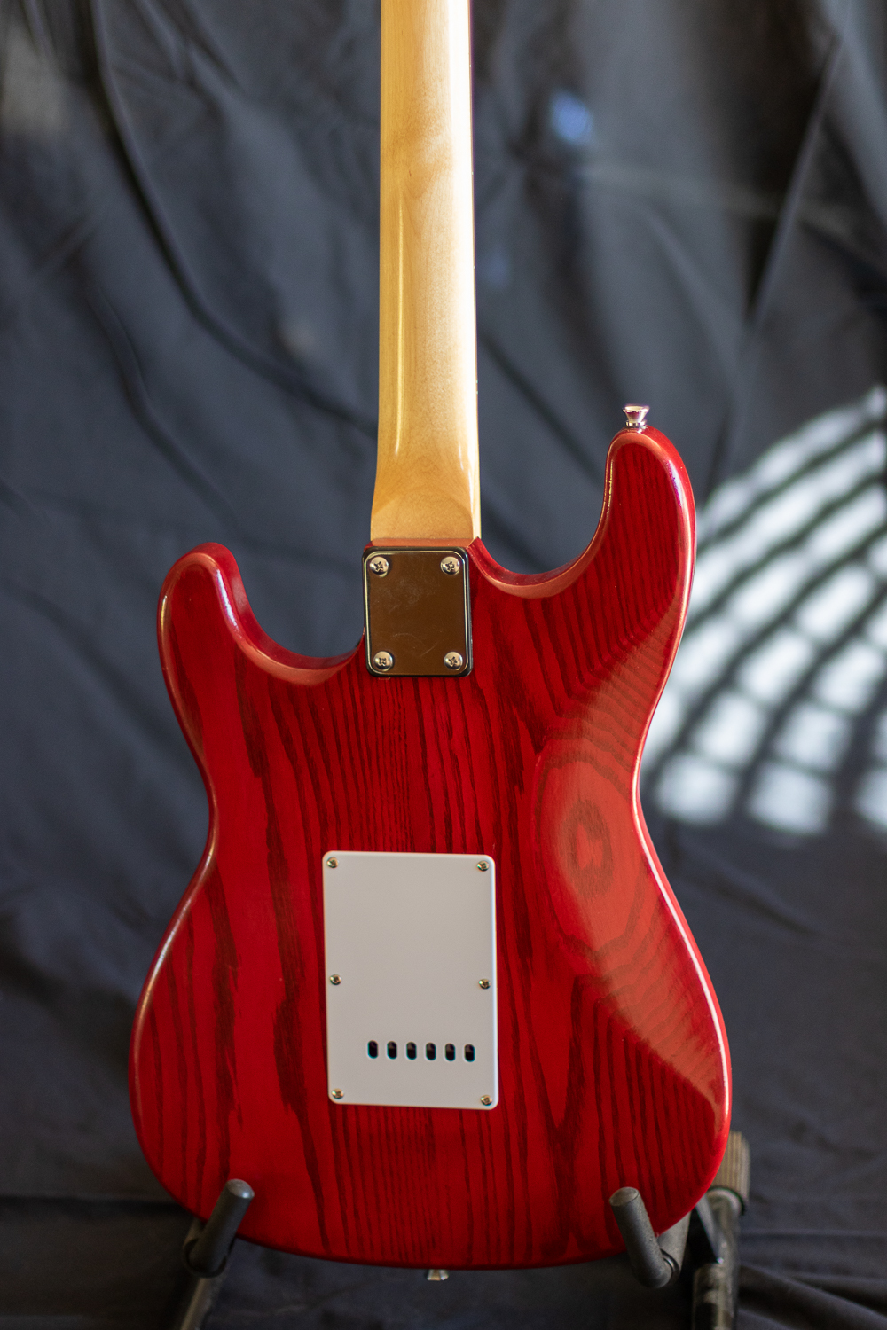

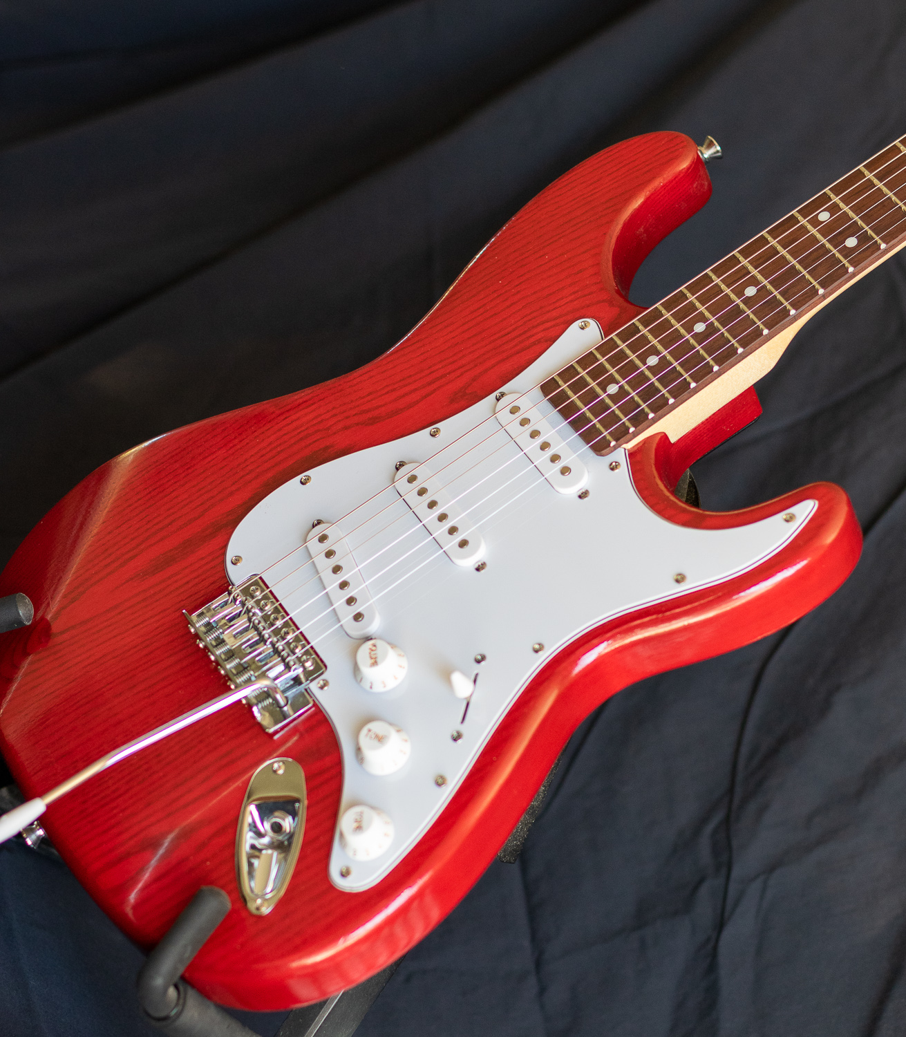

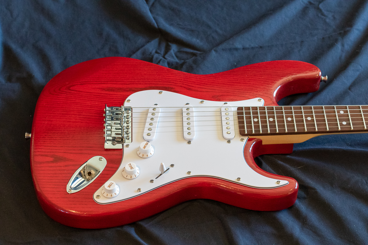

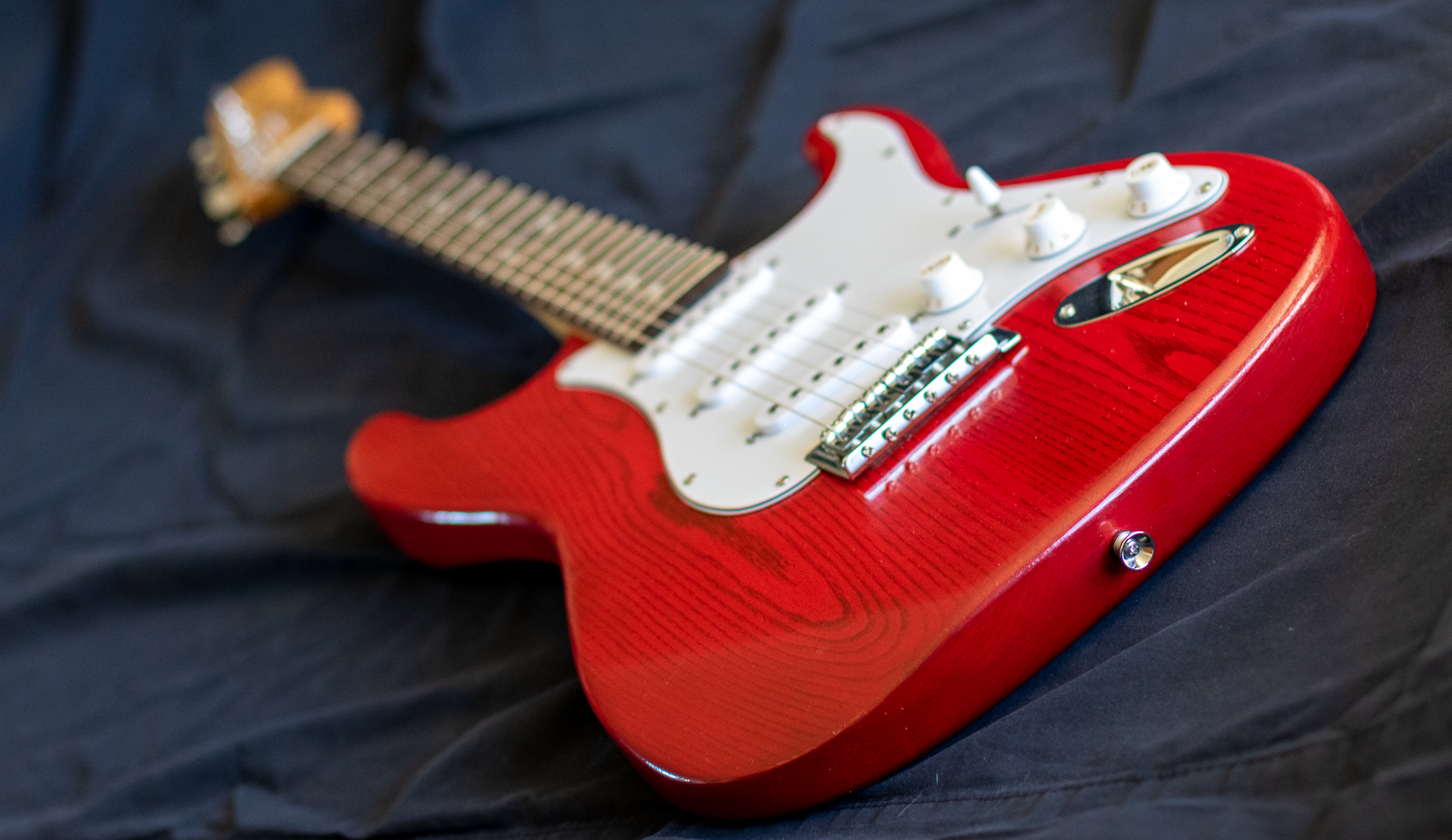

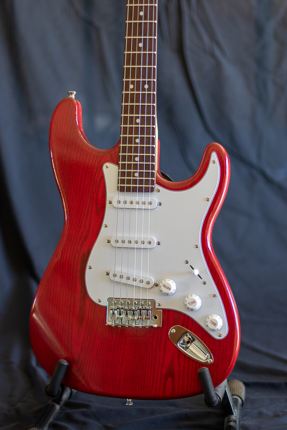

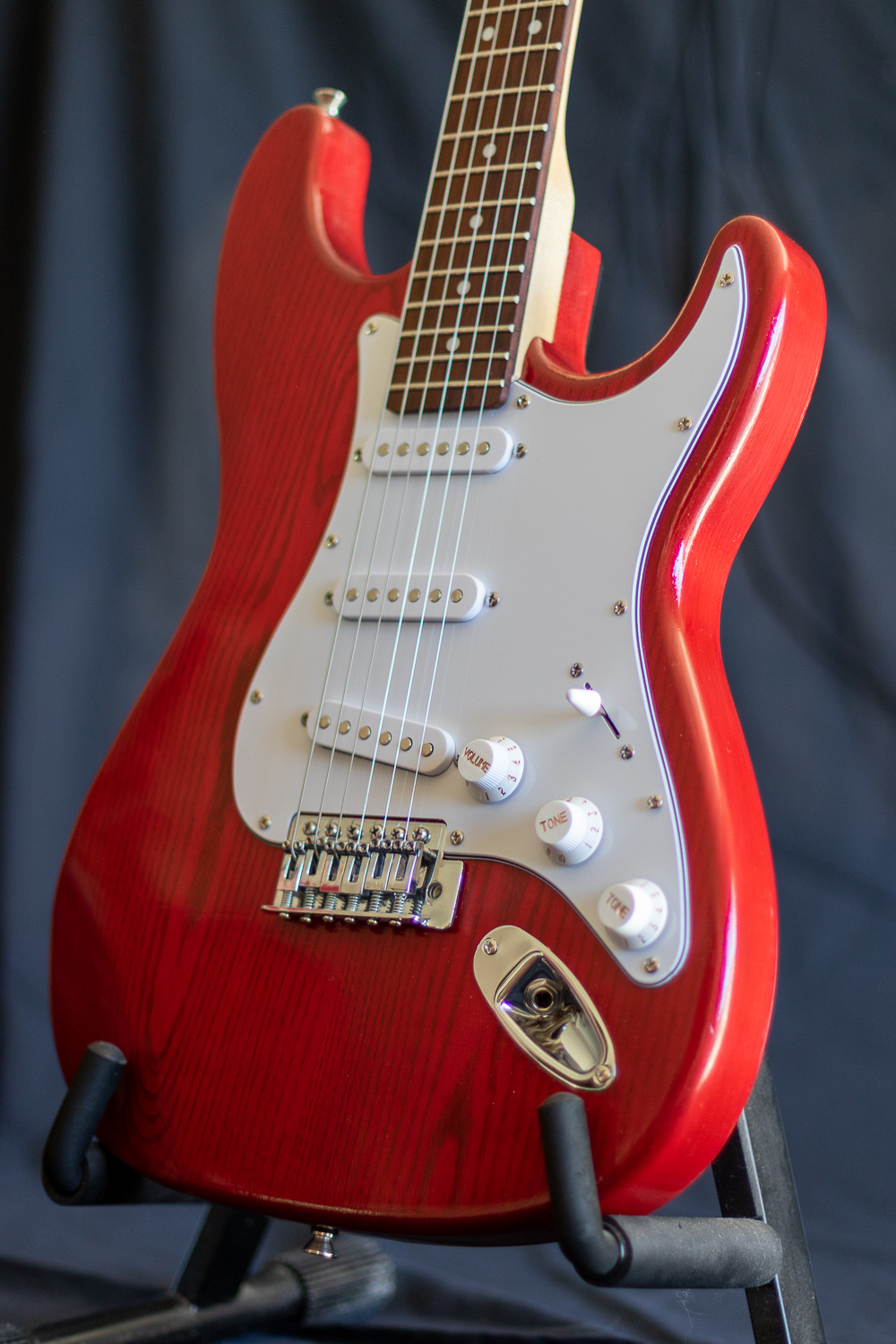

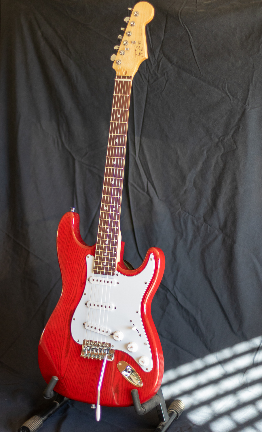

    Finished this just into the start of July. My first kit, this is a GST-1 kit, all stock standard kit parts.
    American Ash body, Maple neck, Jatoba fretboard.
    The finish is one coat of black Rit dye, sanded back, then two coats of a 60/40 mix of Opaque Red hobby paint and Scarlet Red Rit dye. Then about 20 coats of FW Wipe on Poly. Neck was coated with Tru-Oil and fretboard with mineral oil.

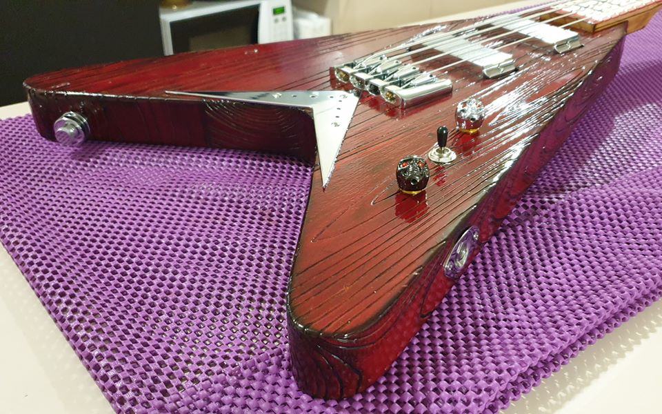

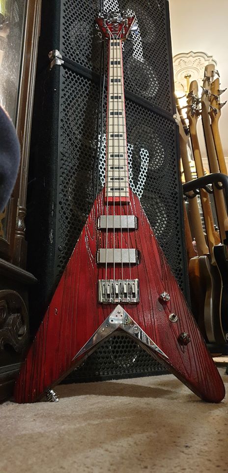

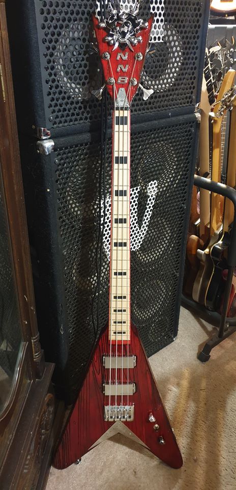

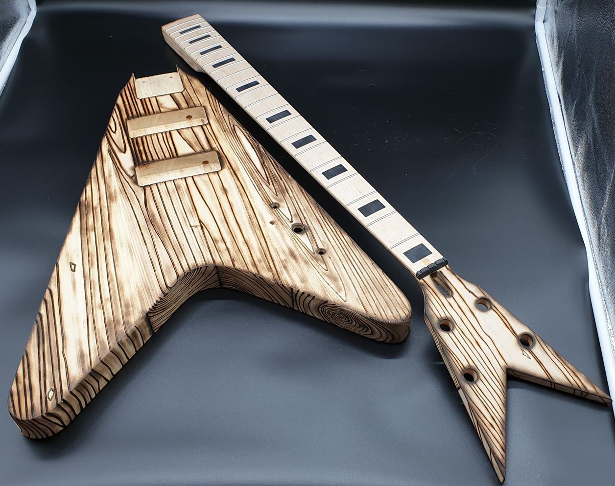

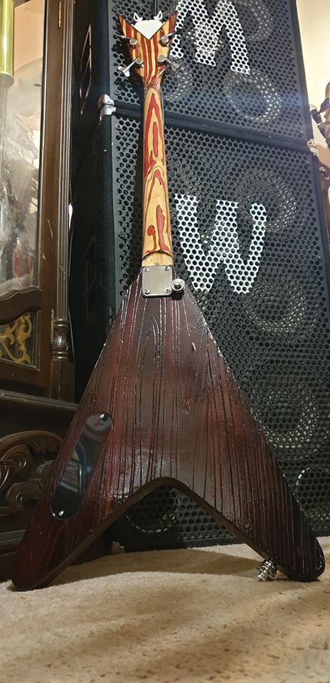

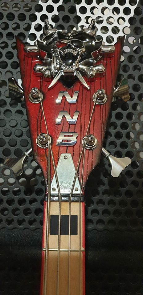

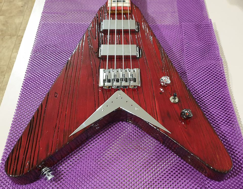

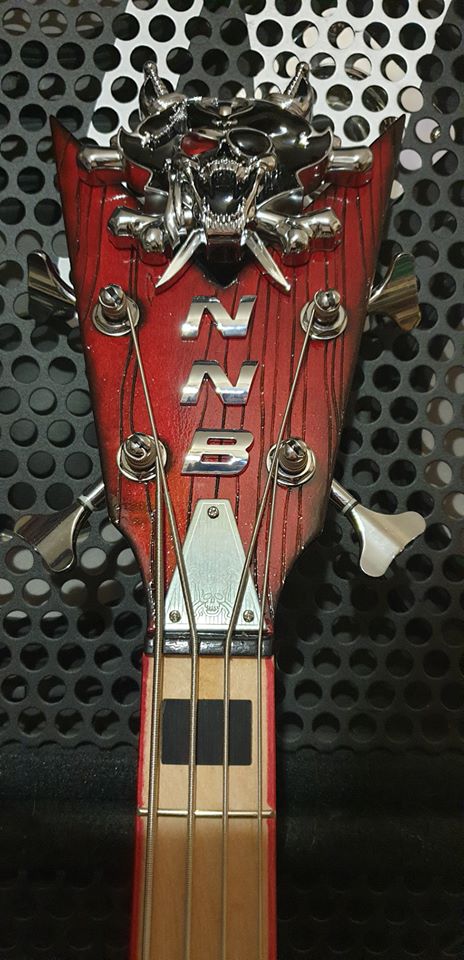

    My FVB-4 Pirate Bass.
    Shou Sugi Banned to preserve the wood and highlight the wood grain then engraved each grain including back of neck.
    Cherry Pie ink stained and on back of neck and with watered down black on top for back of body.
    Body...Scandinavian oiled finished with multiple coats of Tru-Oil with 3000grit light polish in between. Neck...Tru-Oil with 0000 steel wool light polish in between coats and eucalyptus oil for fretboard.
    Swapped neck from a ML Bass Kit.
    Custom chrome pups. A500K pots and .022 cap.

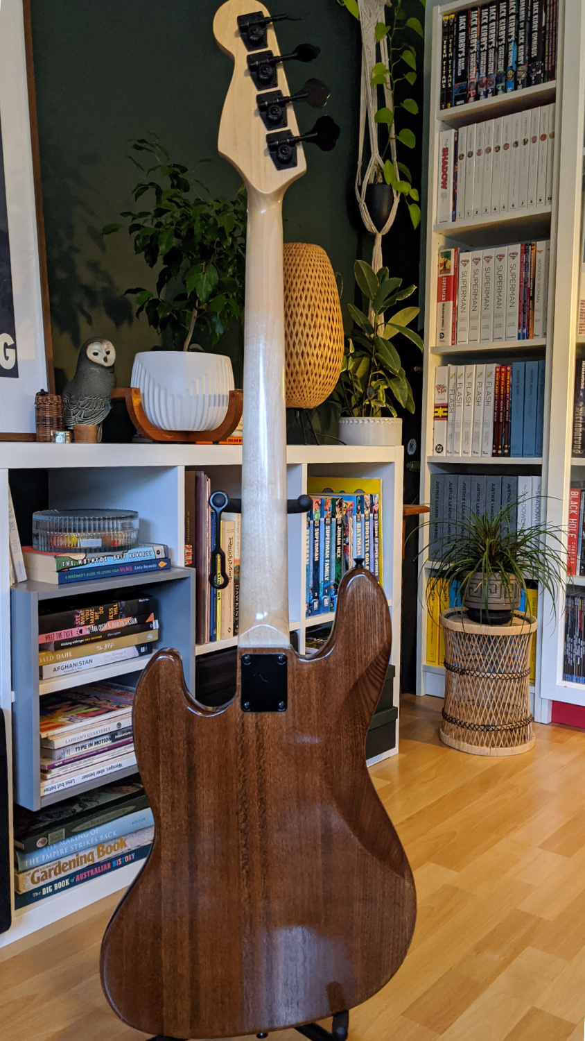

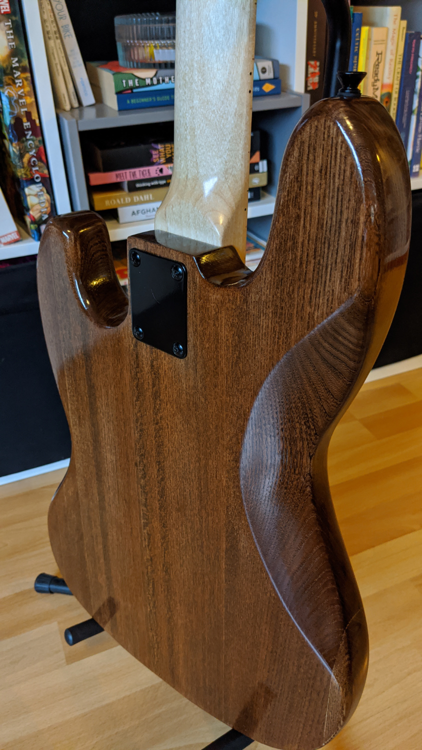

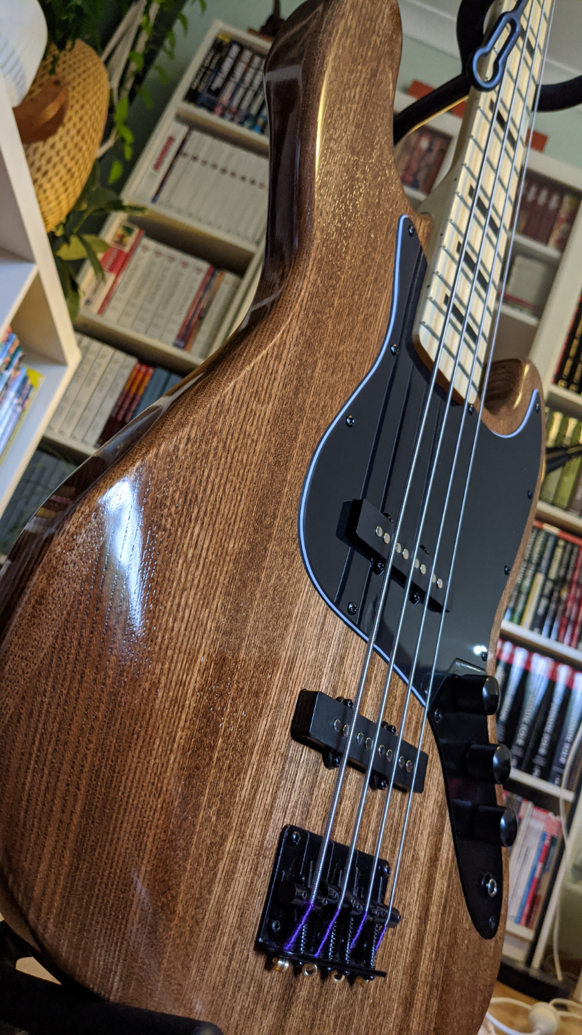

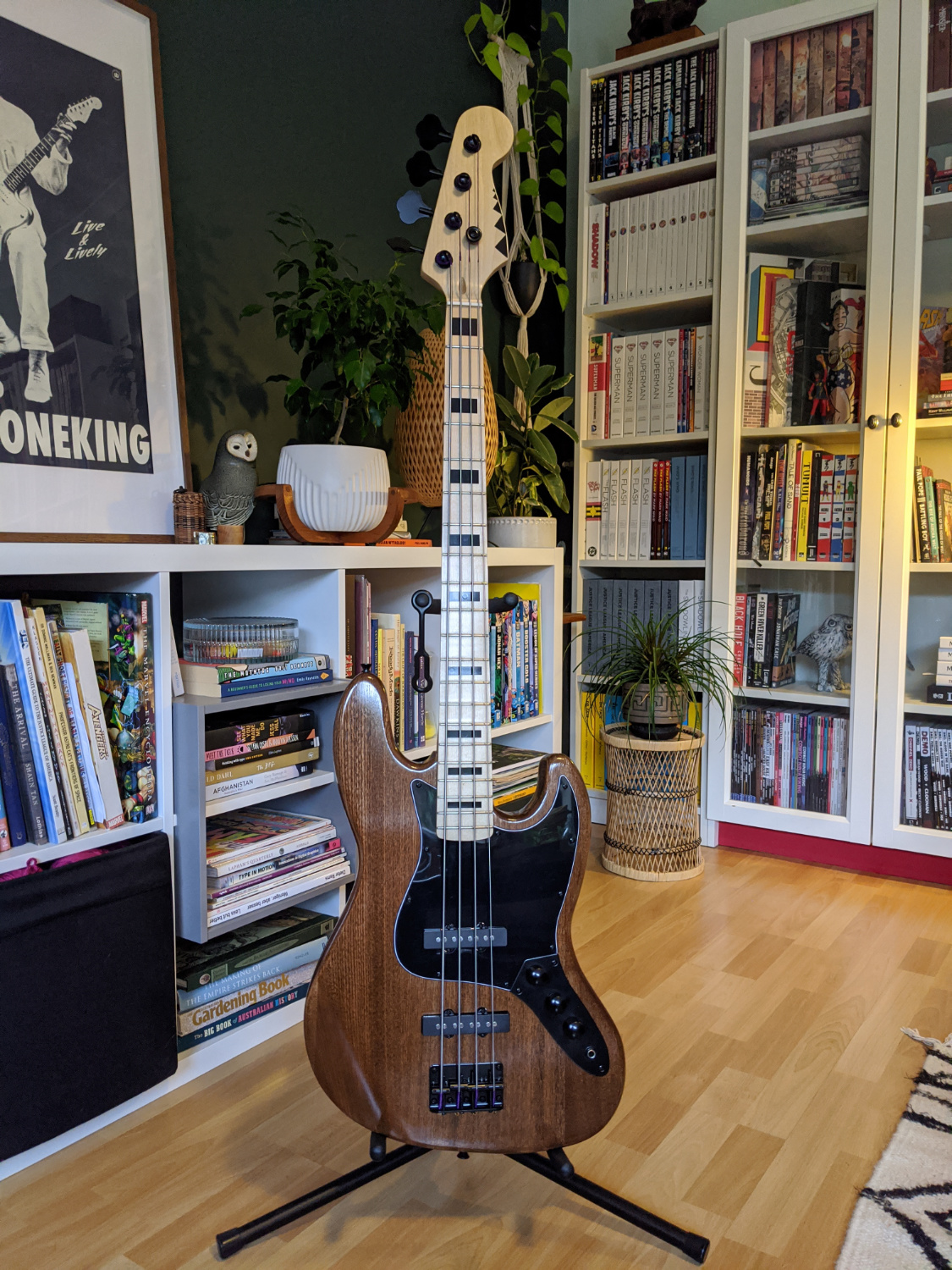

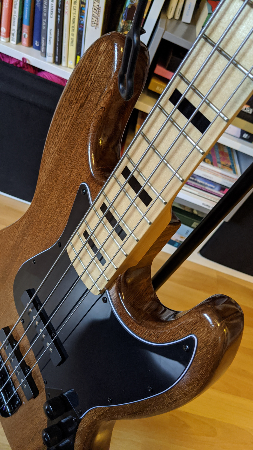

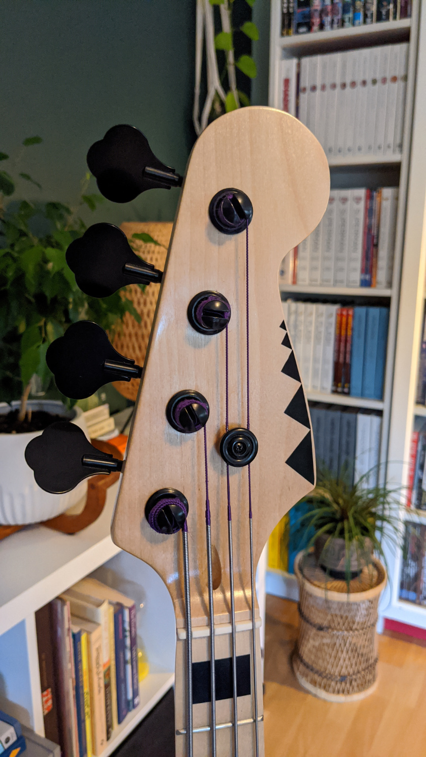

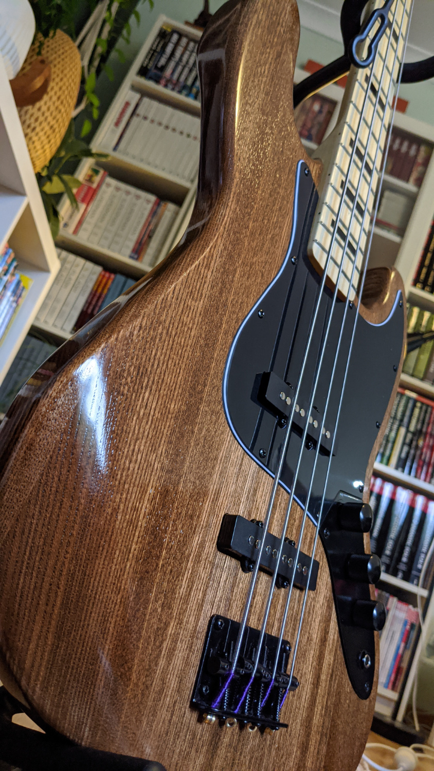

    - JBA-4M kit
    - Black hardware upgrade
    - Timbermate ebony wood filler
    - Birchwood Casey Walnut Stain
    - Birchwood Casey Sealer & Filler
    - Birchwood Casey Tru-oil
    - Creative-Cuts black block fret marker decals
    - Customer headstock decal from fret marker offcuts
    - Ernie Ball flatwound strings
