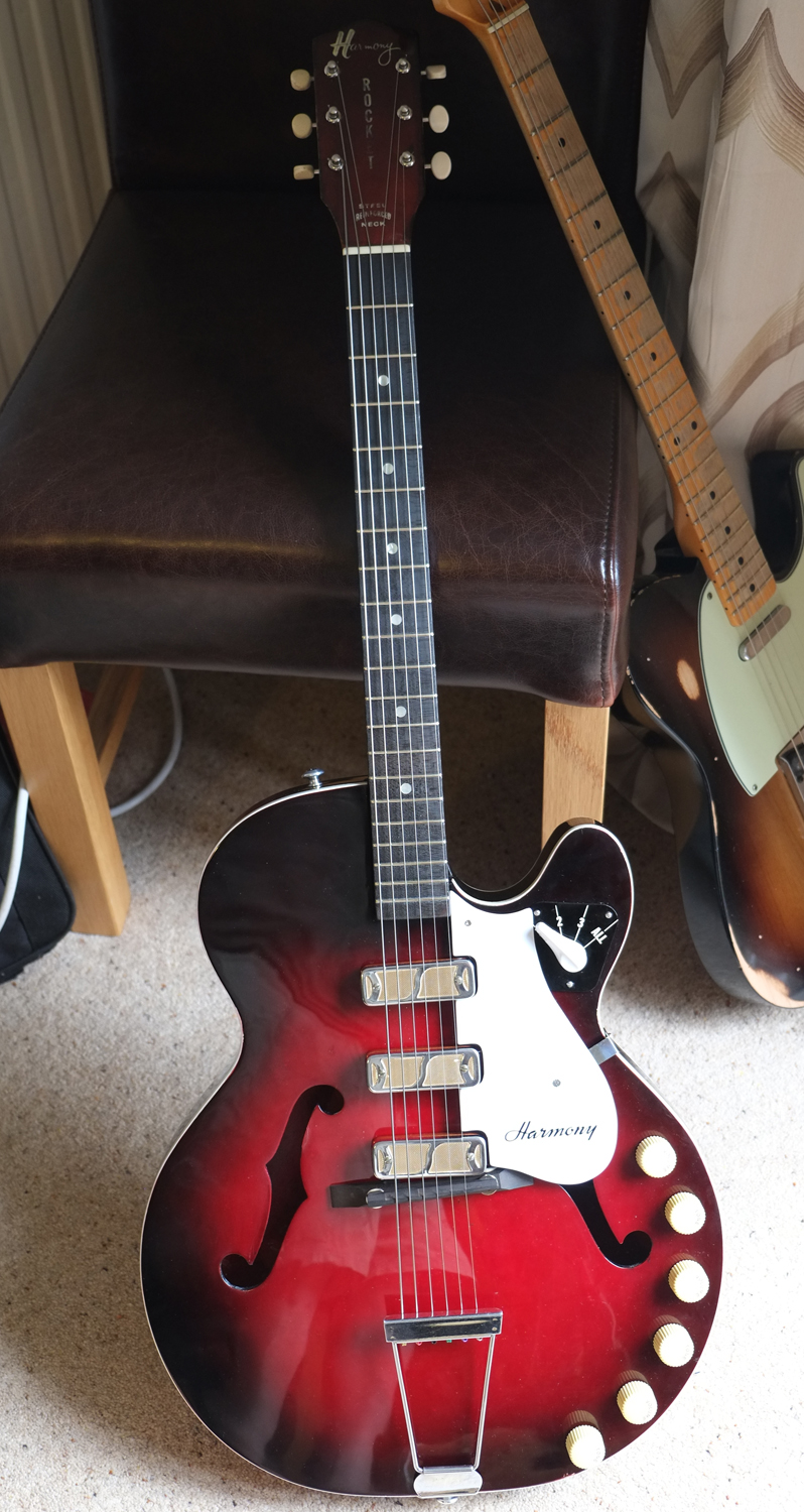

    I did up an H59 a few years ago.
Name:	Harmony finished small.jpg
    Found a beaten up one in the US so it was cheap and imported it into the UK. A few bits missing which I replaced or made.
    Neck wasn't a straight as I'd hoped for, and with a non-adjustable truss rod there wasn't much I could do apart from massage the fret heights a bit. It played OK, just not as nicely as I'd have preferred. Sometimes there are benefits to newer instruments!
    All the best with your build, and don't forget to start a build diary.

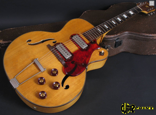

    Anyway, the challenge is to knock up something that looks kind of like this, (see attached pic), out of the GR-1SF kit.Click image for larger version.
Name:	Screen Shot 2020-12-08 at 9.46.36 pm.png
ID:	38355 Now that I've looked a lot closer, (the body shape is pretty right, I asked for no pickup routs, and no holes, other than for bridge posts), but now that I see it without all that, I see the f holes are positioned much further down the body on the kit, so that's going to bug me, but anyway.... The original actually has an ebony floating bridge, but I like the idea of good intonation, so unless the tone, or my playing is compromised by the schaller adjustable roller bridge, I'll use that. The Gibson P13 pickups I'm using have really wide pole-piece spacing (56.5mm at the bridge), so I chose the adjustable schaller bridge.
    Anyway, looking forward to unboxing, and starting to plan my attack.

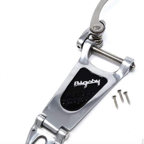

    I wonder if anyone can chime in about the "hollow" status of these kits? Are they (as described), fully hollow? Is there anything inside where the "Bigsby" is supposed to screw onto the body, like a front to back block, or bracing?

    B6 Bigsby instead, since the archtop would give a decent amount of break angle anyway, and I don't have to screw into the top. Or, I'd love to use a Click image for larger version.

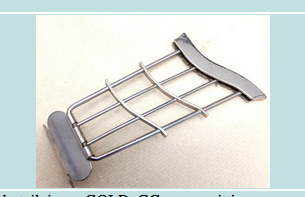

    Hofner "Harp" tailpiece, like the original Harmony H62 has, or a Click image for larger version.
Name:	Screen Shot 2020-12-11 at 9.34.26 pm.png

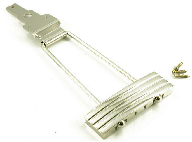

    Kluson #6, which may have been the Harmony backup plan, presumably, when the Hofner tailpiece went up in price.

    Yes the kits are fully hollow, with a maybe 30mm thick block (very soft wood) glued directly under the bridge area and then a further thin wooden block wedged in (not glued) between the underside of that and the back for a bit more support.
    The 'Bigsby' top screws are there more for a bit of sideways stabilisation than anything else and just screw into the ply. As you note, many Bigsbys don't have top fixing screws and are held in place by the tail block screws (there is a decent thickness tail block) and string tension. The kits do have a habit of coming with screws for the top that are far too long for the job and with a solid shaft section below the head at the point where you need the thread to be (don't ask me why!).
