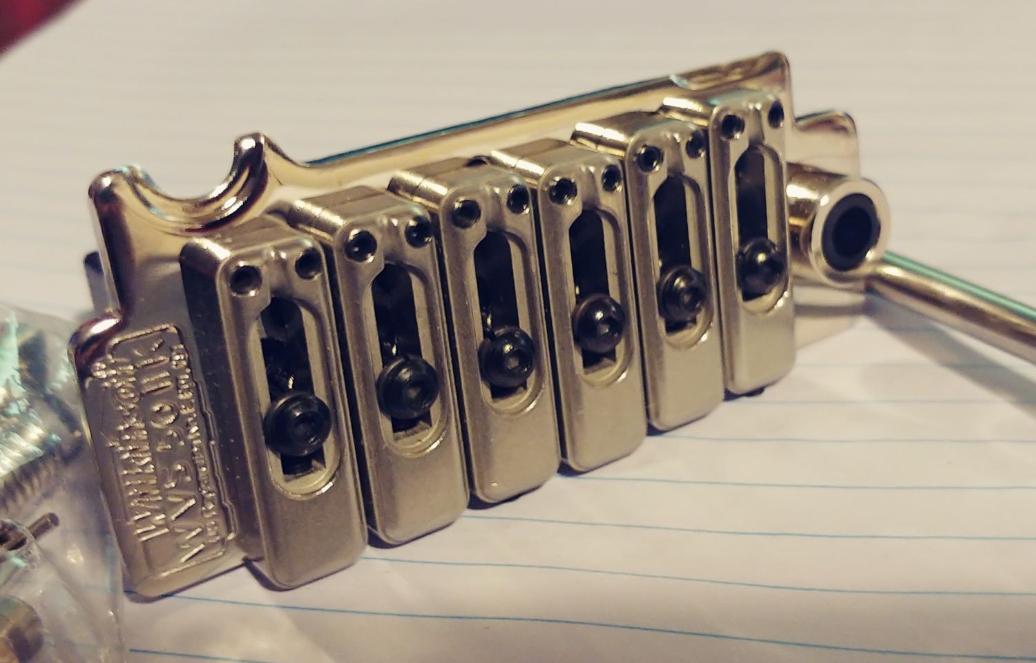

    • Wilkinson WVS50IIK 2 Point Pivot Floating Tremolo Stratocaster - Nickel

    Wilkinson tremolo arrived.

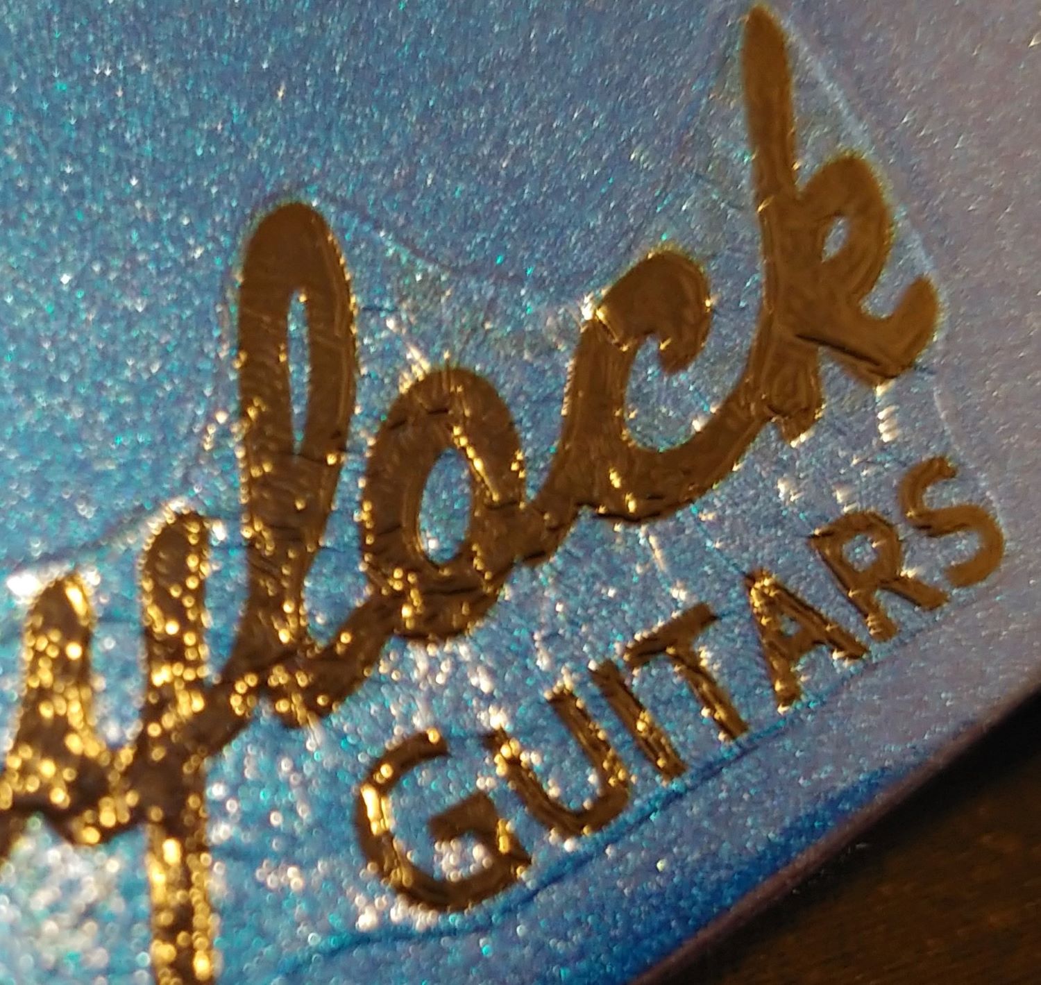

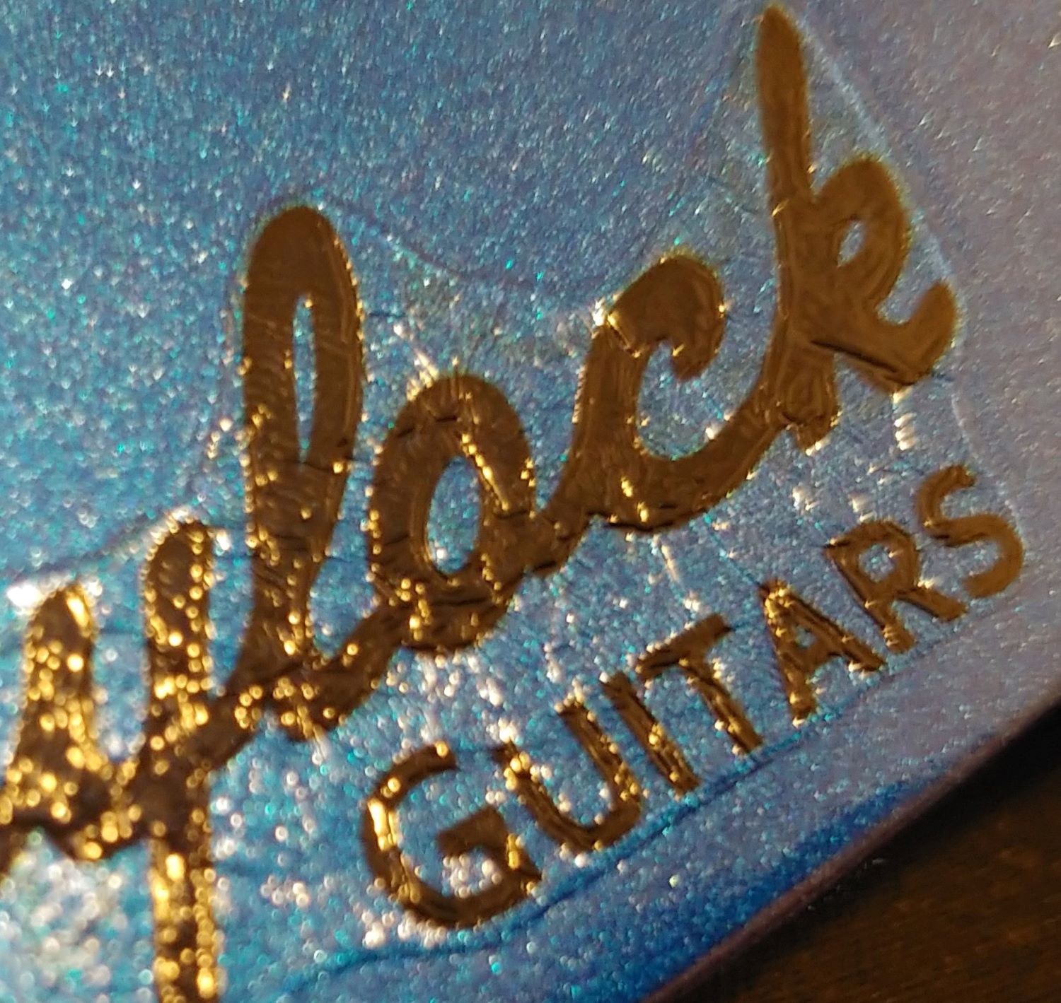

    Howdy folks.
    Bit of a problem with the inkjet decal. I sprayed one coat of clear (auto acrylic) after I printed it so it would not run when I soaked it in water. Then I soaked it in water and applied it. Everything was fine at this stage. When I sprayed 3 coats of clear, the decal wrinkled up.
    Suggestions?
Name:	Strat - Wrinkled decal.jpg
    About 12 hours I think. Overnight. And I did not heat cure it.
    Should have been long enough to dry, though with a layer of acrylic already on the top of the decal, it may have remained slightly wet and not fully stuck. It is the decal itself that’s wrinkled, and not just the layers of acrylic on the top?
    These days I use Decalsol (model kit stuff) to help stick my decals down and I’ll normally wait a full 24 hours for small decals and at least 48 for bigger ones. I use nitro sprays, and with a couple of coats of that over the decal before it’s applied, I know it could take a while for all the moisture to dry out from underneath it and I don’t want to trap it i n when I then spray more clear over the top.
    I haven’t used acrylic over decals, so can’t really suggest anything you could try to rescue the situation.
