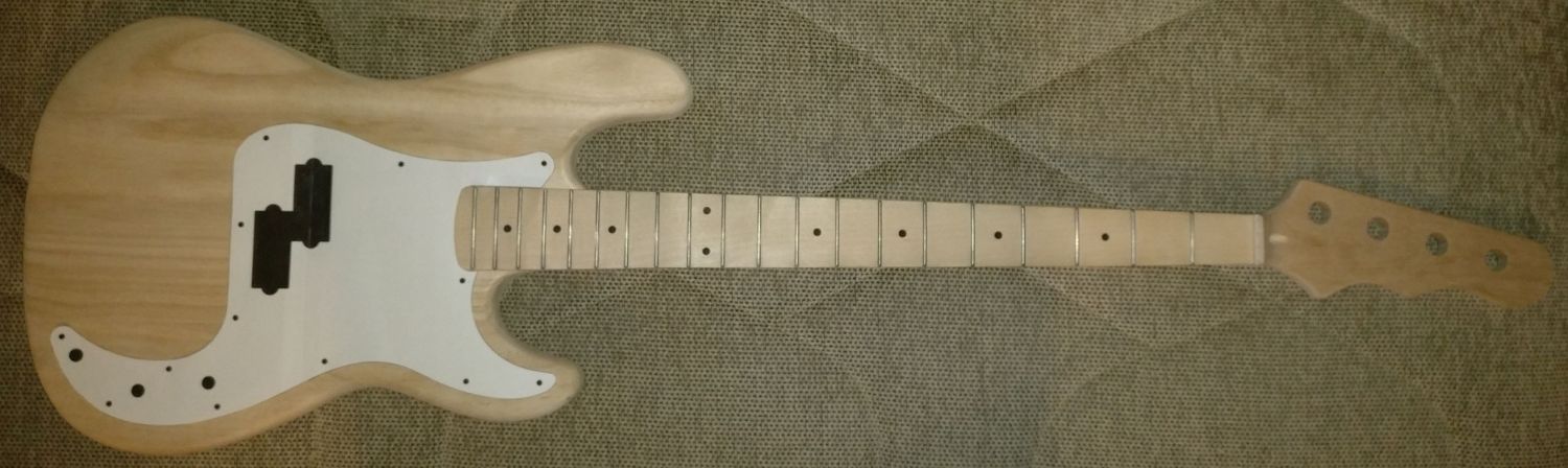

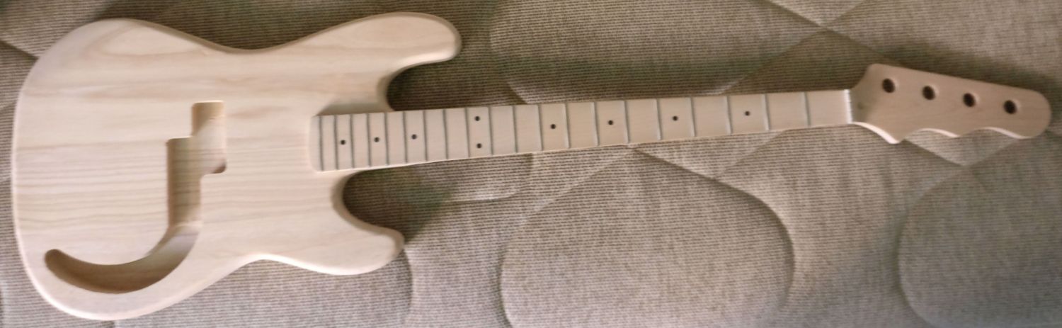

    This may not be a quick turnaround build, since I have one ahead of it in the cue. Still, I would say the build has now officially begun.
    I acquired a PB neck cut to a Jazz Bass profile that arrived in January. I have done a little work on the frets, and have had a bit of a fraught adventure shaping the headsock.
    I wanted a light, very simple bass. So when I saw what looked like a paulownia p-bass body on eBay for $33 it was irresistible. The body is super light. Maybe too light. It is also a bit less than perfect, with some dents, toolmarks and incomplete routes, but for $33 you don't expect it to be ready to put finish on.
    This morning I did a dry fit with the only two parts I currently have...so we are off to the races ;-)

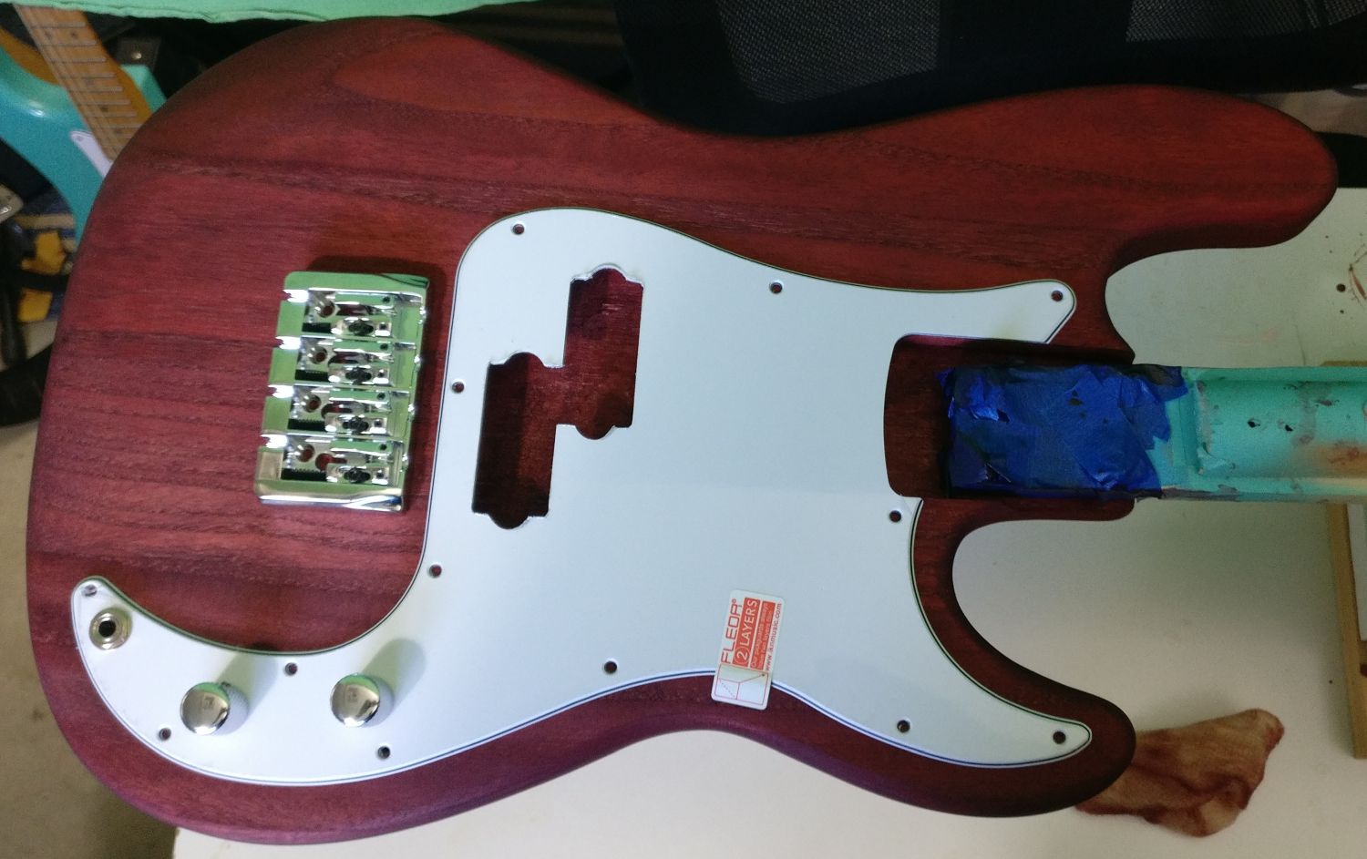

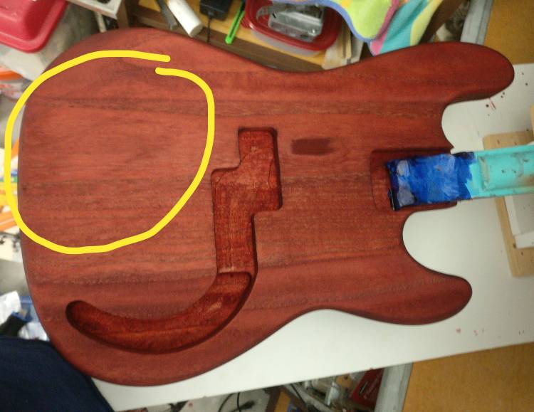

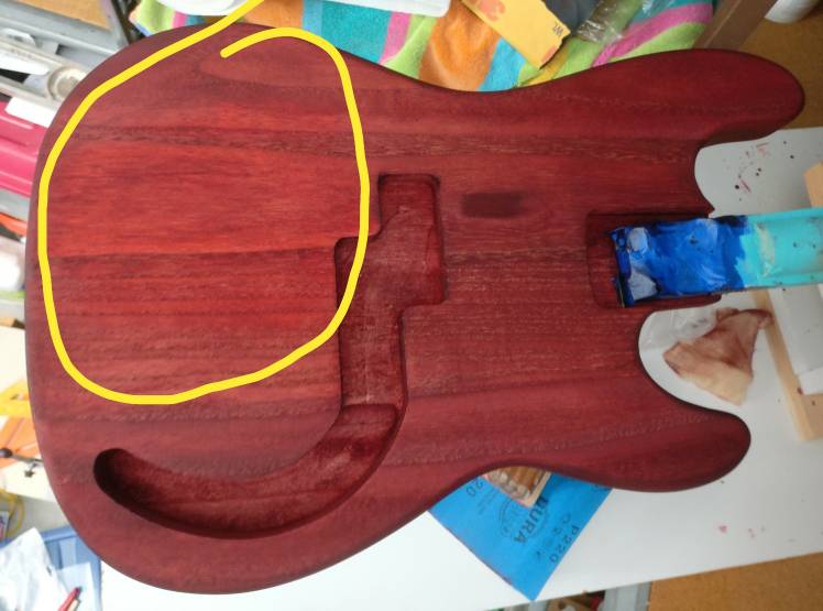

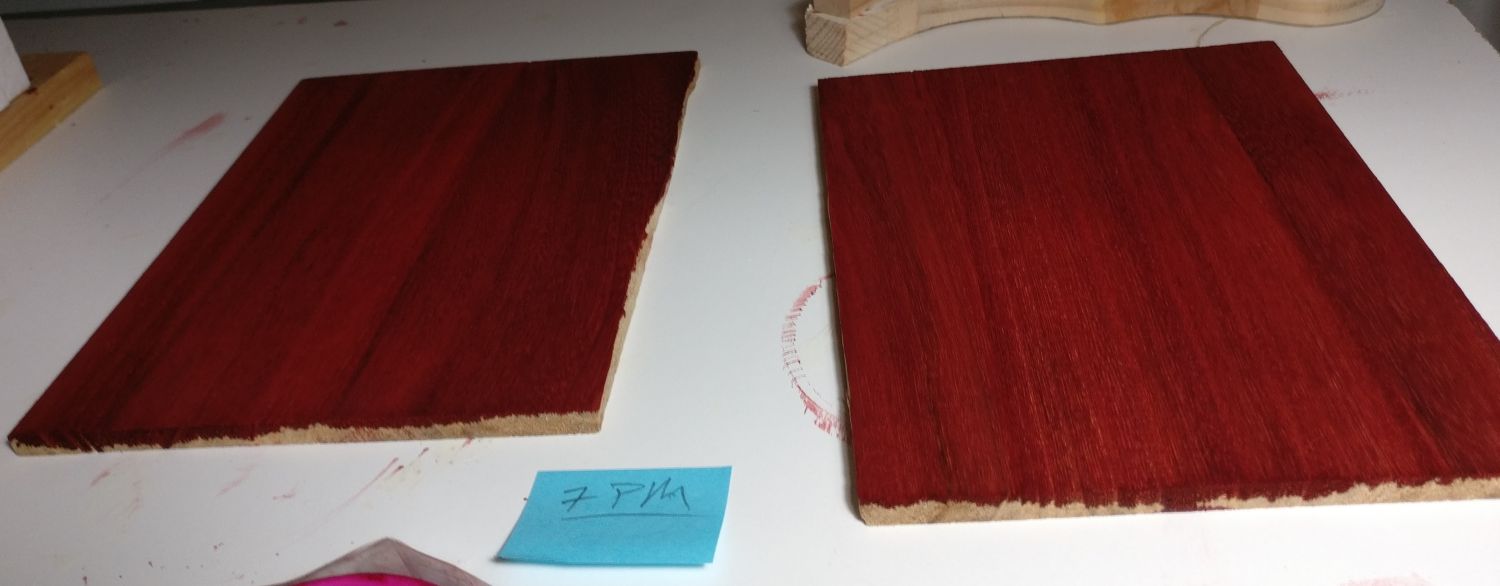

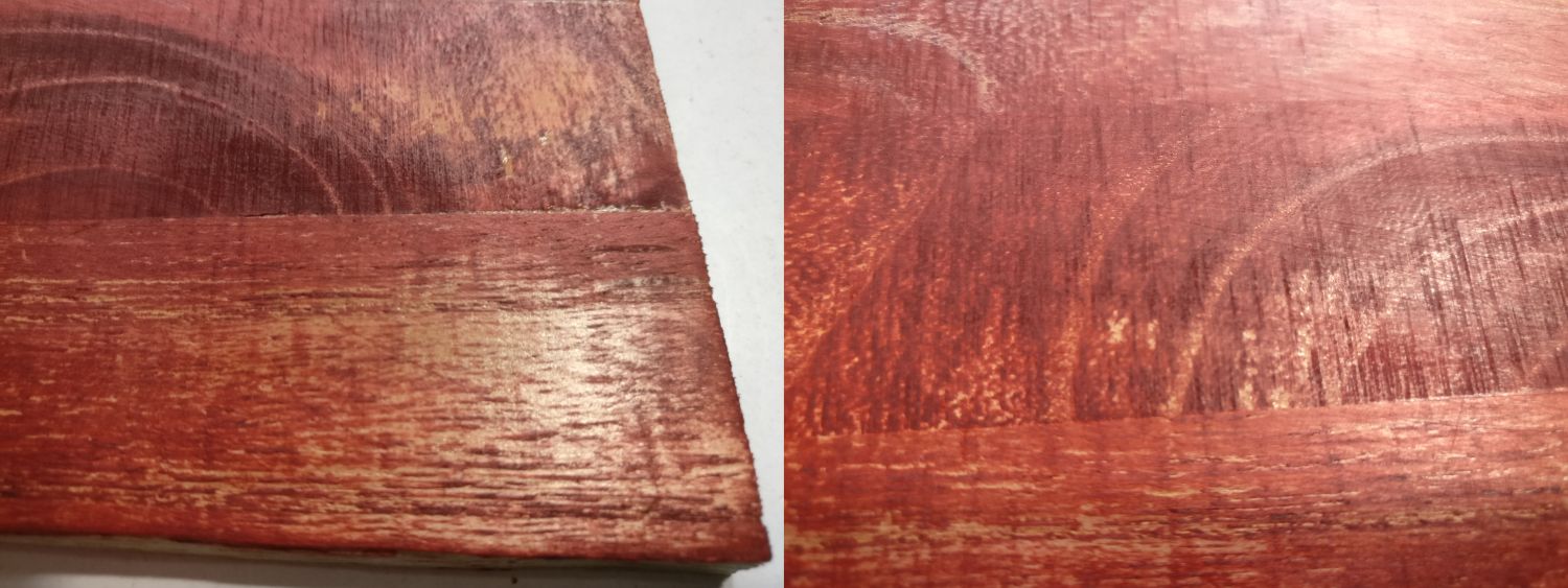

    I am hopeful that this will be a stained build. I put the first coat down and was immediately impressed by how much better small scratch marks showed up with stain on them.
    I sanded them out, and put on a second and third coat. I thought it looked good so I took a pic for posterity...and in the pic I saw some slight scratches that I missed in the upper left quadrant.
    So more sanding and a new coat of stain. I may do one more on that quadrant, but can see the improvement.
    I am using General Finishes Dye Stain in Empire Red. I had talked to General Finishes about their Dye Stain before purchasing and it was highly recommended for paulownia. Since then, however, they have posted a warning on their site that their Dye Stain, even after conditioner, may be blotchy on paulownia and pine. I have actually tried it on some scraps of paulownia and it was fine. GF's website says it might do a little better it you mix in 10% of their topcoat. I have some so I did that, and it seems to have worked well...mostly. There is one blotch just neck-ward of the upper pickup cavity. Fortunately that will be under the pickguard.
    Will leave it to cure for a couple of weeks before pore filling to minimize color pull. The 10% top coat is supposed to help with that but it needs longer to cure fully than the stain.Click image for larger version.
