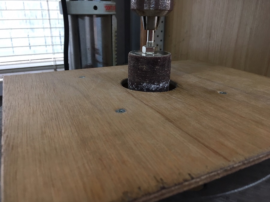

    It may be too little too late, but if you have a router table I presume you must have a decent workspace.
    Do you have a drill press?
    If so, I use a drum sanding kit in my drill press for that kind of shaping/squaring. The sanding drums range from 1/2" to 2", and I made a plywood work table that mounts onto the steel drill press table. The plywood has a hole in it so the bottom edge of the drum can pass below the wooden table (kind of like and upside down router table). It allows me to keep the drum perpendicular to the work piece.
    Not exactly a precision piece of machinery, but it works and way less scary than a router.
    I use the drill press for a range of tasks (that my old woodshop teacher would be turning in his grave about). I have Safe-T-planer for small planing jobs and have even used router and endmill bits in it for others.
    It's my Swiss Army Knife in the shed!

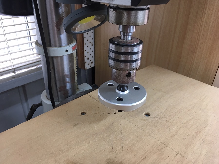

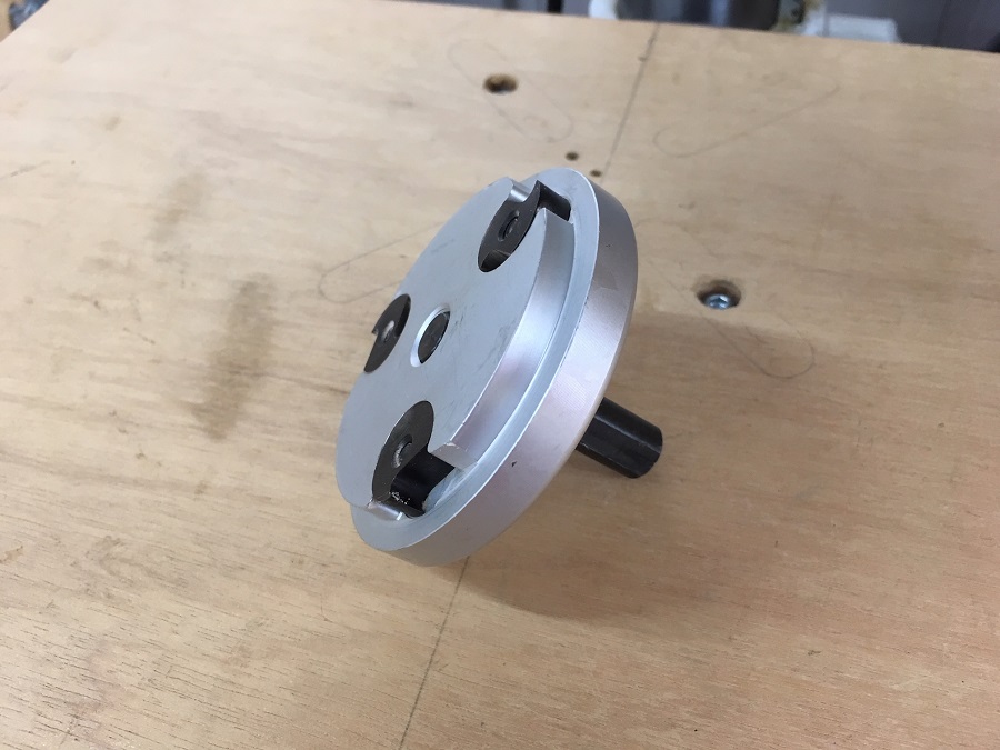

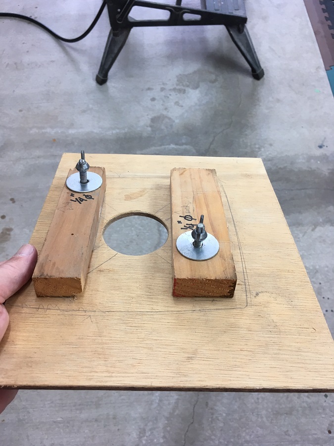

    Hey fender3x, here's some photos.
    The drum sander table is small and I've meant to make a larger one with 1/2" ply (current one is 1/4") but it's one of those projects that keeps falling back on the list of priorities. The little one has been sufficient thus far for my purposes.
    My drill press has a round slotted steel table and my plywood tables attach via bolts, mud washers & wingnuts underneath.
    You can get the Safe-T-Planer from Stew-Mac for $35 + postage. It has its limitations but it's been a pretty handy little gadget. I used it to thickness some neck heels. Worked a treat.
    Anyway, here's the pics:
