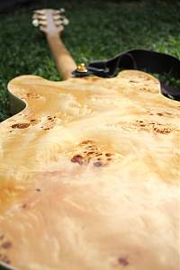

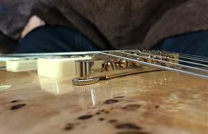

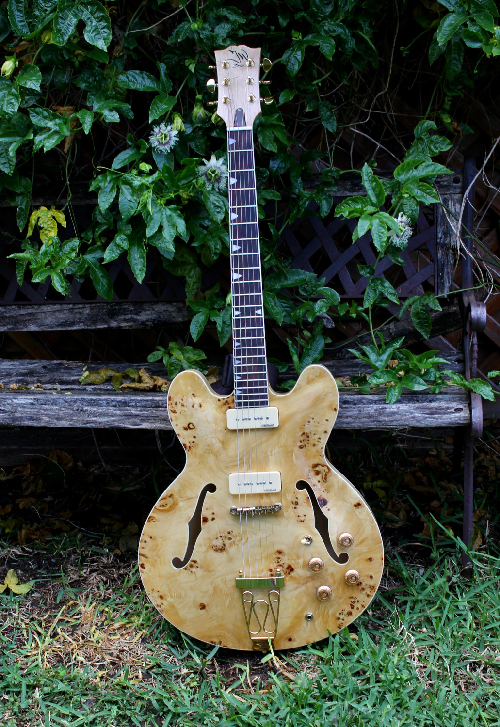

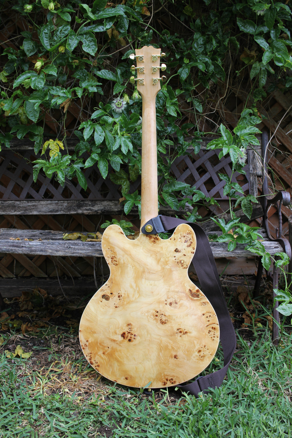

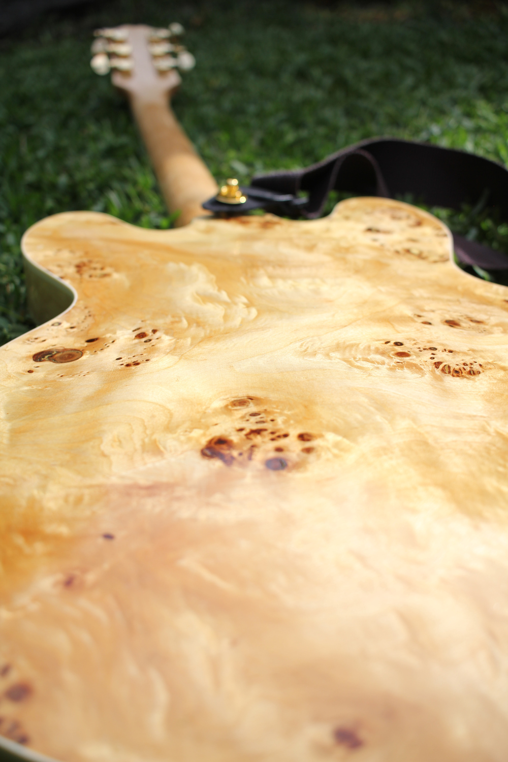

    Well, it's been quite a while, and I've been slowly working away on this guitar - I think I'm going to call this done.
    I've been playing it for quite a while, but I've only recently got around to the finishing touches - headstock decal and truss rod cover.
    This was my first build, and a huge learning curve. The finished product is far from perfect in many ways. I'm not even sure it passes the two meter test! It does, however, play quite nicely, and has seen my poor old strat collecting dust.
    Many thanks to all who so generously shared their experience and knowledge. This forum really is a great community.
    Jon

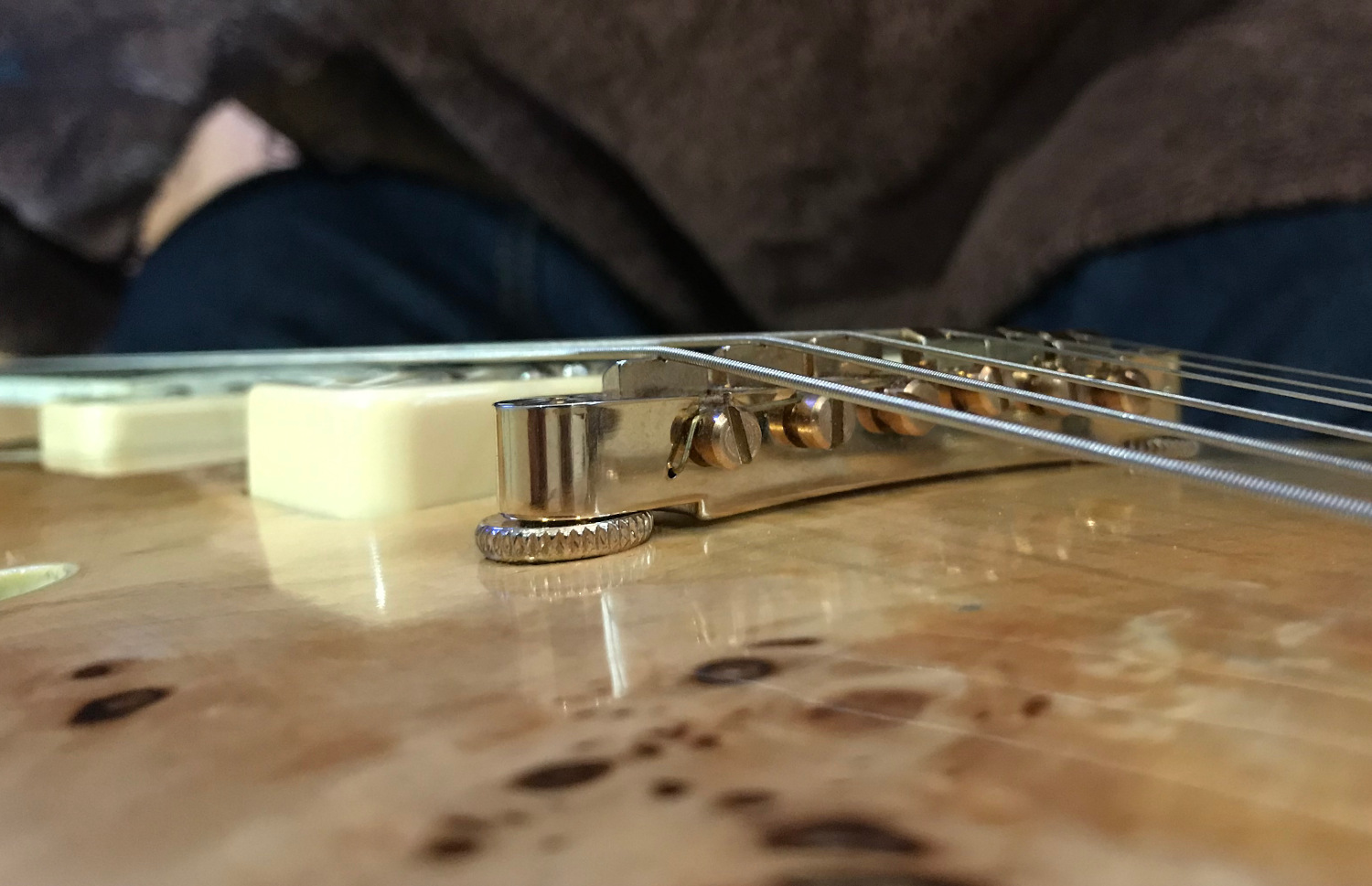

    DarkMark, the action is a little high (could you tell that from the photos?) At least, it feels like it is, but I've just measured it and it's about 2mm at the 12th fret on the low E string, which is probably OK. I didn't quite get the neck angle right, so it's as good as I can get it with a very slight relief in the neck and the bridge wound all the way down. I have considered filing the bottom of the bridge down (i.e. below the posts) so I can drop it down a little further.

    The neck angle on my ES-1/330 build was also a bit too shallow to get a decent low action. I ended up replacing the bridge post bushings with ones that sat level with the top and also cut the saddle notches a bit lower in order to get it low enough for me to be happy. https://www.buildyourownguitar.com.a...l=1#post204201
    You'll have to do a search for suitable replacement bushings, as a lot have the lip on top which adds an extra 1.3mm or so of height. I think these were from the TonePros locking stud set I got for my GSJ-1 build and didn't use as the existing bushings were fine. You'll need an M8 internal thread.
    You can also use a triangular or square needle file to deepen the saddle slots, but it's neater if you can use nut files. Just don't go mad as it's easy to cut too deep. You may find that deeper saddle slots will

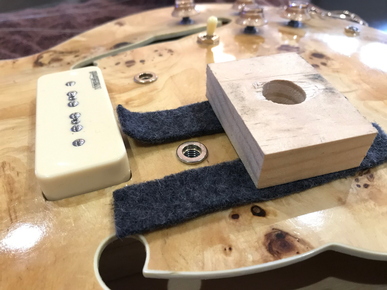

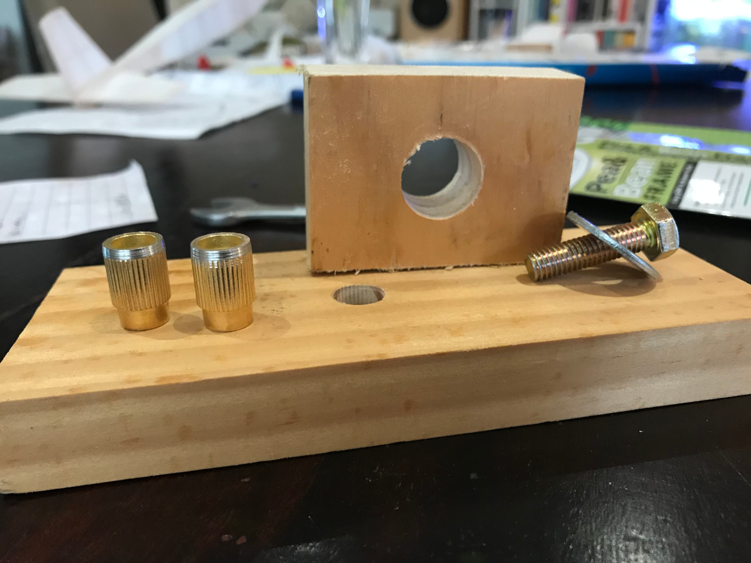

    I had a look around for some replacement bushings, but couldn't really find anything, so I converted some spares that I had with the help my drill press and a file. The thought of pulling the bushings was a bit scary, but a simple jig and a test piece made et easier. They actually came out surprisingly easily given how hard I hit them with a mallet to get them in!
ID:	37798 Click image for larger version.
    Now my action is about 1mm at the 12th fret on both high and low E strings. I am getting a bit of buzz, most notably on the B string. I'm going to play it for a while, and might raise the bridge a little.
