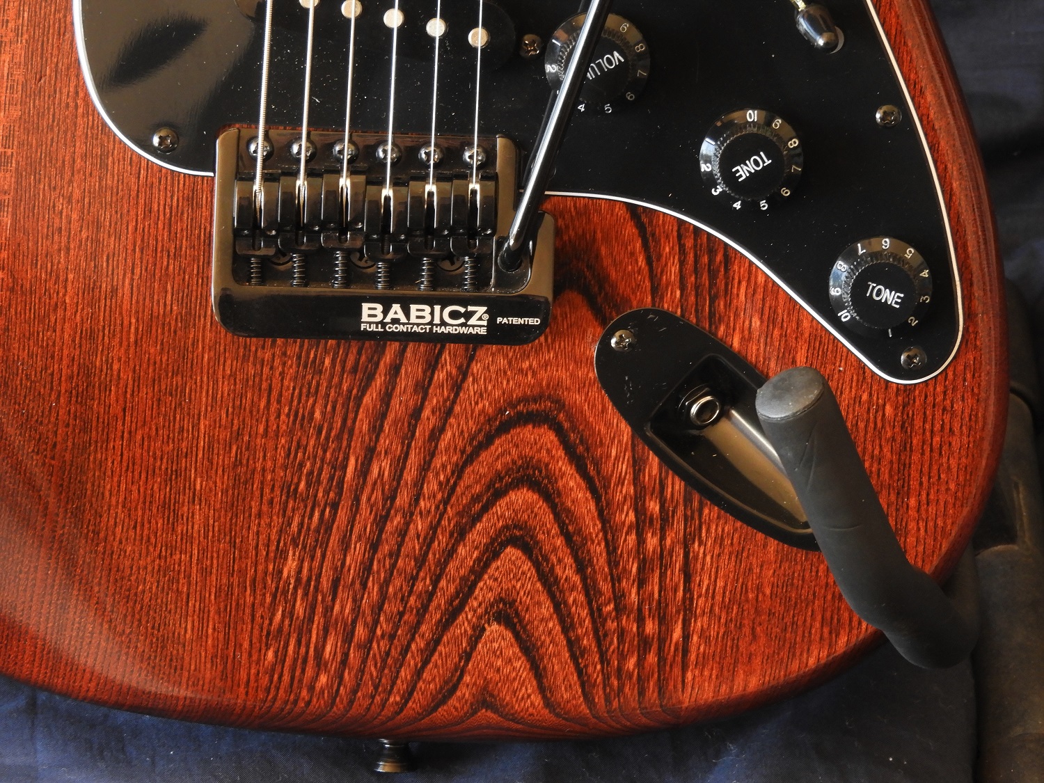

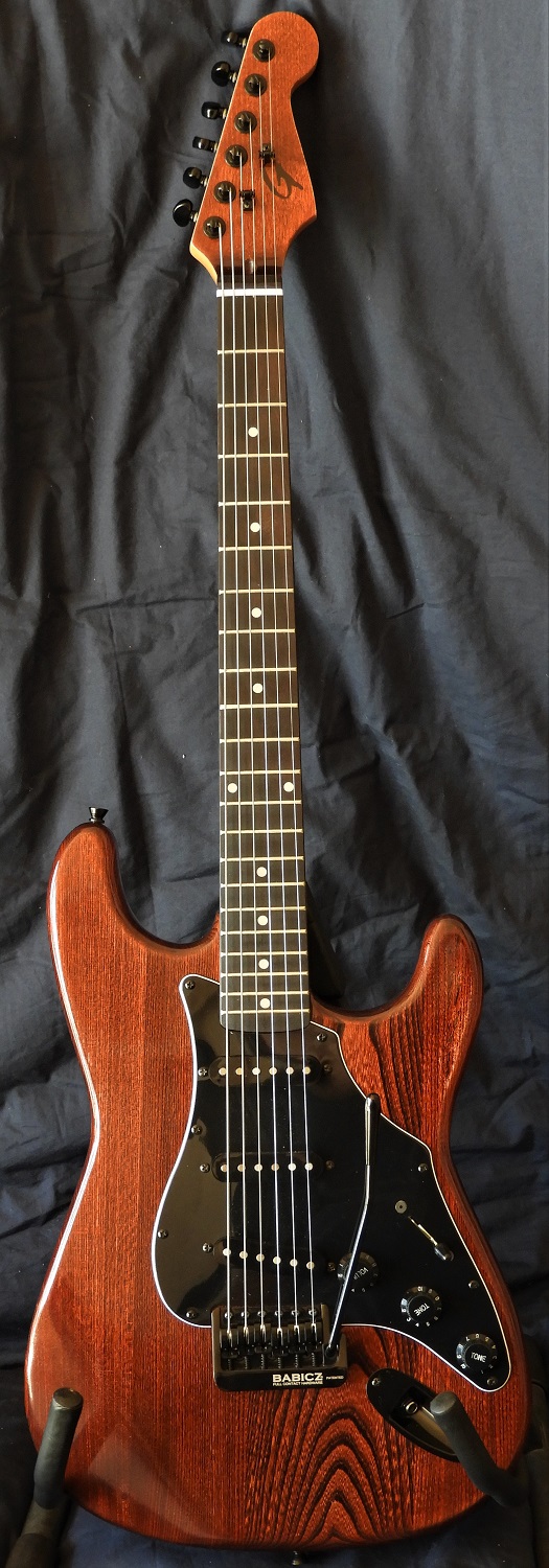

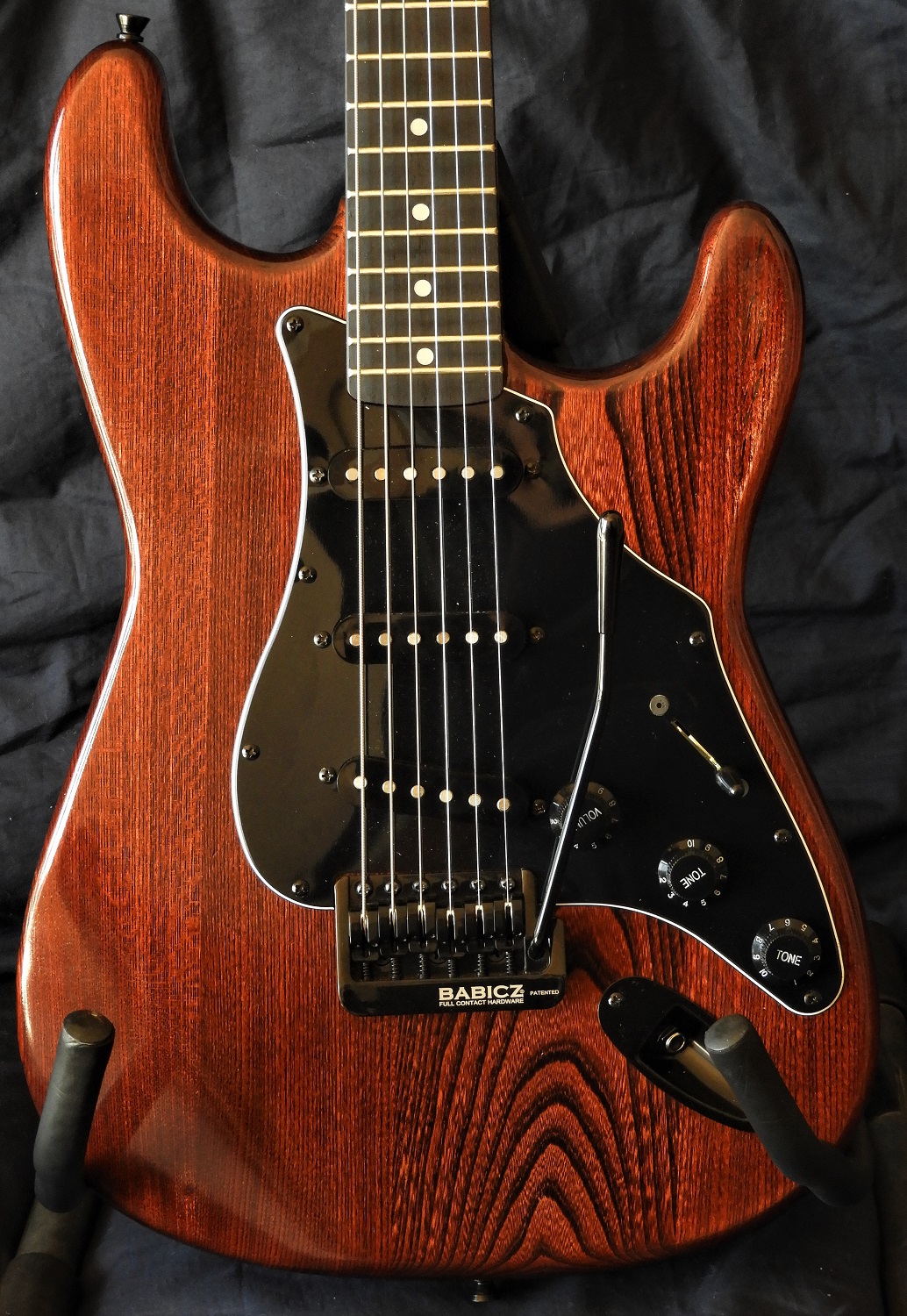

    STA-1 with extras
    The aim of this build was to give me something with a whammy bar so I can play some Shadows/Hank Marvin instrumentals. Second was to try out some of the gadgetry that forum members had been mentioning during my couple of years membership.
    Here are the details of my second build:
    - finished this ColorTone Red Mahogany, black Timbermate grain filler, and 50 coats of TruOil.
    (the Ash needed a lot of filling and levelling)
    - Electronics upgraded
    - Grover Mini Locking Rotomatics machine heads
    - Babicz Bridge
    - ToneRider AC2 pickups
    I couldn't bear to cover the grain with the horn on the pickguard so it was cut off.
    I am very happy with the result and tone.

    Great result. Quite like the pickguard mod as well.

    That's a fantastic-looking guitar, Greg. Nice work.

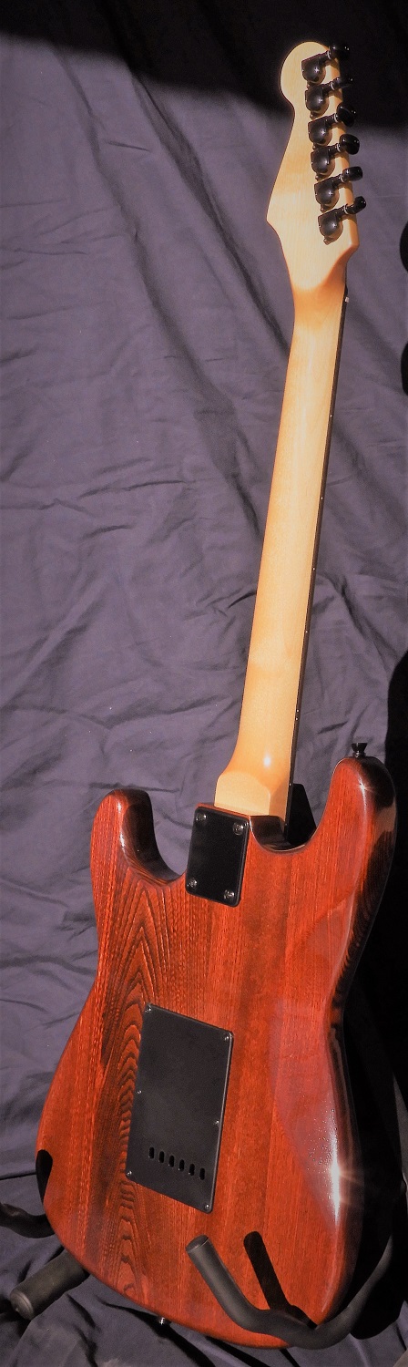

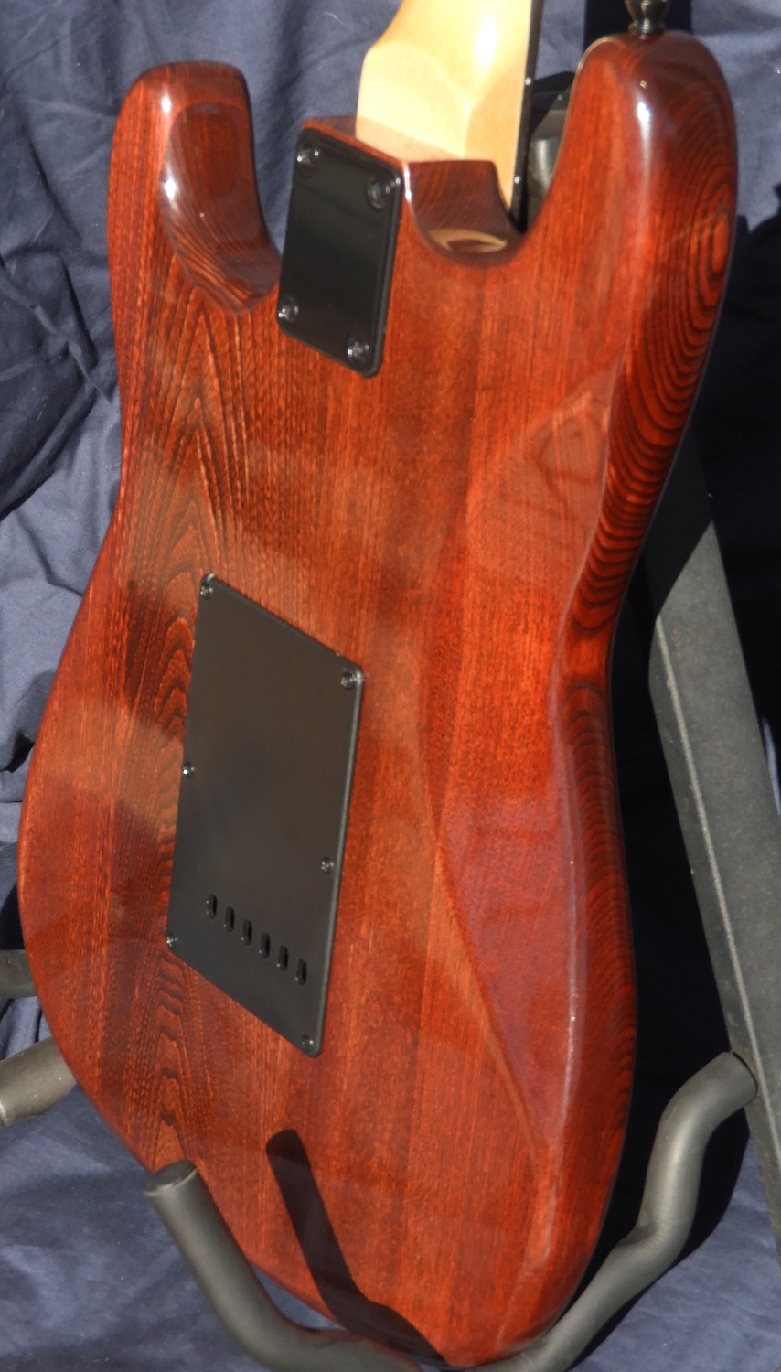

    2 days later I realized I had not included photos of the back of the guitar.
    The sun has brought out the red which is closer to the actual colour and plan for the build.
    Hope this is legal. Sorry about the reflection of the verandah rails

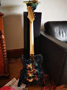

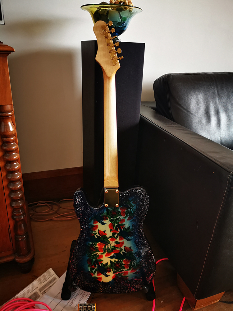

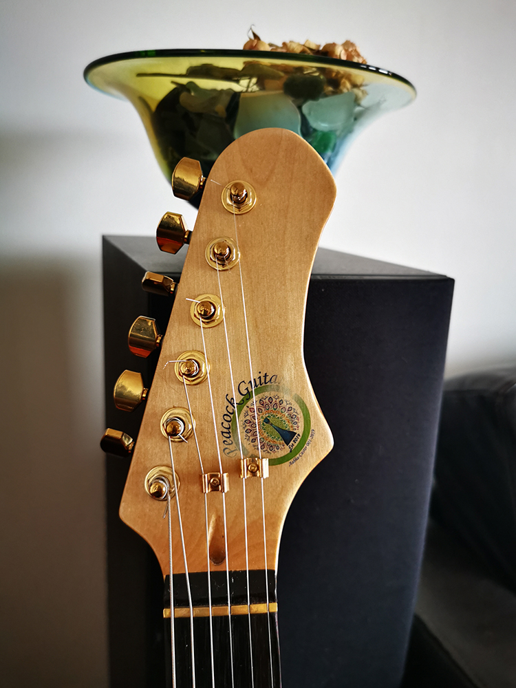

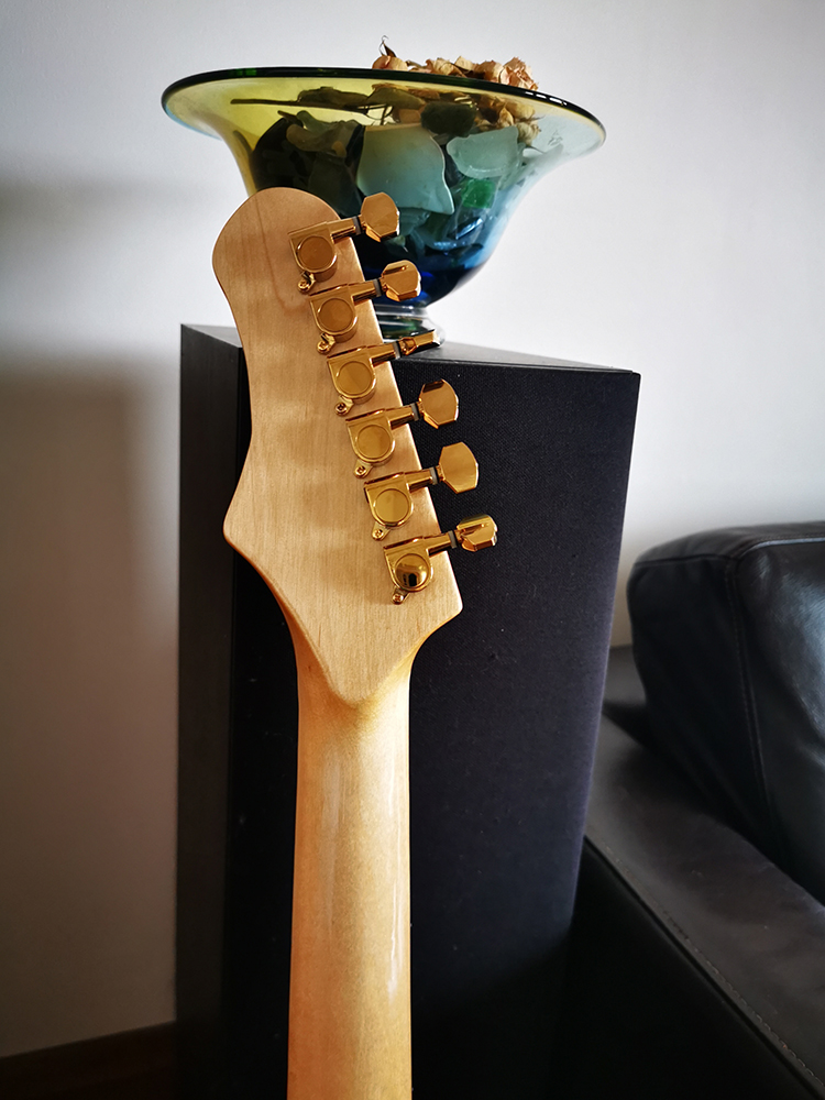

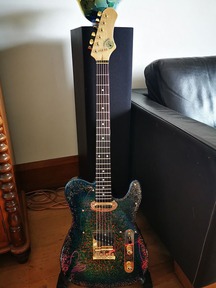

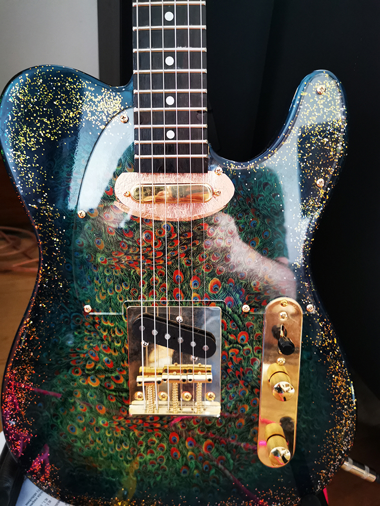

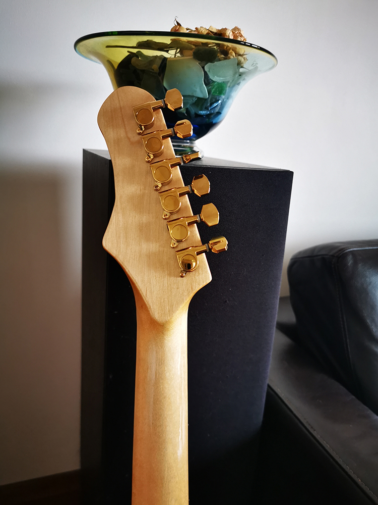

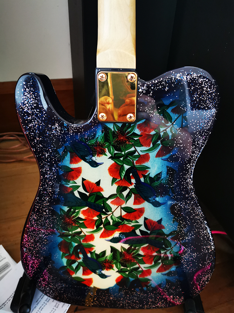

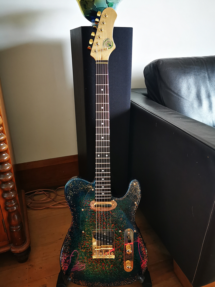

    "This is the kit that I built for my daughter Aabha who is from India. It is a cloth top. The peacock cloth represents India while the New Zealand native bird represents New Zealand. It is finished in gold hardware because only gold is acceptable for an Indian girl. The cloth was toped with 3-4 layers of a clear two part epoxy then finished with 2k automotive top coat. I also designed a decal “peacock guitars” and gave it a model and serial number of Aabhacaster 1. I upgraded the nut to brass and the pickups are vintage telecaster. All up a nice project. Still needs some better finishing round the neck pickup but still happy
    Aabha really loves it and I hope the forum members do to

    Gorgeous, that is all
    A couple of instant classics already this month!

    Beautiful guitar, Scott.
