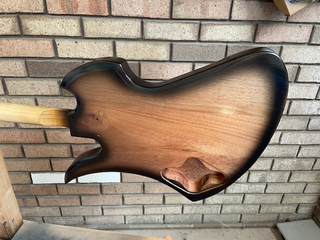

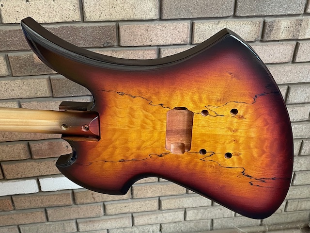

    It has been a while, but I have finally got around to adding 3 more coats of clear poly.
  2. #72

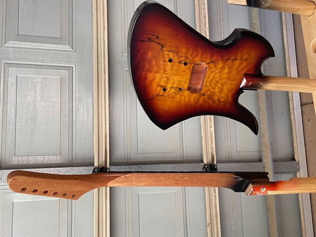

    2,025
    Burst 2. I was very worried about this - but I think I've pulled it off. More clear coats to follow!
ID:	45325   Click image for larger version.

  4. #73
    2,025

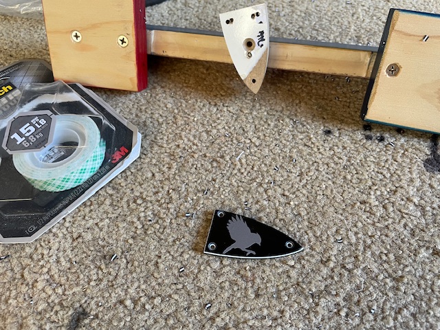

    4 more clear coats of water-based gloss poly added today to the body and headstock. Also gave 3 final coats of w-b satin poly to the neck. Hopefully this should be enough! Now to leave if for a week or so to gas-off.
    Also made a spear head truss rod cover, and applied a mockingbird decal.

  6. #74
    Mentor DarkMark's Avatar
    Sep 2017
    1,578
    Oh my, that looks good

  7. #75
    2,025
    I didn’t know you could put water based over oil based.
    Thanks DarkMark.
    It may not work for all! I got the idea from DickyBee! I give the oil-based coats (I have been using Tru-oil!) a few weeks to gas off. Then apply the Cabot's water-based poly' coats. It helps prevent the raised grain issue when using water-based materials. Fender3x also promotes using a shellac coat between different layers to reduce compatibility issues (but I have not tried, or needed this).
  8. #76
    3,084
    I have also used water-based top coat over oil based paint...but at the mfg's suggestion I made sure that the oil based paint had completely gassed off first ;-)
    The guitar looks fantastic BTW. Really amazing burst!

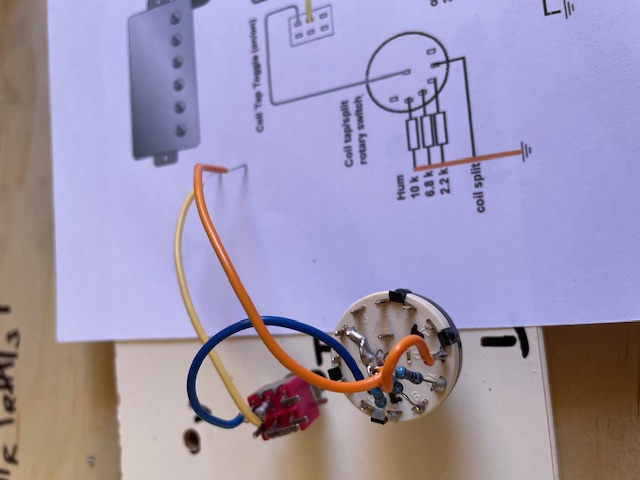

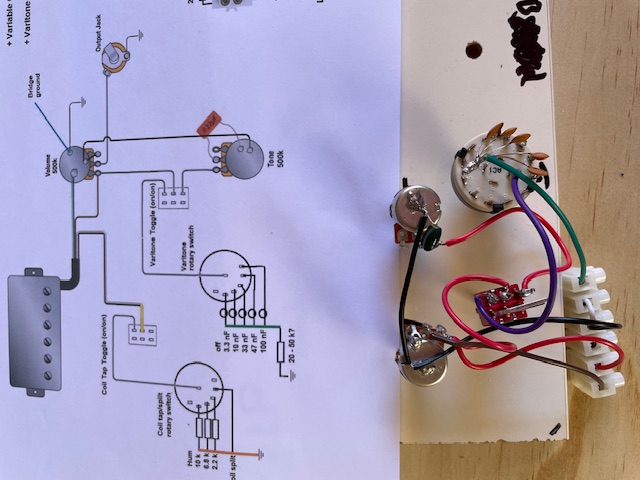

    Today I have soldered the electronics:
    volume and tone,
    Varitone circuit,
    coil tap to coil split.
    I think I need to get some heat shrink to tidy it up a bit!

  10. #78
    3,084
    ...I think I need to get some heat shrink to tidy it up a bit!
    It already looks pretty tidy by my standards ;-) Not sure what you'd need the heatshrink for. Unless you think there are some connections that might cross when it's installed.

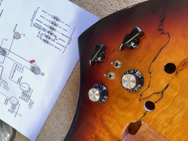

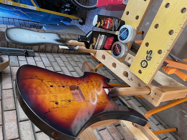

  11. #79
    2,025
    More progress:
    Today I have given the body a wet rub from 1500 to 2000 g, polished them with Kustom Creations Kustom Grit step 1 (cutting compound), and step 2 using a Random Orbital Polisher and micro-fibre pad. I then applied Maguire’s Ultimate Compound and then Scratch X with the Polisher and micro-fibre cloth.
    Also drilled the holes for the electronics and added the electronics. (I probably should have drilled the holes for the electronics before finishing the body - but I was unsure what I wanted!!)

  12. #80
    3,084
    Looking very shiny! There is always the danger of cracking the finish if you drill after the finish hardens. But if you drill early there is a danger of wood swelling, particularly with water based finish. I generally do it the way you do. I try to remember to start the drill on the reverse setting to get started and then switch to normal. I also tend to use a reamer very gently and slowly to make small holes bigger. In your case, it looks about perfect the way it is.
