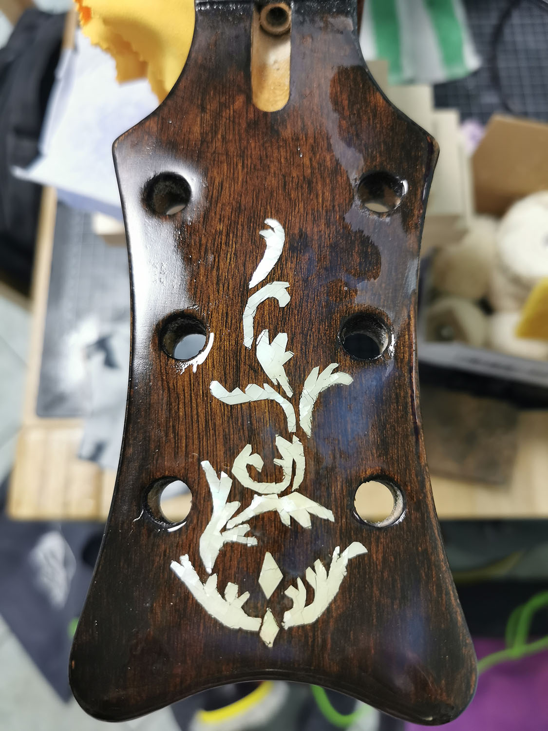

    The heat wave in Germany has ended abruptly and it's amazing how LONG the poly needs to dry now that it's colder. It even got some milky surface from trapped moisture but I gently sanded the top and this helps with evaporation.

    I guess after it's dry, it will take at least a week to properly harden enough to flat it down. I should have done the headstock way earlier...
