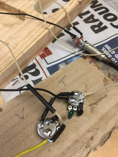

    Instructions followed. Tap test is working with no hum.
    Unfortunately only white wire left to run to the bridge, but meh.

    Quick question, how do you joint the ground wire at the bridge end? As in, where, what and how does it make contact at the bridge?
  6. #76
    For a TOM bridge, ground wire poked into the post bushing hole before the bushing goes in. You need to drill a small hole into it from a suitable cavity.

    Thanks Simon, That’s all I needed to know.
