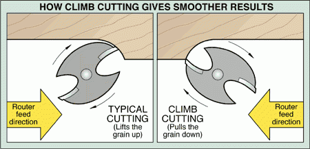

    I have some round-over routing to do soon which I've not done before (until some test pieces yesterday).
    All my routing experience has been "internal" like pickup routes etc, so outer edge stuff has my anxiety up a bit. (no pun intended)
    I really, really, really can't afford any stuff ups or tear out on this project, so I'll keep practising! I'll probably end up with every spare scrap of wood in my shed with rounded edges!

    If you can find some with similar grain and then more specifically grain orientation - then you'll get in the ballpark for which direction(s) you need to use.

    I'm sure you understand the theory, but practice is where it pays off.
    I don't think tear out is too much of a problem on a round over bit - it's more burning, which is easily cleaned up with some sanding. What are you working on? Guitar related? Huh, huh?
    I should have been more specific as I was thinking about having to route across the grain (end grain) but didn't say so in my last post.
    I've seen videos about the climb cutting (and another similar technique called bump cutting). I did some more playing around today and have a better idea on how to go about what I want.
