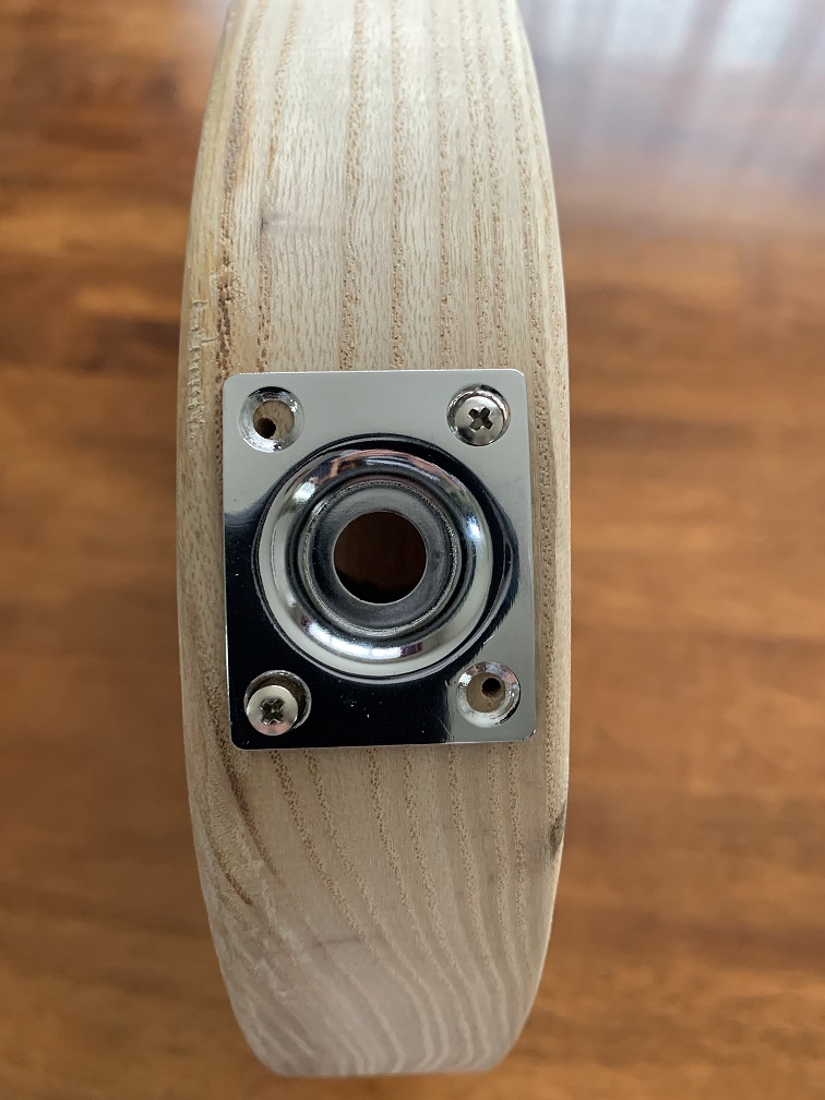

    I am currently doing the same thing as you, stripped of the poly with my heat gun.... I had access to a thickener machine with diamond blades which removed 2mm across the back and it took 1kg of the weight so far ! Wow... the body now weighs 2kg which is getting down to where I want it... with the belly & arm scoop taken off should be perfect

    Woah, that's an impressive weight saving. How does the output jack positioning look after that? I reckon if I'd taken more off the back, it might have looked a bit lopsided.
  5. #54
    It looks really good on mine, luckily the jack was a little more towards the front so it now looks dead center... I will put a pic up for you soon

    Jack Pic... you can see its pretty center, its coming along really great
