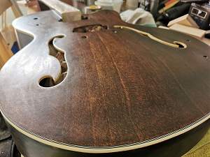

    Currently, not progressing as happily as I wanted.
    The shielded wire is really not nice to solder. It's pretty stiff and likes to break away from solder joins. The neck pickup is working fine, but no noise from the bridge pickup. The switch is working, tone and volume pots are working, solder joins are fine but pup is dead. Will try and solder another pup in, if this is working, I know the pup is bad, which would be a shame. If the replacement is also silent, I know the problem is somewhere else.

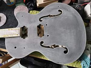

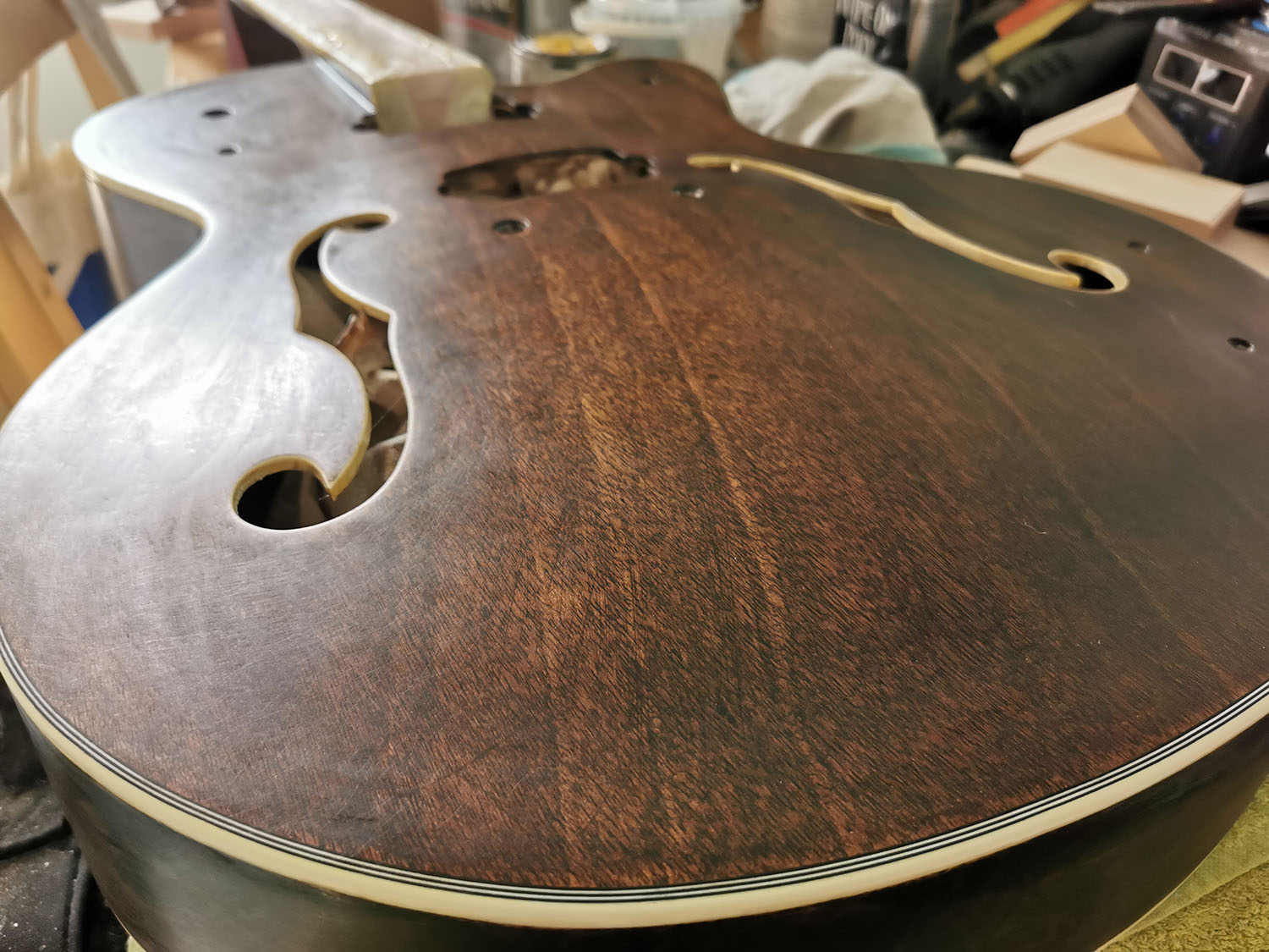

    Also, I spent 3 hours yesterday sanding flat the guitar. It was all looking really nice and and I was on my last pass with grid 3000 wet, when I noticed brown traces on the paper - I sanded through the poly. On BOTH sides. It's becoming a tradition for me, I guess.
    Luckily, no visible damage to the stain, also no idea WHERE I sanded through, but still..... I was THIS close to polishing it, fuuuuuu
    Now, I'm spending a few more days wiping on more poly. Finishing really is the least fun part of the game.

    You'll probably find that the first layer of poly took up some of the stain colour. so you've sanded down to that, but not through it. I do it all the time. I don't want to, but it happens.
  7. #57
    Hamburg, Germany
    333
    Oh, that sounds plausible, thanks Simon! How do you judge how thick the poly is, or if there is enough left for polishing? I really struggle with this. On my last build (the single cut style with the blue top), I polished through the top coat and it took a while to recoat it. I didn't polish it as much as I'd like to afterwards because I was too scared to mess it up again. So it would be really annoying to polish through the poly on this build, too.
  8. #58
    Please don't take this the wrong way, but I think you may be trying to get the top coat too perfect before moving to the polishing stage.
    If you try to remove every single orange peel dimple, rag stroke or imperfection, you will sand through before you reach Nirvana - that perfectly flat blemish-free coat. (unless the coating is incredibly thick, and that has problems of its own)
    I have been guilty of this myself until I realised that there is an acceptable level of orange peel and imperfection that will still polish to the point of a mirror shine, and I will bet real money that 99% of anyone wouldn't even notice.
    Even high-end automobiles will have some degree of orange peel in their finish.
    I've come to realise that OP is broadly misrepresented and misunderstood. That it's not necessarily as bad as it is just a reality.
    I reckon if you can get to 85-90% before final polishing, you'll still end up with good looking finish.
    Learnt this the hard way. I also started looking closely at a lot of paint work, on everything from refrigerators to sports cars. If you look close enough, you'll find something.
