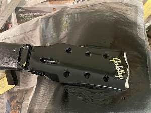

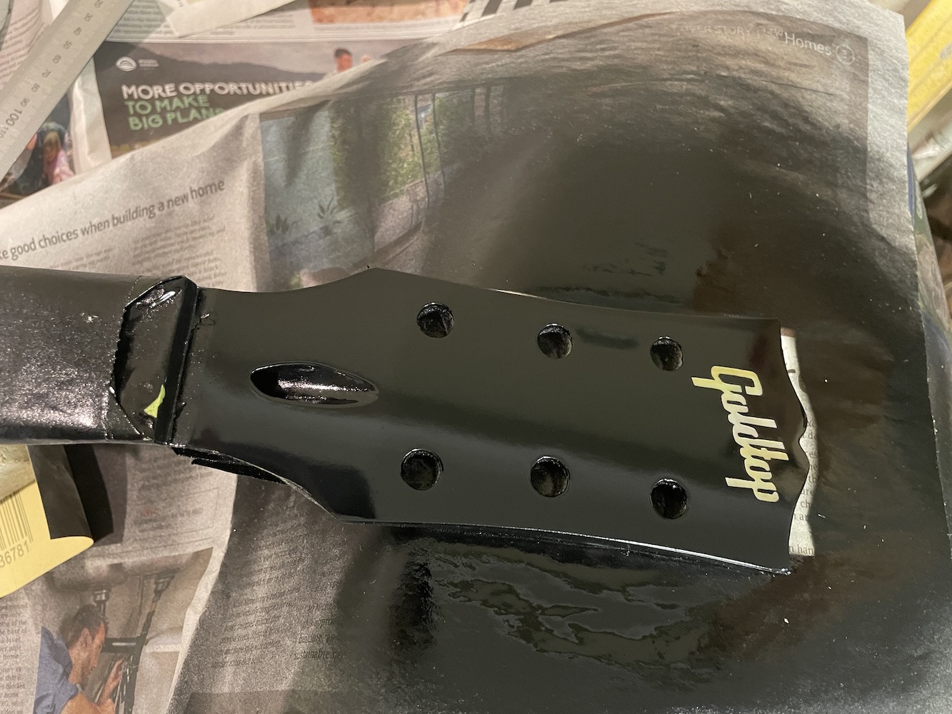

The plan is to do a Goldtop, after reading the Guitar Magazine Greco conversion I’m partial to the idea of a ’54. No post holes drilled yet so I can do the wraparound (though the kit TOM/tailpiece actually looks reasonable). I’d like to have a go at doing a MOP headstock inlay as well but that may depend on the level of enthusiasm remaining once I hit that point.
