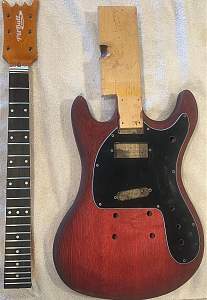

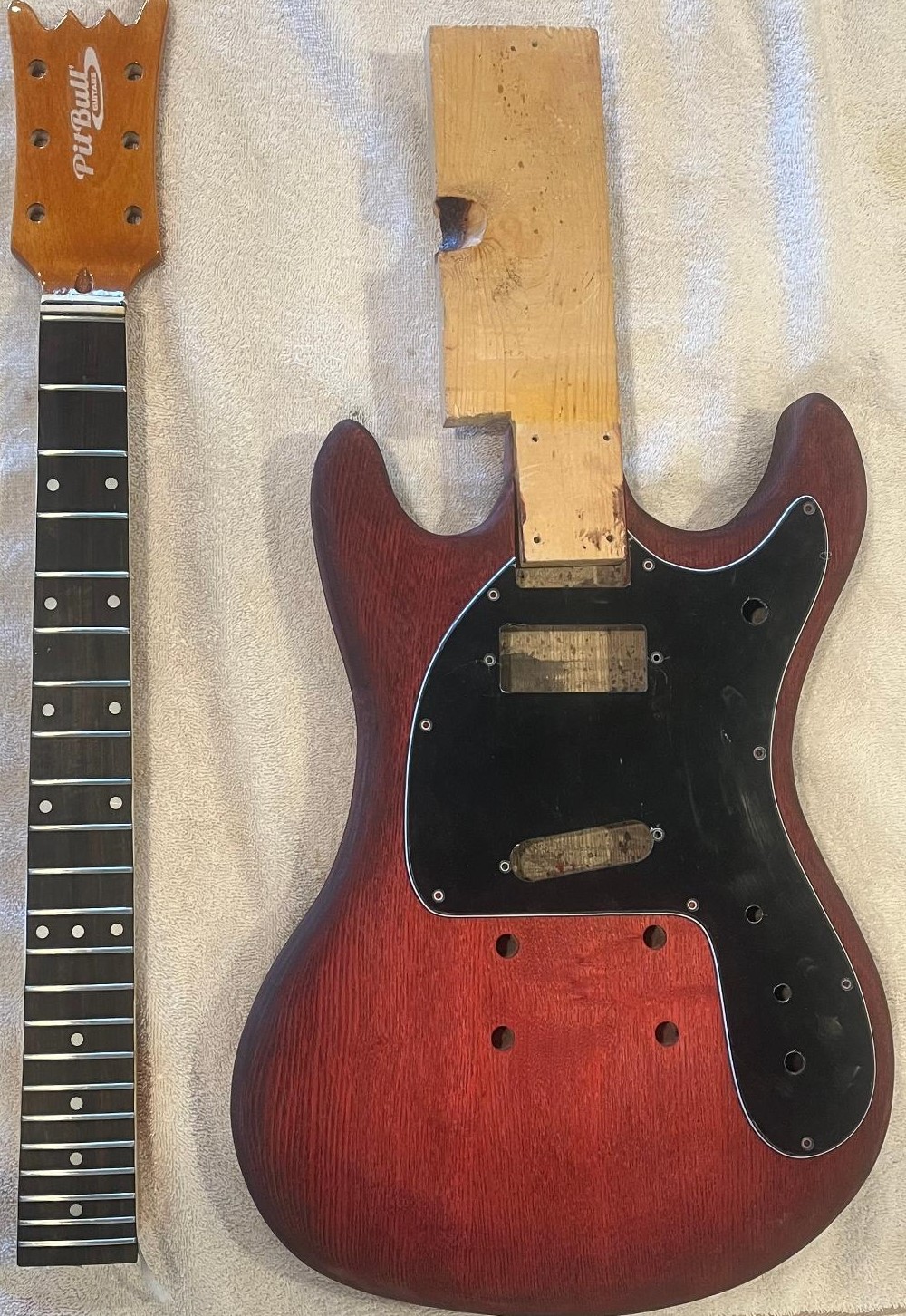

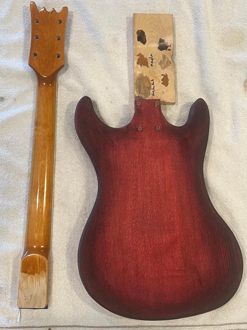

    So this is the direction we're going. Unfortunately, my expectations usually far exceed my abilities. Nevertheless. RIT dye wine/black fading to wine fading to Colortone cherry. Plan to clear coat with Minwax Wipe-On Poly, after a thin coat of rattle-can spray poly to try to avoid smearing the dye. The neck is stained maple, then about 24 coats of TruOil. Fretboard will get lemon oil. Click image for larger version.
Name:	Burst 1 (2).jpg
ID:	42880Click image for larger version.
    Tru Oiled neck looks good. 24 has been my "magic number" (or at least my minimum). Probably end up closer to 28 or 30 because I regularly forget to write down my tally so just do another coat for good measure and start counting from there!
    Good idea to spray and lock in that colour on the body too! Should look great with some gloss on there!

    Thanks, McCreed. A very light and fine sanding of the neck leaves a kind of matte-looking finish, and a nice feel. After the TruOil was well cured, I attacked the headstock with Meguiars Compound and Polish, and wow! I really like the depth and gloss that it shows. Put about 5 coats of MinWax wipe-on poly on the body using a foam brush, then wiping off the excess after about 5 minutes. The foam brush leaves a lot of bubbles, so a final couple of coats were applied with cotton cloth. That will cure for a week while we head for the canyons of southern Utah for an annual hiking trip. Then, Meguiars and start the assembly. Photos to follow then.
