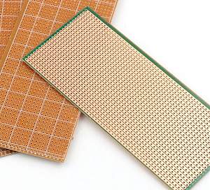

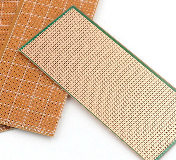

    PPA and DIYGP don't sell stripboard though. Jaycar do, and it's on eBay. Make sure you get the boards with parallel copper tracks, not the perfboard that has tinned holes but no tracks. This is the right board:

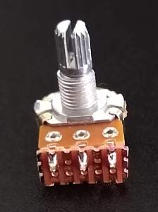

    Keep your stripboard offcuts:
    They are handy for making adapters for PCB-mounted pots, allowing them to be used off the main board:

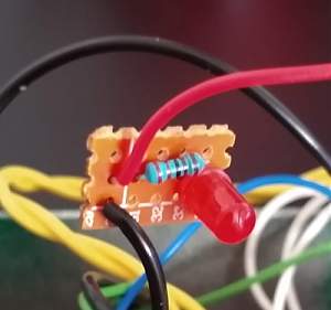

    Also handy for making little boards for the power indicator LED and current limiting resistor if you don't like wiring it point to point:
