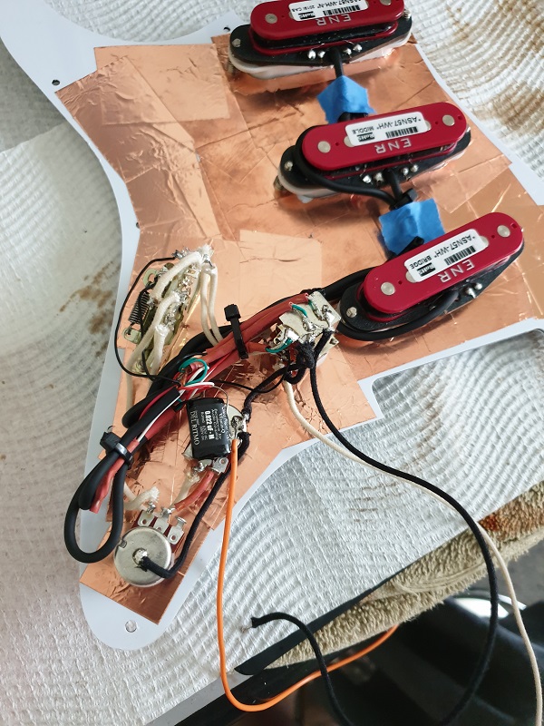

    Good advice from Simon. I noticed that with the shielding tape also, but didn't address it.
    I def concur with Simon about that type of factory p/g shielding. On more recent import p/g's the material is more like a "metallic paper" sticker. IME if it has a flat/matte finish to it, it's generally rubbish and poor conductivity. The shiny "foil-like" material is a bit better, but I use quality copper tape with conductive adhesive, and go right over the factory stuff just because.
    It's about 2 minutes more work and costs me about 30 cents worth of tape. Good insurance at that rate.
    Also worth noting, when you shield the cavities, be sure and run a little bit up over the edge of the route (at least in a 2-3 places) so there's connectivity between the cavity shield and the p/g shield. (sorry if I telling what you already know )

    I looked at the pick guard and yeah....I think Simon and McCreed have a good idea. I will take the switch and pots off and run the tape down over the area covered by the silver paper.
    I am aware of making the route copper tape come up and over the edges and touch the pick guard copper tape....thanks for the keen eyes though you guys.

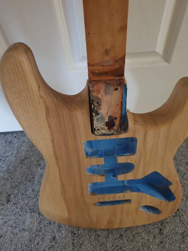

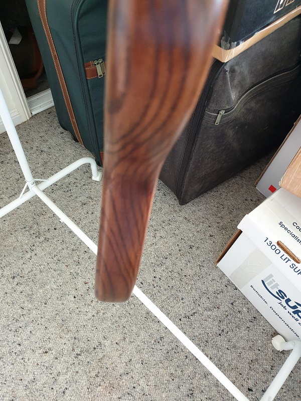

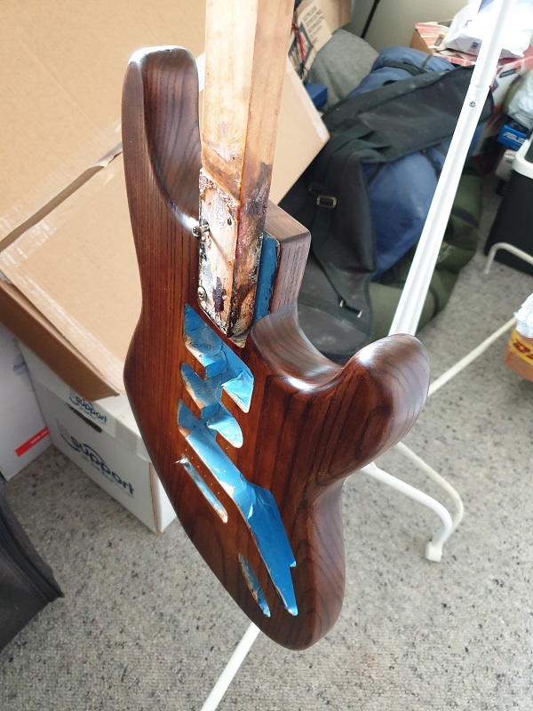

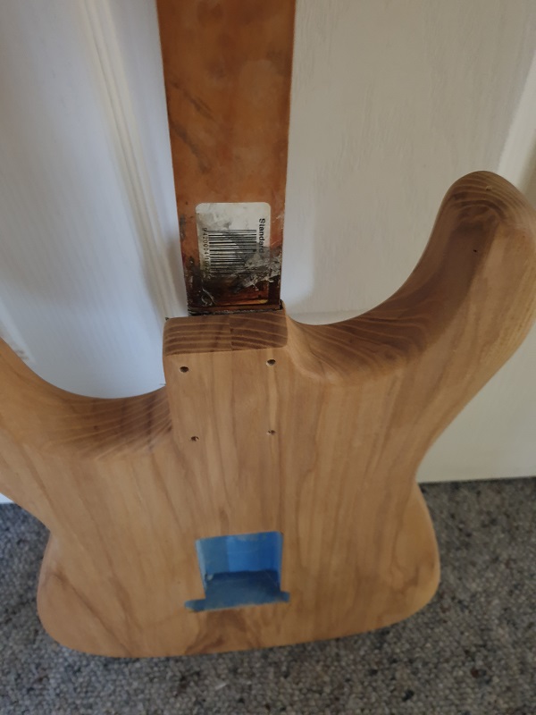

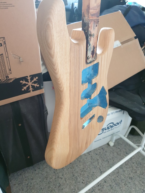

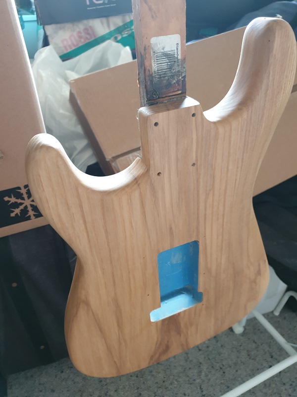

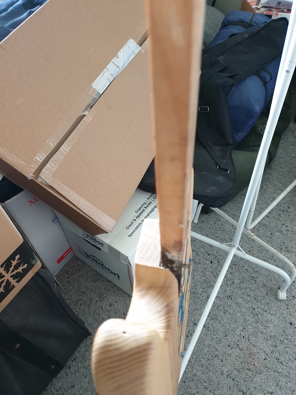

    Okay....I made some time and took a few piccies.
    Packing my gear...grabbed my phone.
    The body looks some much more amber than the photos show.....so the last two are taken in a hallway away from light.
    I like the grain...it tells many stories about the life of the tree that made this wood.
ID:	33126   Click image for larger version.
ID:	33127   Click image for larger version.
ID:	33128   Click image for larger version.
ID:	33129   Click image for larger version.

    Home now.....washing on.....showered.....got the pickguard and the copper tape.....all done with copper tape now. Under the switch plate and the pots all nice and shiny copper.

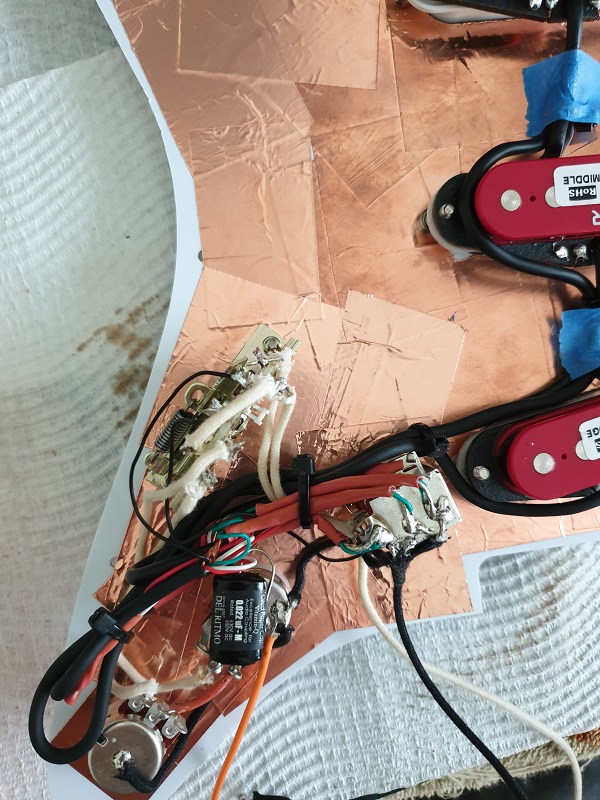

    The copper tape is in the house.
    Here she is all nice and taped....conductive adhesive on tape....nice.
ID:	33188   Click image for larger version.

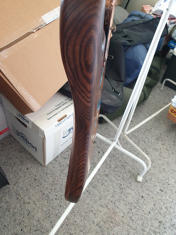

    Stained this morning....
    I went pretty dark on the three colours this morning as the last build had the steel wool pulling lots of colour out of the stain.
    Hopefully this time the Fine Buffing Oil in steel wool will leave me some colour.
    Golden Teak in the middle....Jarrah around that and Japan Brown around the edge and along the sides.
ID:	33190   Click image for larger version.

    One coat of stain with a coarse grade of steel wool.
    One coat of Fine Buffing Oil....I see one place that the steel wool jumped through the stain....bugger.
ID:	33192   Click image for larger version.
ID:	33193   Click image for larger version.
ID:	33194   Click image for larger version.
ID:	33195   Click image for larger version.
