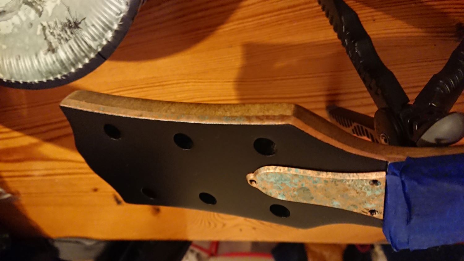

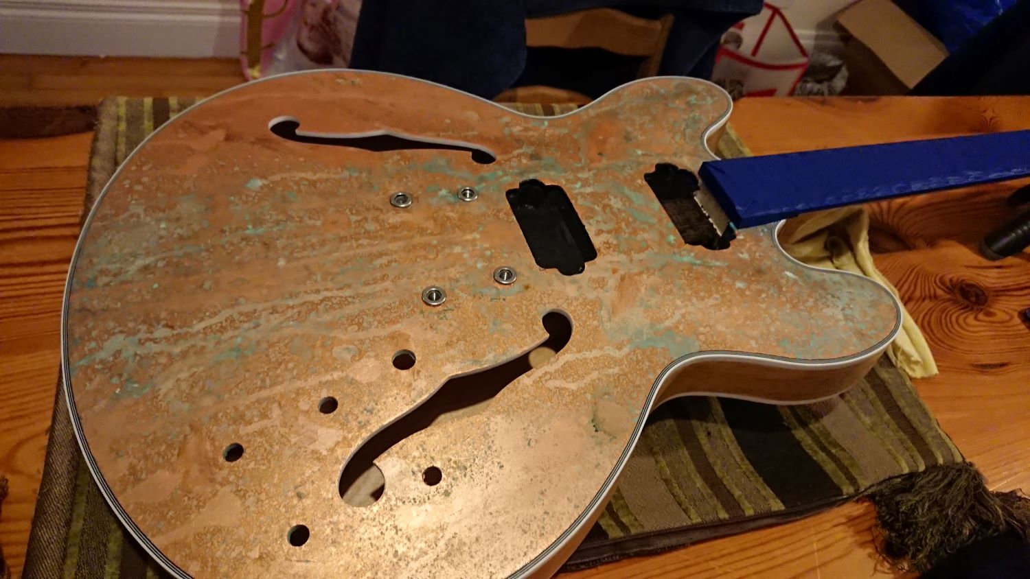

    So where did we leave off... Oh yes the neck had just been glued and it seems to be holding well since the clamp was removed. All copper work completed and the second round of tarnishing finished. Really happy with the results again this time. Less tarnishing on the 'wings' as forearm would keep the upper clean and hands fiddling with control knobs would keep the lower clean. Added a couple of quick coats of clear satin in a cold shed with the aide of a gas heater to heat the surface and a tub of scalding water to heat the aerosol paint and no milky bloom. Lacquer was drying as it was contacting with the surface which is a nice way to get a good finish in less than ideal temperature conditions - snow falling outside. Only did the headstock and copper top of the guitar.Was the only way I could see that I could stop the tarnishing and protect the surfaces while other jobs continued. Will need to get in somewhere warmer to spray up the rest with lacquer once I get off work for the holidays.

    Agree with the forearm keeping the upper bout clean(ish) but strictly speaking, acidic sweat on the fingers would tend to corrode the area around the knobs more than normal. You'd want to have the area that would be under the knobs a lot clearer than the area around them.
    But it does look good regardless.

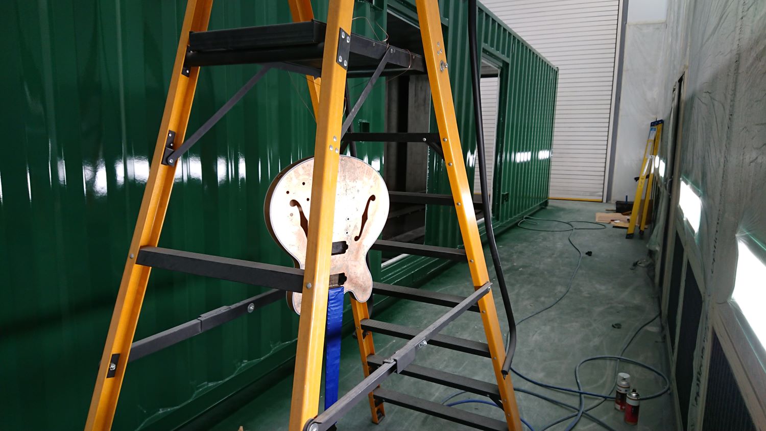

    That lightbulb moment when you remember there is a heated spray booth at work... 1 slightly extended lunch break later the guitar has 4 more coats of clear satin lacquer on it, my eyelashes are stuck together and i'll need no hair gel for at least a week. Result.
    Now to let it cure for a few weeks so I will have to start work on tidying up the fretboard, levelling and dressing frets, rolling the fretboard edges and wiring the harness.
