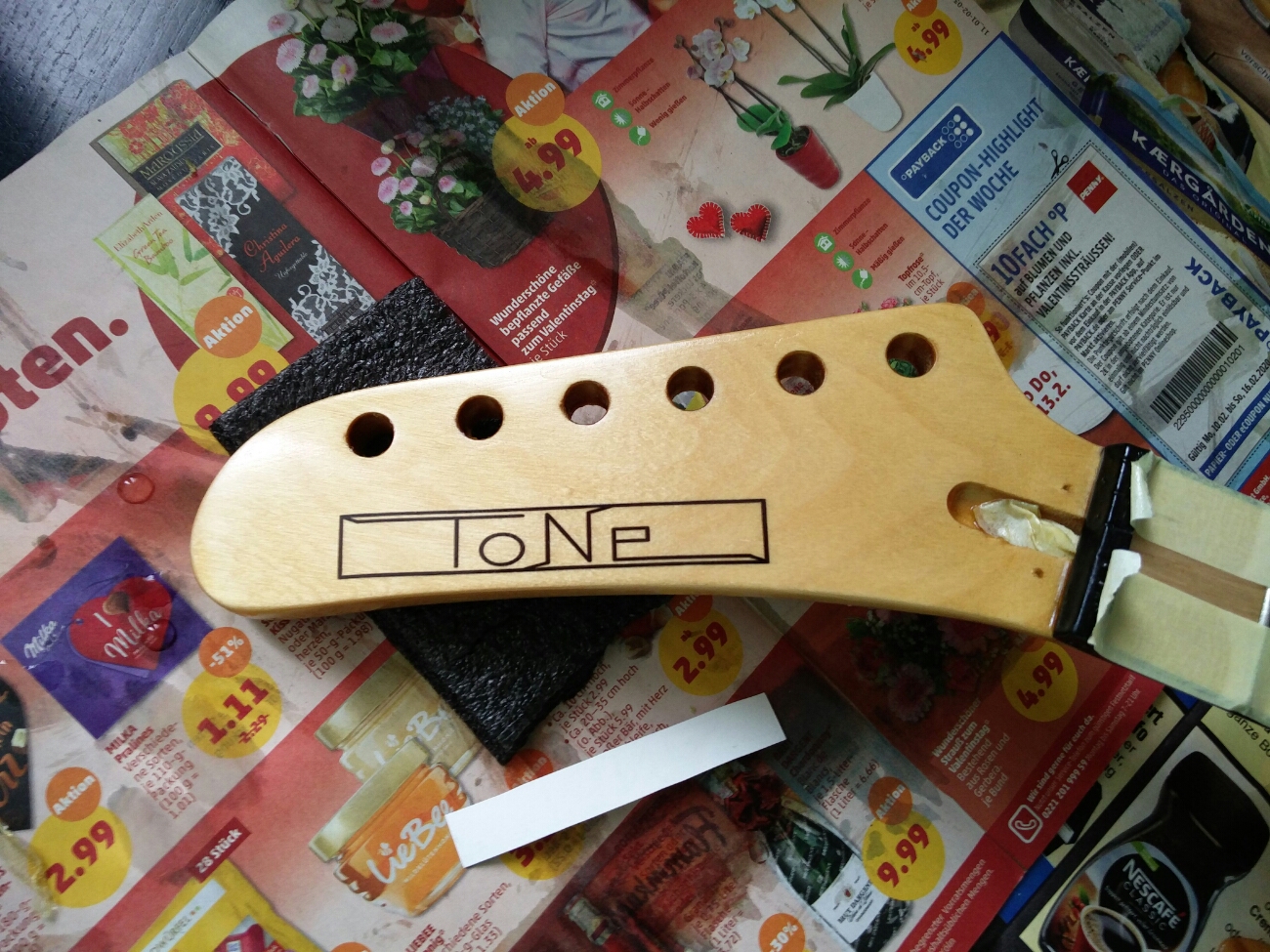

    I have decided on a logo and already printed it on waterslide decal paper. This weekend I should be able to present it to you already!

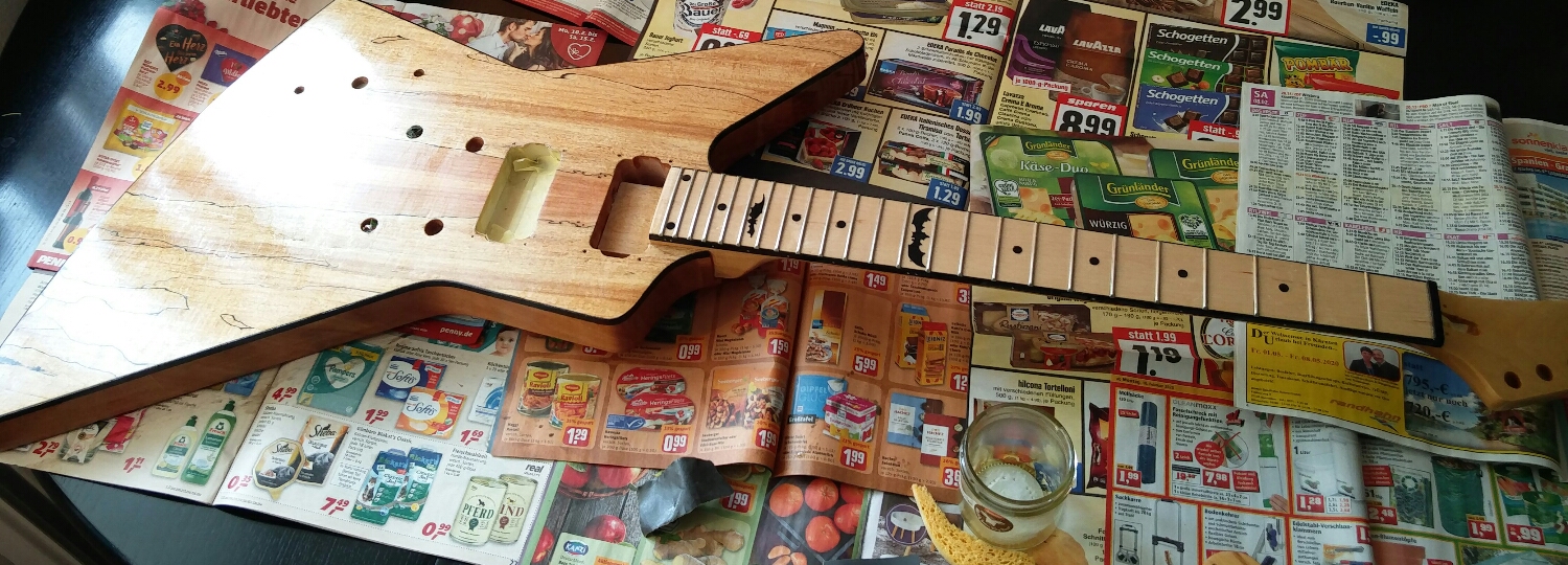

    For now I have changed my method of tru oil application again. I had great results with wet sanding and using the oil as lubricant. Then of course I could only do one side at a time. With the guitar laying, runs don't happen that easily and I applied some nice coats afterwards. The spalted maple veneer is now filled and almost flat everywhere -> I should be done soonish! and I should - it has been 16 more coats already. I can't wait to put it all together.

    As promised, here's the attached waterslide decal. I'm very pleased with how it turned out, there's no visible border and after one coat of tru oil there's nothing else standing out than the ink. perfect! thank you for the suggestion.

    Other than that, the spalted maple veneer is now almost all filled with tru oil and I hope that I will get done with applying the oil this week. And then I will need a lot of patience before the final polish and doing the electronics.
