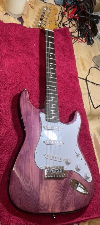

  7. #36
    Mentor DarkMark's Avatar
    Sep 2017
    1,571
    Anyhow, went back to the store and purchased the last box of copper tape to finish it off. Soldered it all together, multi meter confirms it’s all joined up.
  8. #37
    Sep 2017
    1,571
    Finished in a personal best record time. It’s been a fun kit to build. I don’t know what it would have been like without the shielding, but the only noise I hear is a very quiet hum if the volume pot is dialled to 10. All that’s left to do is to set up the action, intonation and then it will be ready to give away. I never knew I wanted a purple strat in my life, but I kind of like it. After all, I don’t have any single coil guitars. Happy building, folks!
