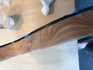

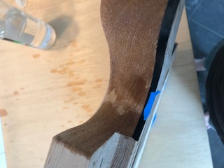

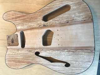

    Used metho today to check the splalt, back and sides for glue - not too bad - spalt front looks clean with only a few spots on the sides to be addressed with some sparingly use goof off. The blue tape is just a flag for where to remove glue.
    I have completed a 2 passes on the goof off and think I have the glue residue off the sides. There is still a touch near the neck pocket/binding interface to be addressed though. I will check it again once its had the pre grain-fill sanding.

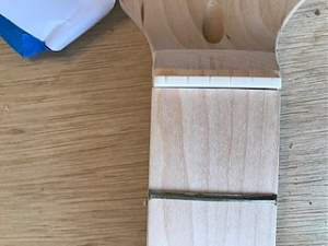

    1. I removed the plastic nut and the new bone upgrade on test fit is quite loose in comparison (see pic there is a gap between fretboard and nut) - is this a problem and can it be addressed or is the nut wrong?
    Not an uncommon issue. Fretboard nut slots and nuts can vary. Especially with kit stuff as a lot of it is done by hand (not CNC).
    First, I would make sure the slot is correctly perpendicular to the fret board. I can't tell if the nut is crooked in the slot or if the slot is crooked.
    I would also re-check the measurement from the middle of the 12th fret to the fretboard edge of the slot (or the nut). The nut can be shimmed, typically on the tuner side, but can be shimmed on the fretboard side if the 12th fret distance is short. Hopefully that makes sense.
    (If the 12th fret distance is good, just shim on the tuner side.)
    I use wood veneer for this kind of shim. You will likely need to thin down the veneer by sanding or scraping to get it to the right thickness. It (the nut) doesn't need to be super super tight, just snug enough that the nut isn't sloppy. The nut will be glued in later anyway.
    I keep a range of different wood veneer types on hand so I can match the fretboard colour as much as possible. I've used pine for maple fretboards before and that blends pretty well. Maple veneer would be an obvious choice, but the cabinet maker I get my veneer from didn't have any.

    You can of course ask for a replacement bone nut that fits. If Pit Bull sell it as a replacement for the kit nut, they should make sure that it's wide enough. Over-wide is OK as you can sand it down, but too thin simply isn't right. Or get a refund and buy a bone nut from the web. You do have to check for the thickness but you can normally find them in different widths, heights and thicknesses, so I'd measure your original kit nut with some digital callipers and send Pit Bull the dimensions.
    I know you can, but you shouldn't have to shim behind the nut.
    I won't argue with that, however one of the guitars I needed to shim was my PBG TLA-1. That was a case of a poorly cut nut slot. It actually had a taper on one side and I had to taper the shim accordingly.
    The fretboard edge of the slot was parallel to the frets, so it didn't effect scale length or angle of the nut, but the gap on tuner side was just filled in with glue. A pretty crap way of covering pretty crap workmanship. This is why I queried whether the slot was square.
    I have encountered other necks that did not have a 3.4mm (1/8") nut slot typical of Fender strats and teles and had to make nuts from blanks to suit. Standard pre-cut replacements were just too narrow.
    If I were doing the TLA-1 today, I would probably re-cut the slot so it was even and cut a suitable nut from a blank, but for a first-time builder, shimming seemed like a better solution than cutting a new custom size nut.
    I've only had to use one bone blank to replace a stock nut IIRC. I can normally find quite a wide range of sizes on line. But it would be nice if the kits used a standard Fender width nut though (add it to the long list of things I wish the kits had/did better).

    Side and rear grain filled with timbermate slurry and sanded back to 240 grit. There are 1 or 2 spots need additional fill and sand then I should be good to stain the rear.

    On the loose bone nut PB will credit me for it - seems weird that the nuts they supply for a Fender build dont fit the nut slot
