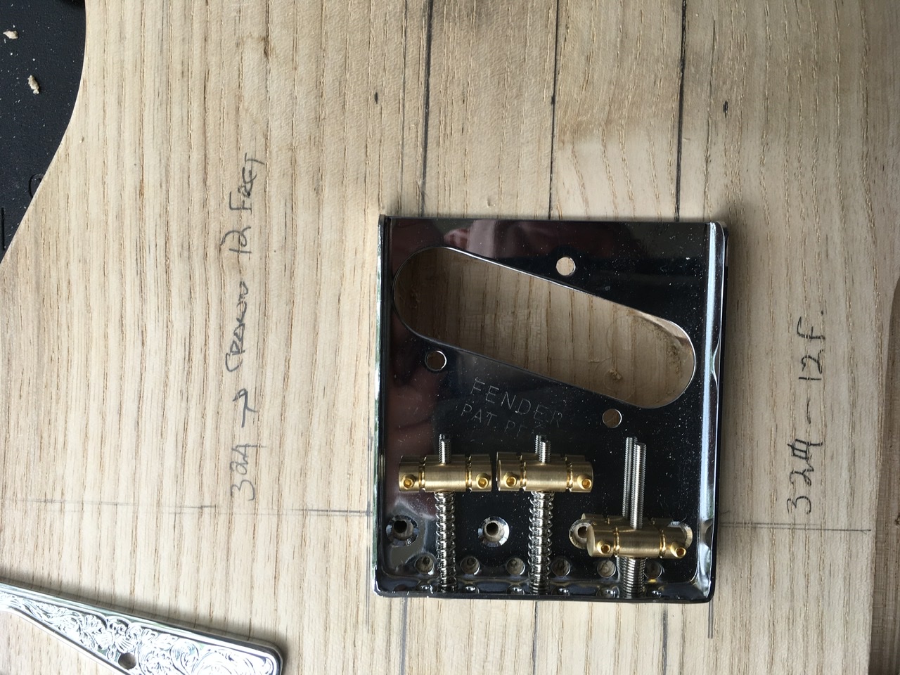

    I drilled the holes for the bridge. I remeasured the scale length and made sure the holes were at the right place before drilling.

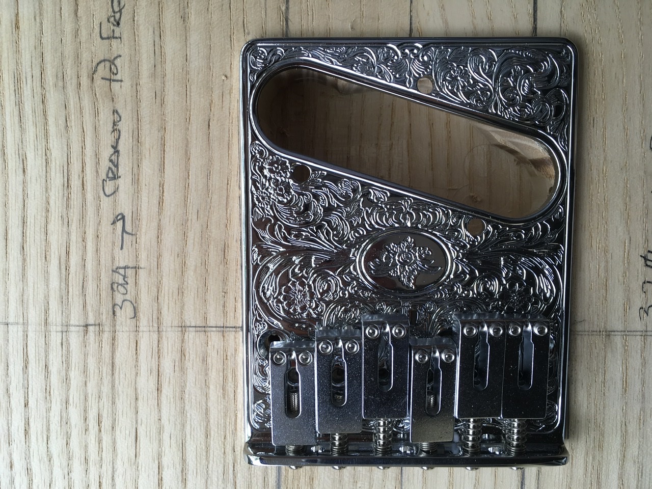

    When the bridge is in place I made sure the bass e string saddle was in full rear position and treble e string saddle in full forward position.
    Like this.
    With the bridge saddles in those positions, I measured with a micrometer, the distance from scale line to each saddle position. The bass e string was 4.4 mm back from scale line. The treble e string was 4.2 mm forward of scale line. Pretty centred, basically.

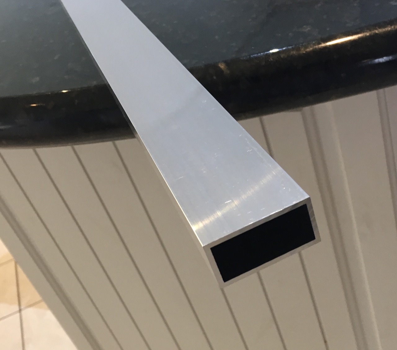

    Over thinking? Maybe...over engineering...nah.
    This is my thinking for setting up a drill jig for the string through holes.
    Have bought a rectangular aluminium tube. 20mm x 40mm
    Like this.
    Drill my 6 string through holes in the 40mm (the longer side...so actually through the 20 mm side but 40mm deep...does that make sense?) using the drill press, so nice and vertical..and clamp it and the body together and drill the body (using the handheld drill through the jig) about half way.
    Drill through the 6 string through holes using the drill press in the 20mm ( so 20 mm depth but the holes will be on the 40mm side but the shallower depth)and then drill with handheld and narrow side jig to get the holes close to the back of the body (but not all the way through).
    Drill the outside holes gently, all the way through, flip the guitar body over.
    Use dowel to locate the 2 outside holes to the 20 mm side holes and drill through the other 4, using the short side jig.
    Next step is to drill out the 6 holes on the 20 mm side of the jig to the string ferrule width and hand drill the body again, starting from the outside (then using thicker dowels to secure the jig) and drill out all ferrules.
    I will do photos so this makes more sense when I drill tomorrow.
    Easy...right?
    Tomorrow’s job.
    The aluminium tube cost $9, instead of fancy drill guides.
    Winning!

    Most jigs I've seen are simply made out of a block of hardwood, and since you have a drill press, making an accurate jig should be easy. I had a hard time following your written process, but I'm tired and maybe a bit slow...
    There are probably a dozen ways to accomplish the same thing. However, the part about drilling the two outside holes all the way through and using those to set the jig is the way to go.
