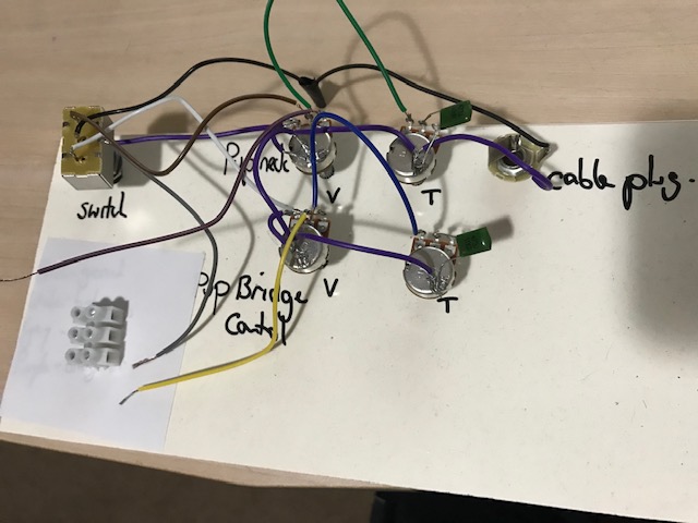

    Quick question. Following the PBG wiring diagram for 2 humbuckers, 4 pots and a 3-way, it looks like it will put the volume knobs on the outside, tone knobs inside in line with the 3-way and output. Is there any convention on this, an preferred way, or a matter of personal preference?
  6. #36
    2,038
    Hi XP Rider,
    I don't look at the wiring diagram as being diagrammatically correct - I just follow the wire links. On the Pitbull diagram the 3-way switch does appear to be on the wrong side (and should be on the pup side of the diagram). I definitely have the volumes on the inside and the tones on the outside.
    The picture below shows my circuit for the AG-2 kit (I will use the terminal strip to join the pups without any soldering (just my weird way)). This is also the wiring setup for my FBM-1.

    Thanks a bunch. I hope that gives me what I need. I've printed both photos, and am trying to decipher, lots of dark wires and also shadows. I'll see what I can do. Seems like the main thing is to have power to the points that need power, and ground to the points that need grounding.

    Dang lot of intense soldering, and too many places for mistakes and bad connections.
    Next question - the lugs on the volume pots are not long enough to fold back onto the ground, as shown in most diagrams (Seymour Duncan shows them soldered). Is that a problem?
  9. #39
    Using a short length of wire to link the ground lug to the back of the pot is standard practise for shorter lugs, and is commonly used even when the lugs are long enough. Either use some stripped insulated wire or, more often, the stiff leg off-cuts from capacitors or resistors.
    You need that lug connected to ground for the volume pot to work correctly, otherwise it will not turn the volume down fully.
