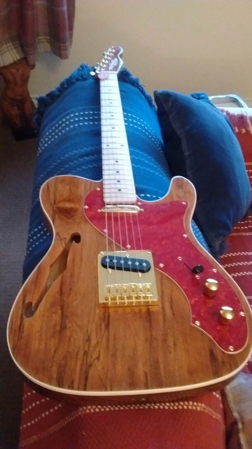

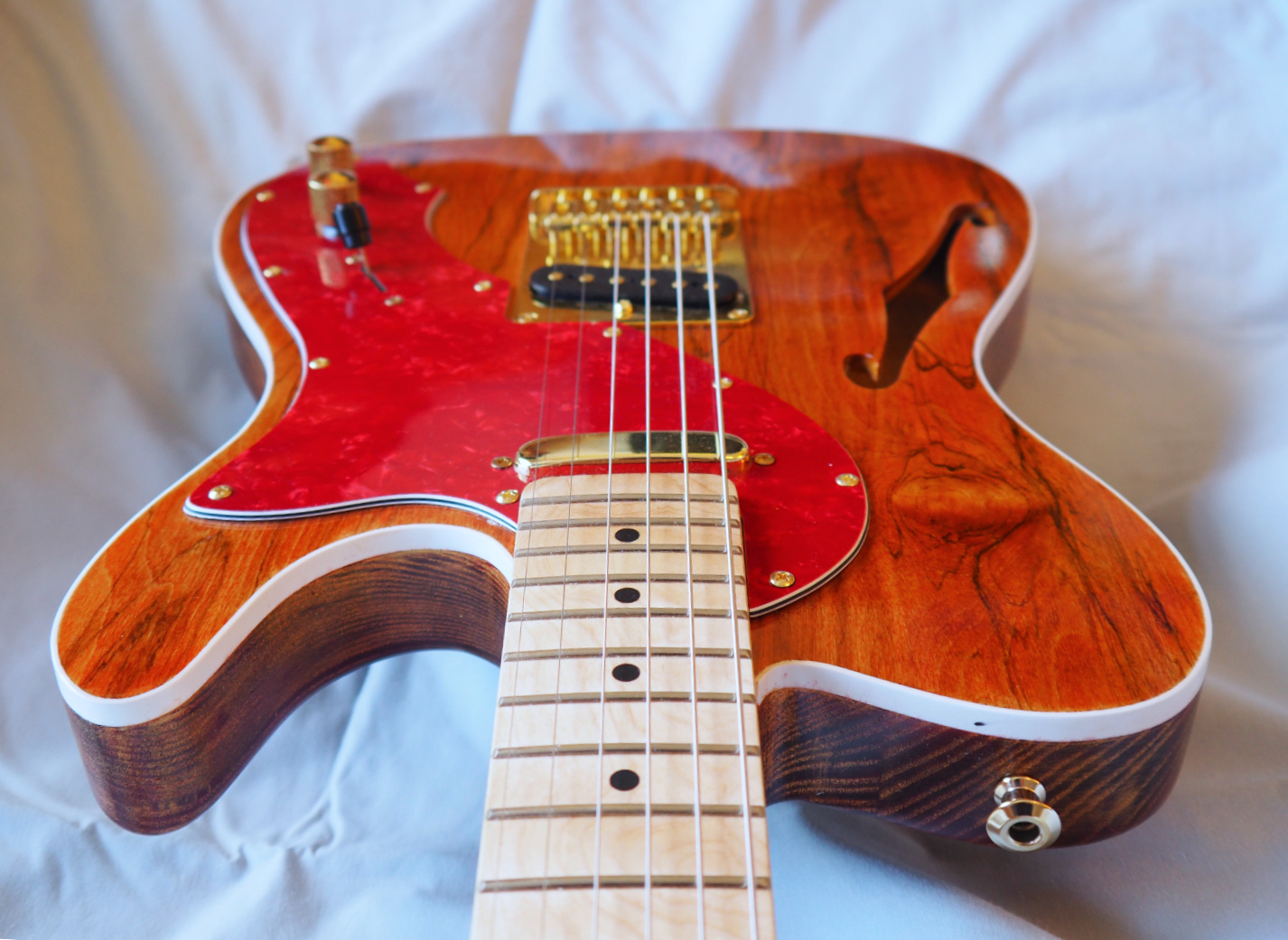

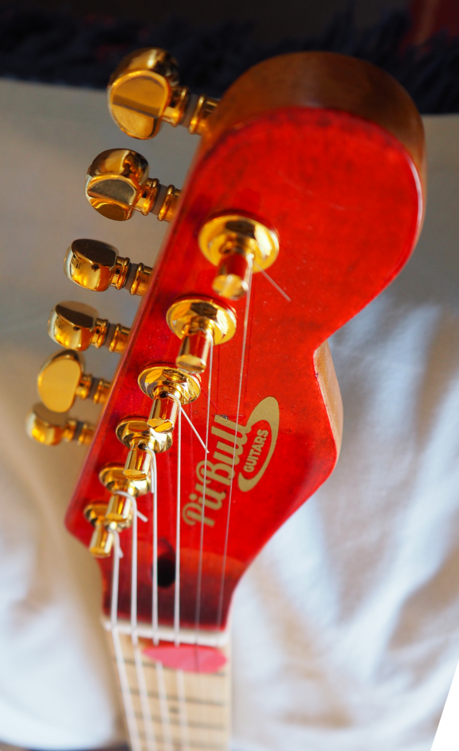

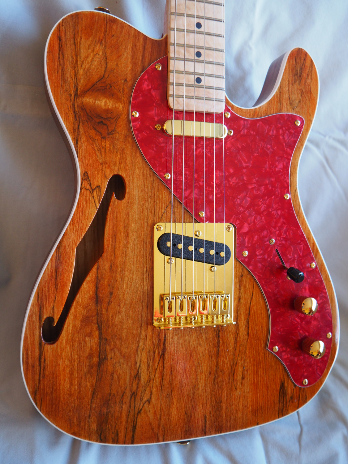

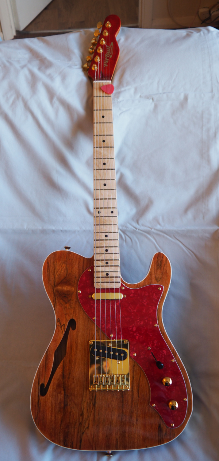

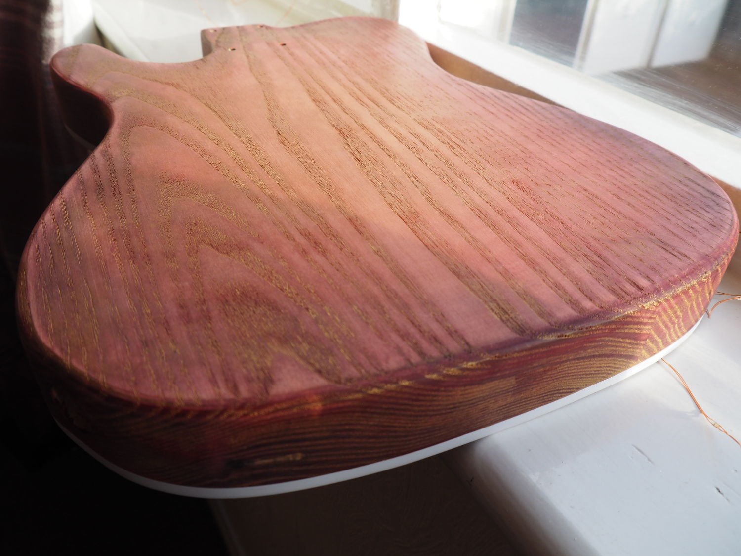

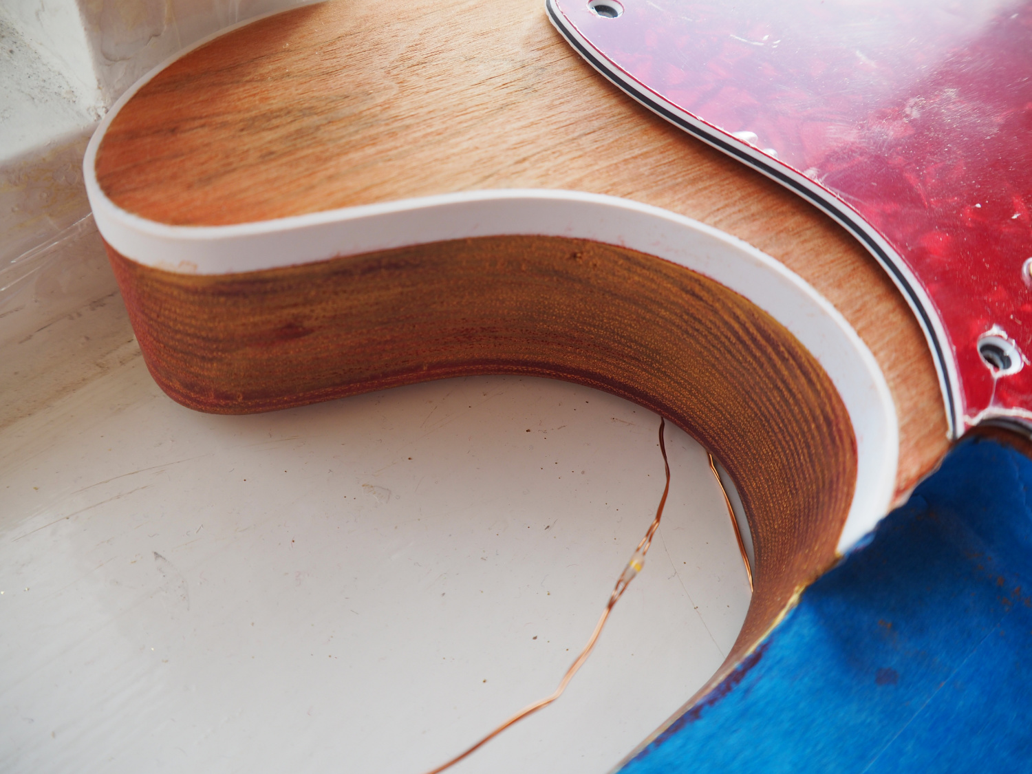

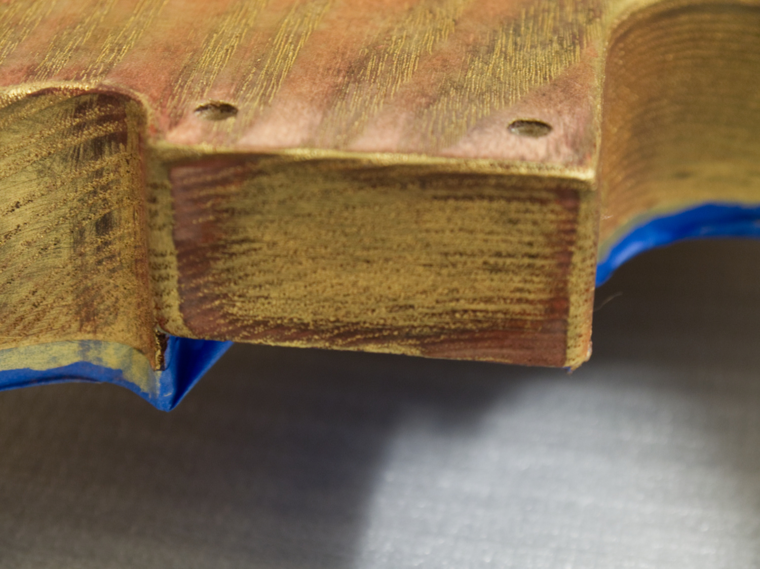

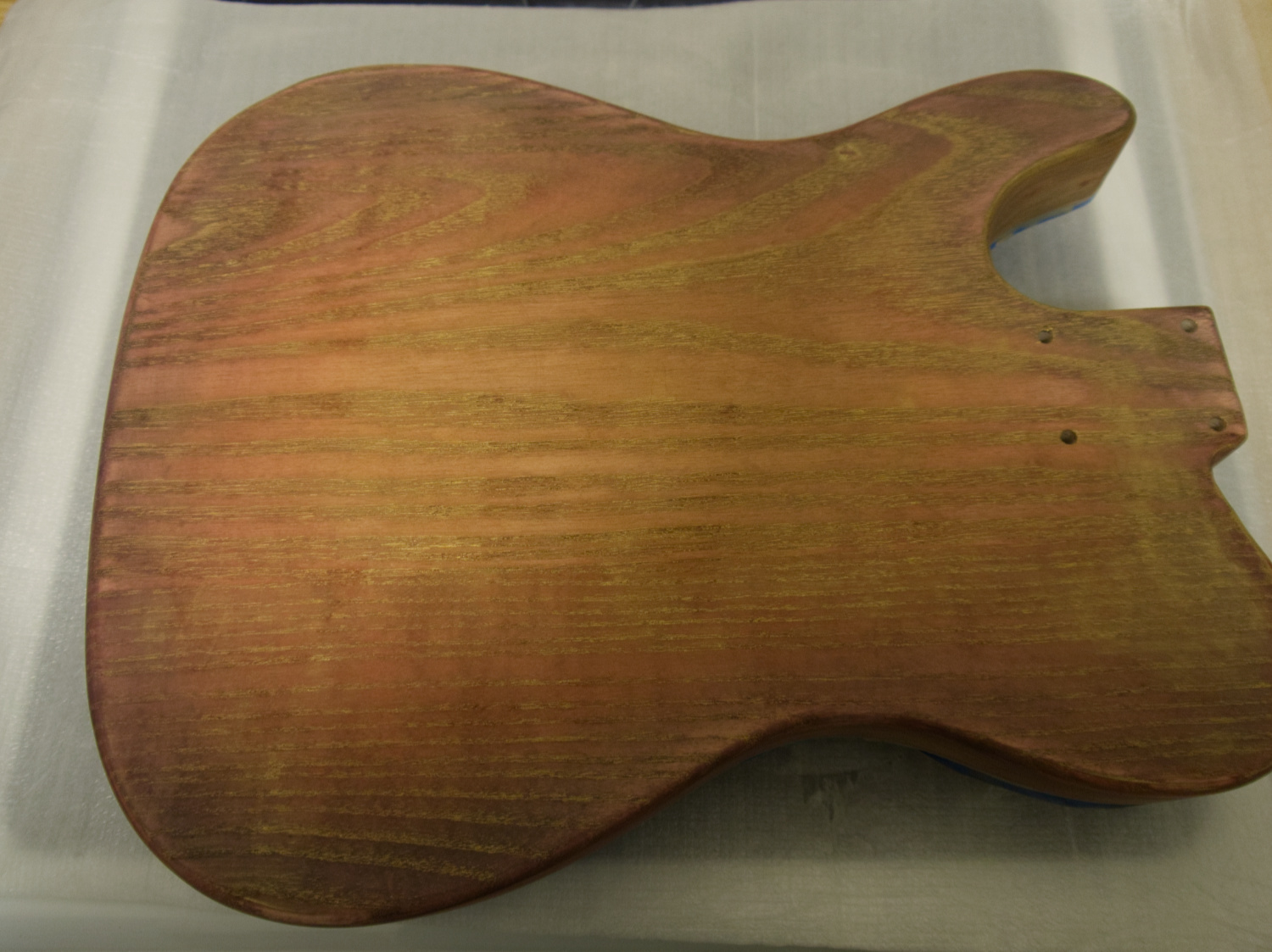

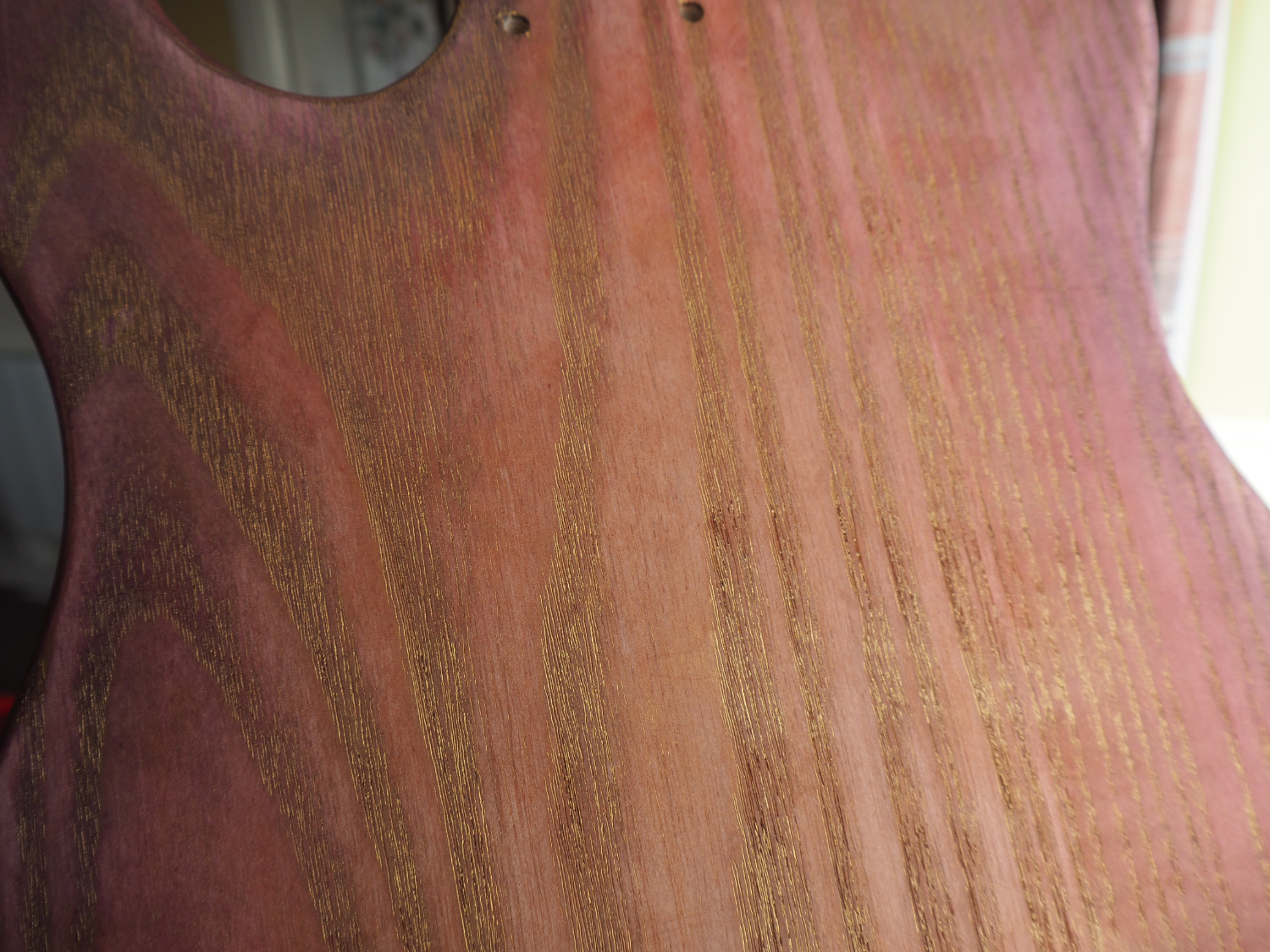

    Well here we go, first time building/assembling a guitar so I am looking forward to this.
    I am more of an acoustic man but have a couple of semi's (Hofner Thinline John Stowell
    and an Ibanez fretless bass).
    Have always fancied a Tele and this looked like an unusual way to go about getting one.
    I have checked the contents of the box which arrived in the UK only a week after
    it was ordered. Most impressed.
    I had looked at doing this with locally (UK) purchased parts but would be looking at £500 for this
    sort of build compared to £250 from Pitbull which included Grover tuners and £90 odd of VAT,
    taxes and delivery.
    I particularly liked the spalted maple veneer.

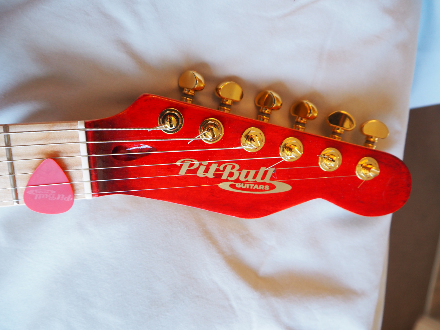

    Observations from the unpacking:
    1) General impressions are the body and neck are very well made.
    The fret ends are sharp so I guess they will need to be filed down.
    Can anyone suggest a suitable type of file that won't break the bank ?
    2) The nut is fitted poorly, and overhangs on the top E side.
    A bone nut was ordered and consequently the factory fitted one will get the elbow.
    3) Bridge - I am a bit confused with this, will I have to drill holes through the body
    for the strings and if so, can anyone suggest what ferrules to fit ?
    4) There is a gap between the bridge and pickup guard, I thought that they would
    fit joining each other but perhaps I am wrong (and ought to go into my local
    music store to have a look at Teles haha)
    5) The neck is quite a loose fit in the pocket, the photos might have captured this.
    I am hoping that once finish etc has gone on the wood things will tighten up a bit.
    6) No sign of string trees but I can get these quite cheaply via ebay if needed.
    As to finish I intend to use Crimson water based stains, amber, red and black in a sort
    of sunburst effect with their gold filler in the cracks (don't laugh).
    I may also stain the headstock black but who knows....
    Would want to pop the spalted maple if i can and the finish will be Crimson's hi-gloss
    finishing oil. Got to use smell friendly condiments as I shall be doing this inside during
    the winter.
    I have got some maple veneer to do some testing on so that will be my first task.
    Got a few more photos to post but it looks as if 5 at a time is the order of the day.
    Thanks for looking ! Cheers, FB.
