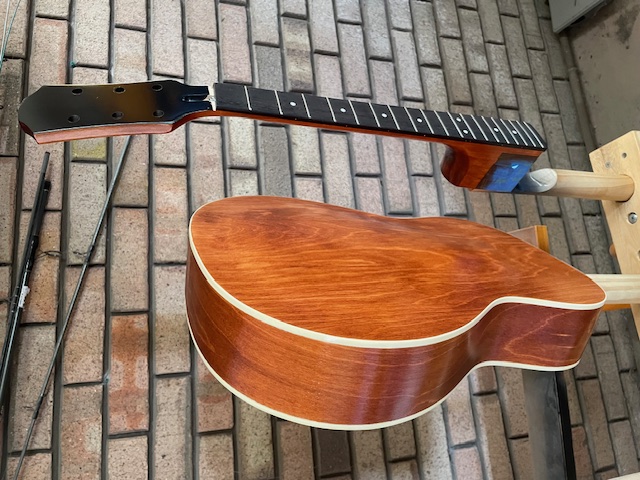

    I forgot to share that I had sprayed the front of the headstock with mtn94 black around the time I added the tru-oil. Both the paint and the Tru-oil have had time to gas-off.
    Today I have sprayed on 4 coats of Cabots water-based gloss poly.
    I will leave it for about a week, then add a brown burst around the front, and add more clear coats.

    Work and weather have slowed my progress on this build. But, I have added a logo to the headstock and yesterday managed to add a few coats of Cabot's water-based satin poly to the body and neck.
    I think I will forgo the burst. I'm worried about being able to clean the binding after, and also that taping the binding will result in lifting/damaging the clear coats. I should have done the burst immediately after the stain coat!
    I have also picked up some open back Grover tuners (98 series), with the push in bushings.

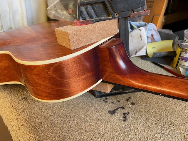

    The neck is now glued in! There was a tiny gap on the lower side of the neck, which has been filled with some CA glue.

    Thanks fender 3x. And yes, string intonation does get a bit weird! I have a Fender acoustic - definitely not 648 scale! The high e comes in around 642 mm! I assume it is intonated correctly - maybe I will check.
    Today I have stained the body and neck with FW jarrah stain, diluted to 33%. The binding was taped beforehand, but some stain seeped under the tape.
    Then spent a while scraping the binding! Not my favorite job. I used a safety razor blade clamped in a short length of dowel jig.
    Then gave it all 2 brushed on coats of wipe-on-poly.
    I love your idea about the razor blade clamp for scraping the binding! I've always done it by hand using my fingers as the clamp... I think your idea would be more accurate. I'll be doing that on my next build! Thanks!
