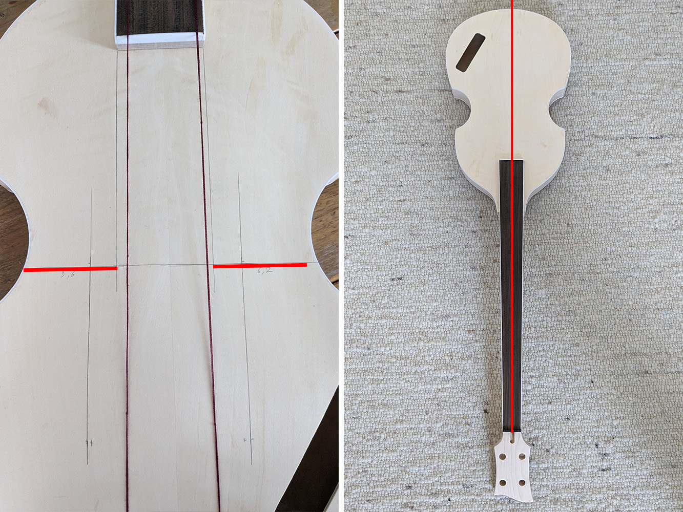

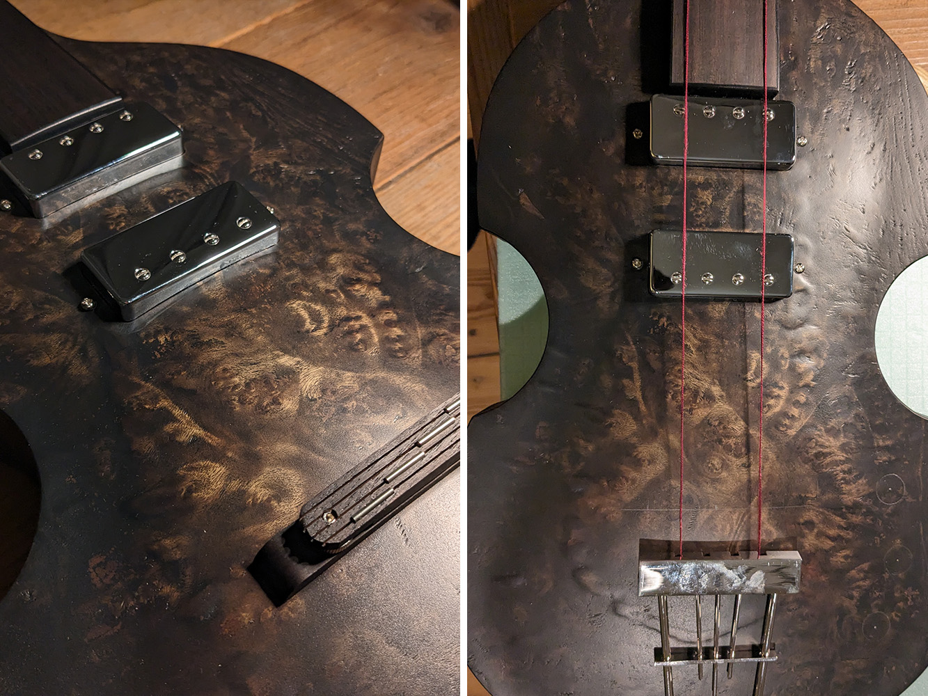

The kit is fine beside the neck/neckpocket...the neck aligment to the body is not centered when you put the neck into the pocket...It is going about 5 mm to the upper edge of the body, so you dont get a straight line following the neckline to the centre of the body...Not sure how to fix it with a hollow body that might become difficult...I suppose I have to sand quiet a lot of the necksides to get the right angle...and then fix it with glue and veneer to keep it in the right shape...lets see

What I really can not understand about the Hoefner Basses is the control pannel which is esthetically a nightmare in my eyes Suppose it is part of the history, did not get much into this honestly, but I just can not keep it like that...
I am not sure if I can reproduce the electronics, but in the end it could also be a switch for the humbuckers, and two volumes and one mastertone.
I want to close the cavity and veneer the Bass with some burl...I simulated how it should become if I color it with shades of black, keeping the burl slightly visible...overall the look of black and chrome and maybe a bit of white from binding...But making it white could also be an option, then I will use some smoother and calmer veneer I think...

Any comments are welcomed
