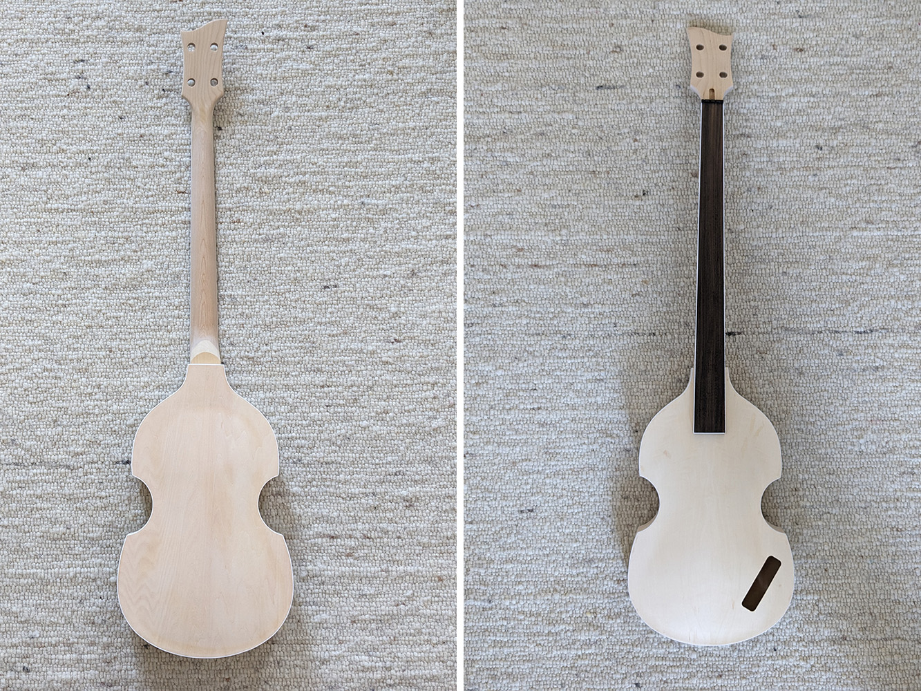

    For this custom kit was on sale and I liked the fretless version, I wanted to try it out...

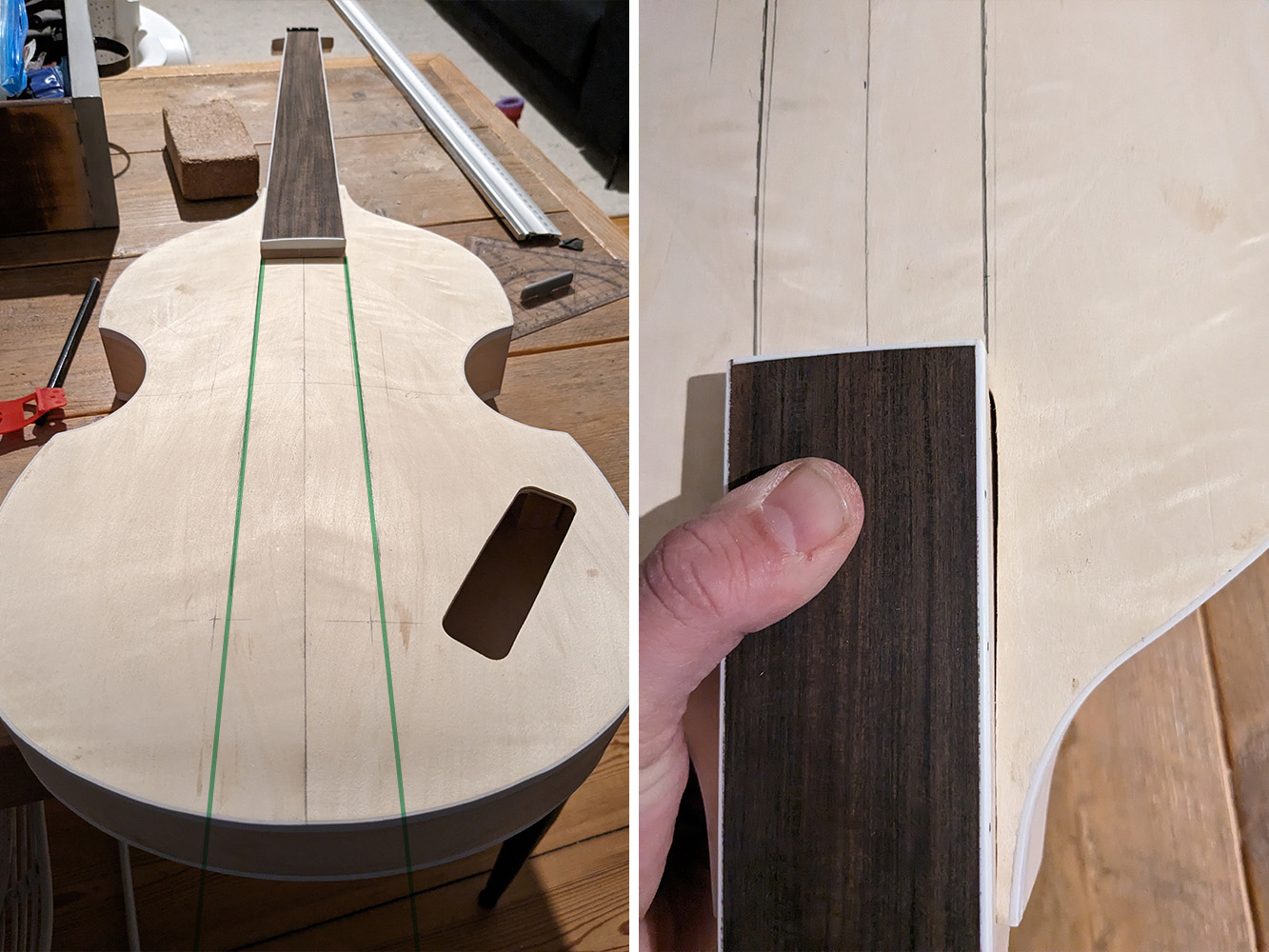

    The kit is fine beside the neck/neckpocket...the neck aligment to the body is not centered when you put the neck into the pocket...It is going about 5 mm to the upper edge of the body, so you dont get a straight line following the neckline to the centre of the body...Not sure how to fix it with a hollow body that might become difficult...I suppose I have to sand quiet a lot of the necksides to get the right angle...and then fix it with glue and veneer to keep it in the right shape...lets see

    It will be interesting to see how you deal with the control plate.
    With regard to the centerline offset, I had something similar to it on the bass in my avatar. I made things line up with the neck, rather than the centerline of the bass. You could fix it, as you have suggested, but it will be a ton of work to get it to line up just right. You could just line up the tailpiece and bridge with where the red line is in your pic. Since you haven't got pickup cavities, you could cut to line up with the red line as well. It doesn't look like it's off enough for anyone but you to notice, or to effect play-ability.
    Then, of course, there is the old "whack it" trick. If you put the neck in the slot and give it a good whack on the treble side of the headstock it may move a little toward the centerline.

    Yeah, I am curious about how it will become, too 🙂 Have to check your bass build Fender3x...
    For the electronics I will have to open the back of the body, making a small cavity to be able to place the potis...a bit not sure, if this affects the resonance of the body by making holes...have no idea how it influences the sound...
    I am still thinking, how it could work with the center line...I think it will be noticeable, for those are about 6 mm difference...
    Now I consider doing something with the neck pocket, instead of the neck, but there is not much material with the thin hollow body to experiment...well it is a challenge 🙂

    I had a similar issue with my hb-4. I set up the tail piece bang in the centre of the body, and then when I put strings on discovered the strings were off line with the neck. I solved the issue by moving the tail piece The amount I had to move it meant that the tail piece covered the original holes.
    3,062
    Quote Originally Posted by Rabbit View Post
    This is a more concise way of saying what I was trying to say...
    Mine was off far enough that I had to add a small piece of maple to the one side of the neck to get it to look right. I should mention that the piece is purely cosmetic. It didn't do anything to adjust the angle of the neck.
    https://www.buildyourownguitar.com.a...?t=5339&page=6
    If you scroll back in that thread you'll see that it was also off far enough so that the post for the bridge was half off the center block. Even so, when it was completed, using the approach that Rabbit suggested and after adding my patch on the side of the neck, you would not notice that it's off a bit from the center line.

    Thank you for the input. I am not sure if I totally understand your description of how to conceal the notcentered neck displacement
    If I just look at the guitar I do notice that it is not straight. Especially from the back. I made some more measurements and am willing to change the angle...but not sure how...I think I have to sand some neck to be able "rotating" it a bit in the pocket...
    I have the centered line in mind and can't ignore it, atm
    Will study your builds to see how you made the progress...Looked up both builds, the HB4 and the ES4-B diaries...both builds look great and I like the dark red/black colors, very nice...also very helpful to see the approaches dealing with problems and issues...

    I tried to adjust the neck and somehow it seems to work. Had to sand just a couple of millimeters on the bottom side of the pocket and on both sides of the neck. Just some millimeteres were enough to change the angle. As can be seen in the foto, before the adjusting there were more than 5 mm difference. The gap I will fill with some veneer and by gluing the neck afterwards it should be stable and fine.

    Well done! Good idea to fill with veneer any place you can. You want to get a good bond with the glue when you do the glue-up.

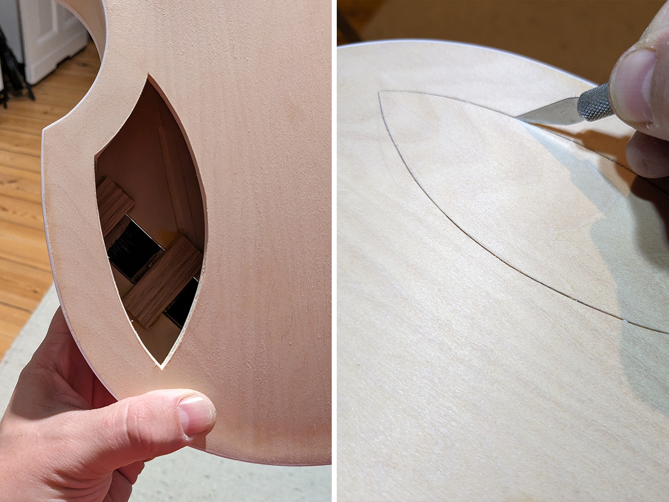

    Thanks! I moved on and opened the back, to have an electronics cavity. Just used a scalpelknife and it worked fine for the 4mm wood...

    That is a really beautiful cut. It's really the way these Höfners should have been done in the first place.
