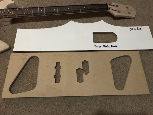

    Today I made some router templates for the neck pocket and pickup cavities. Routed the neck pocket and fitted the neck.
    Cut the top horn of the body. Measured scale length and put the bridge in place. Routed the pup cavities and drilled holes from the routes to the electronics cavity.
    Next I will put on sanding sealer for the body and neck.
