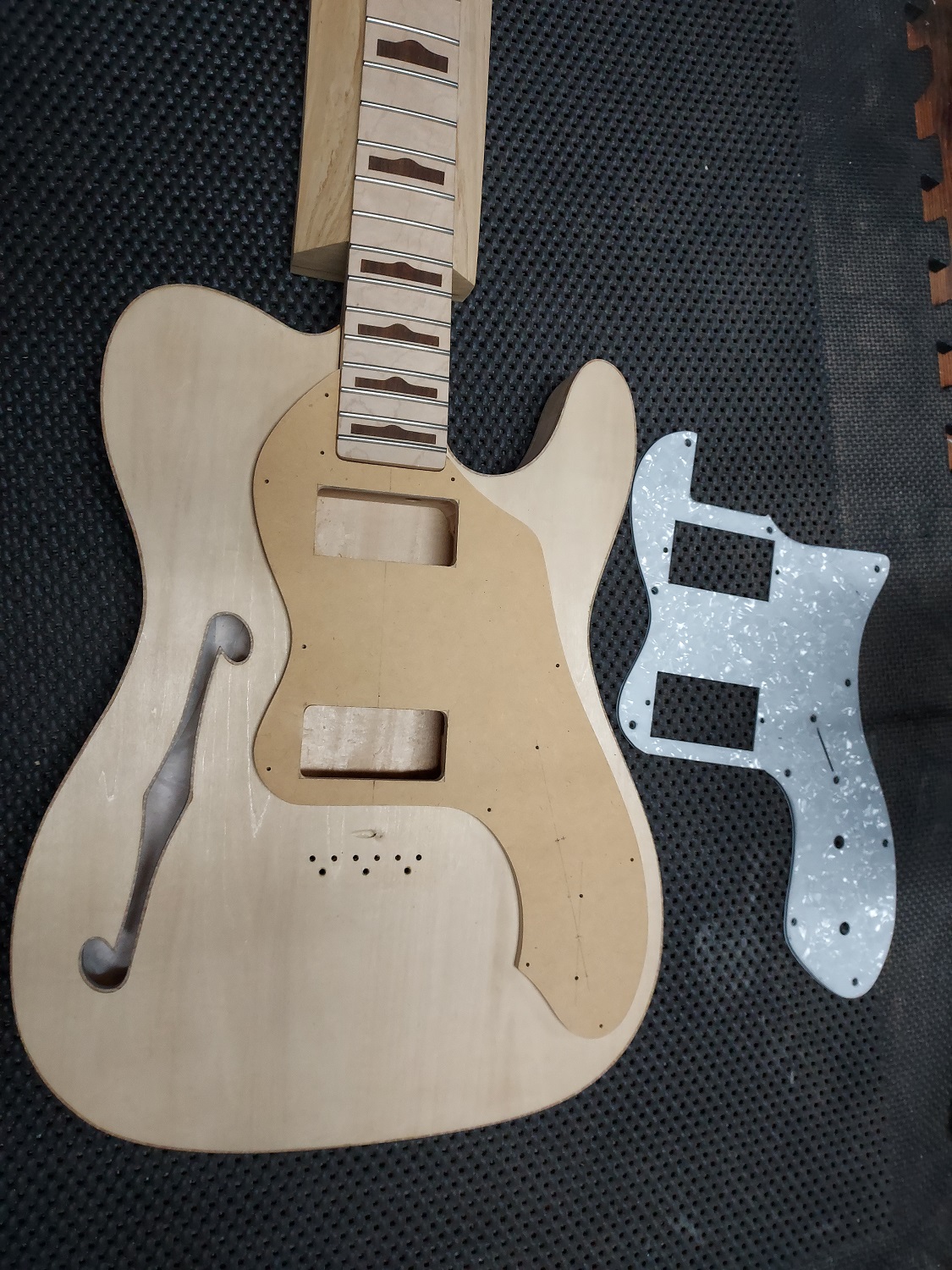

    Been a while. A bit of an overview of what's happened.
    Wanted to make a new pickguard. To get the curve to go around the f hole evenly, the bridge pup rout needed to go back about 9mm. Made a mdf template of the new shape.

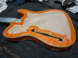

    As the colouring was to be done using stains, the only way I could think to use different colours next to each other was to seal the whole lot and use an airbrush to spray them on as if you were using paint. Had some vinyl sealer which was still good so used that.
    An example of the masking up.

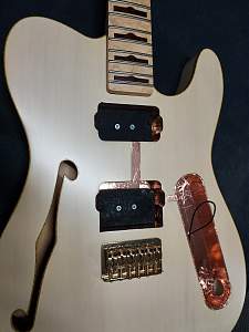

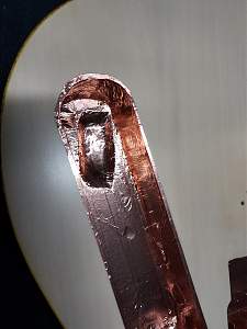

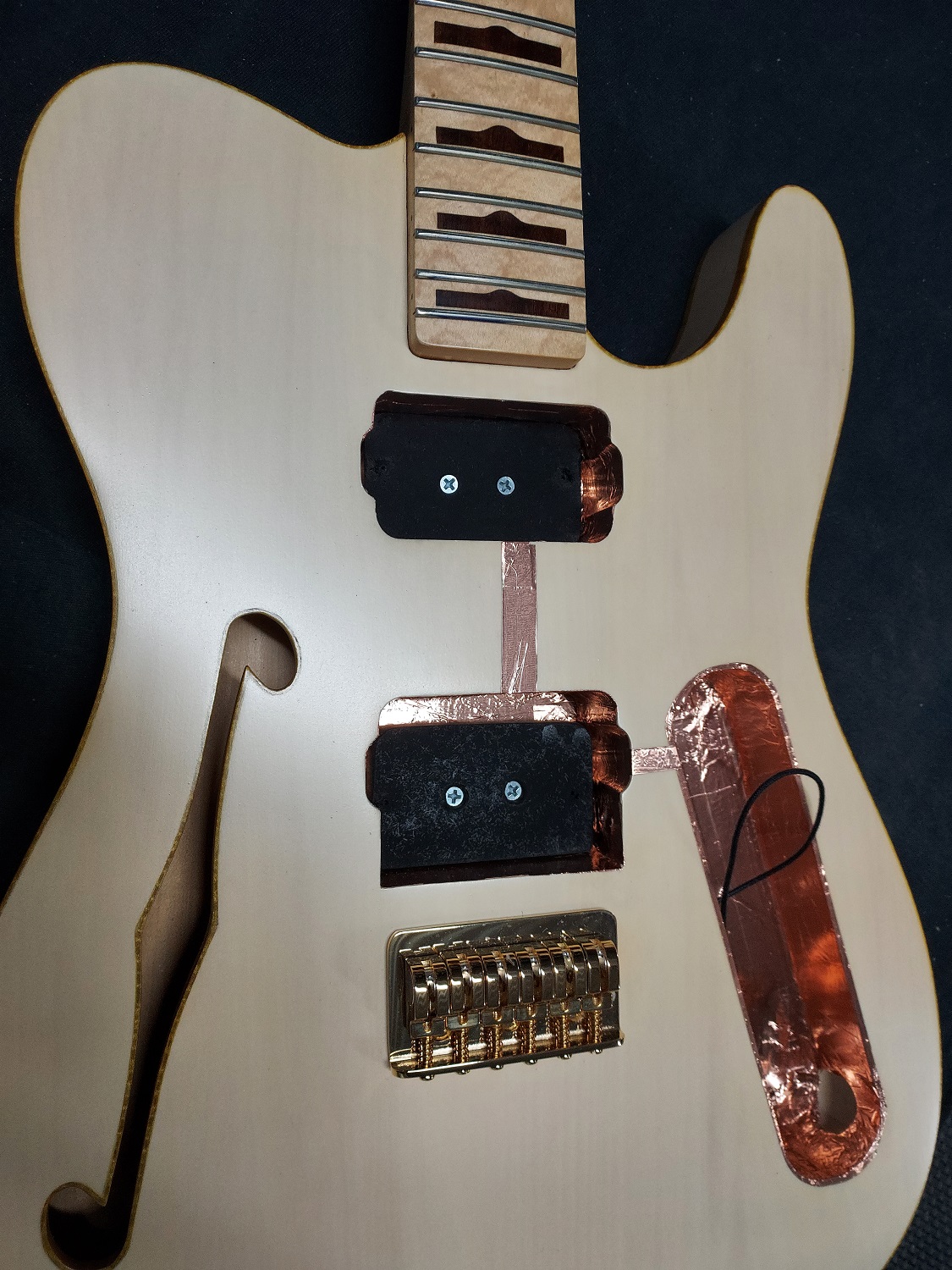

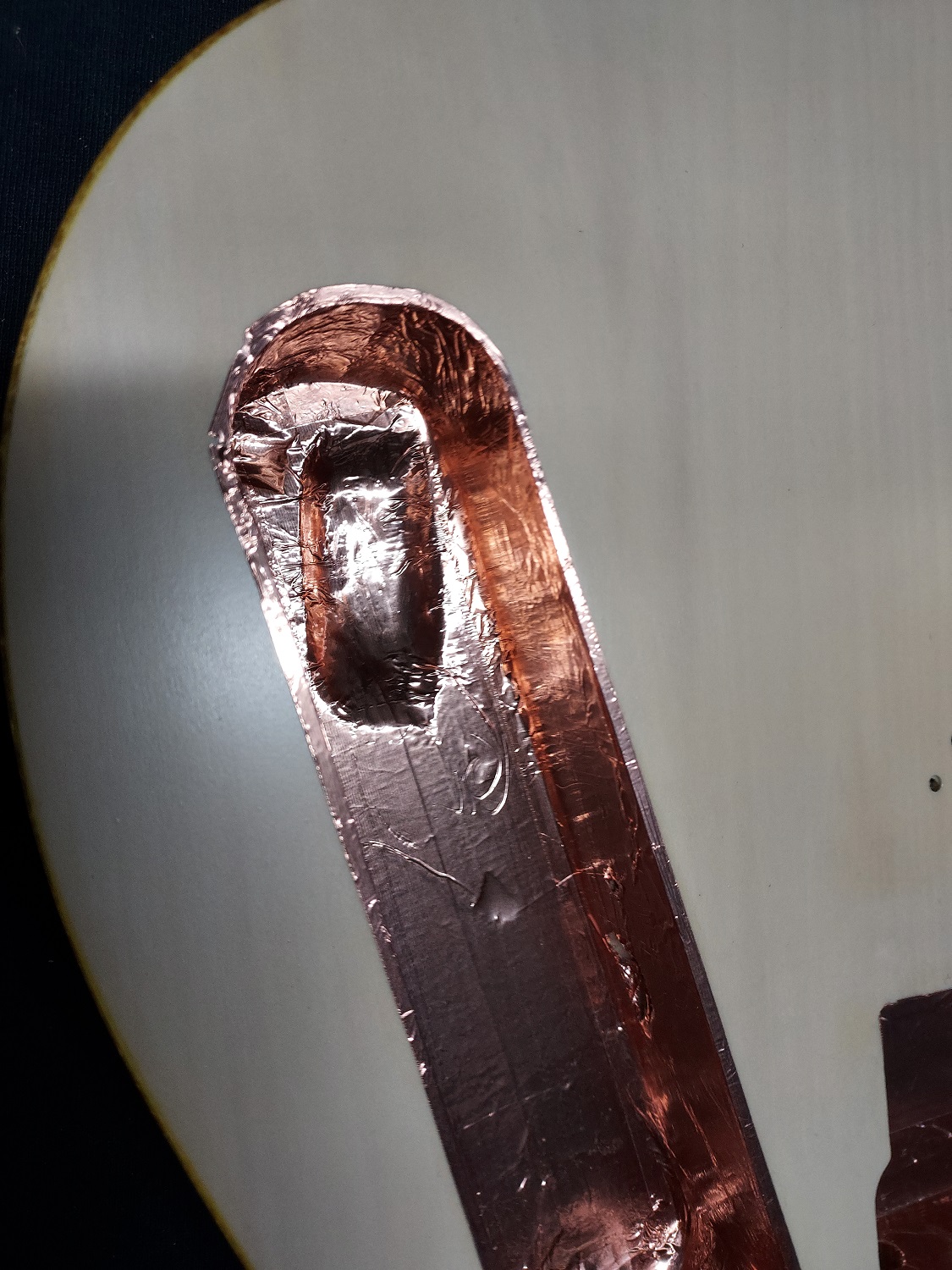

    Copper taped the cavities. Made it easy to see the relief in the bottom of the control cavity for the CRL 3 way switch.
    After the shielding, screwed the mounting blocks for the filtertrons.

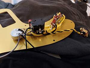

    Used full sized CTS pots, one a push-pull for the series mod. Had cut a piece of copper tape for the back the pickguard but wasn't sure if it would cause a problem with the vinyl used on the clear arylic 'guard, so left it off for now.

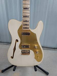

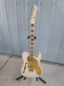

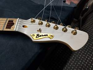

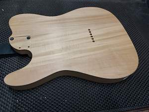

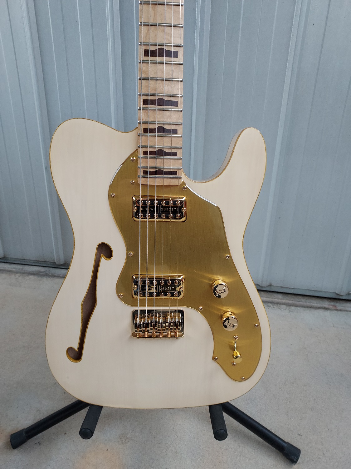

    Assembled. Rough set up done, strings quite high. Bone nut needs to be filed down so the bridge can be set up better.
    Some 'it's finally together' pics
ID:	44525Click image for larger version.
ID:	44527Click image for larger version.
    Grant
