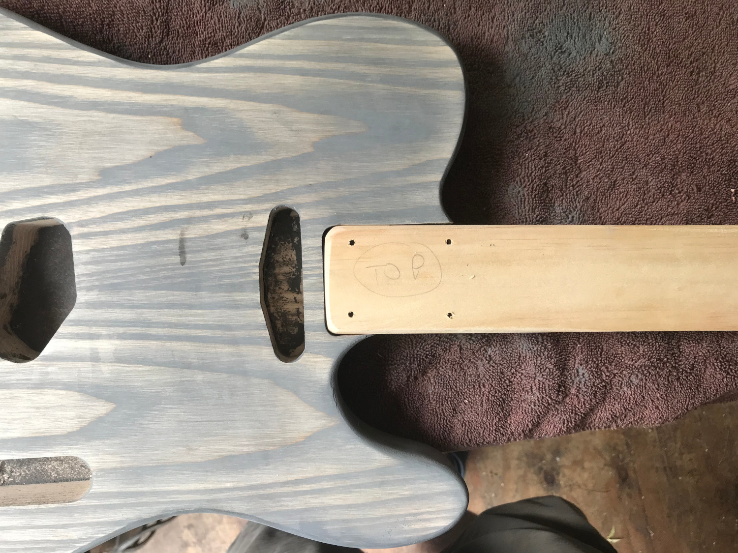

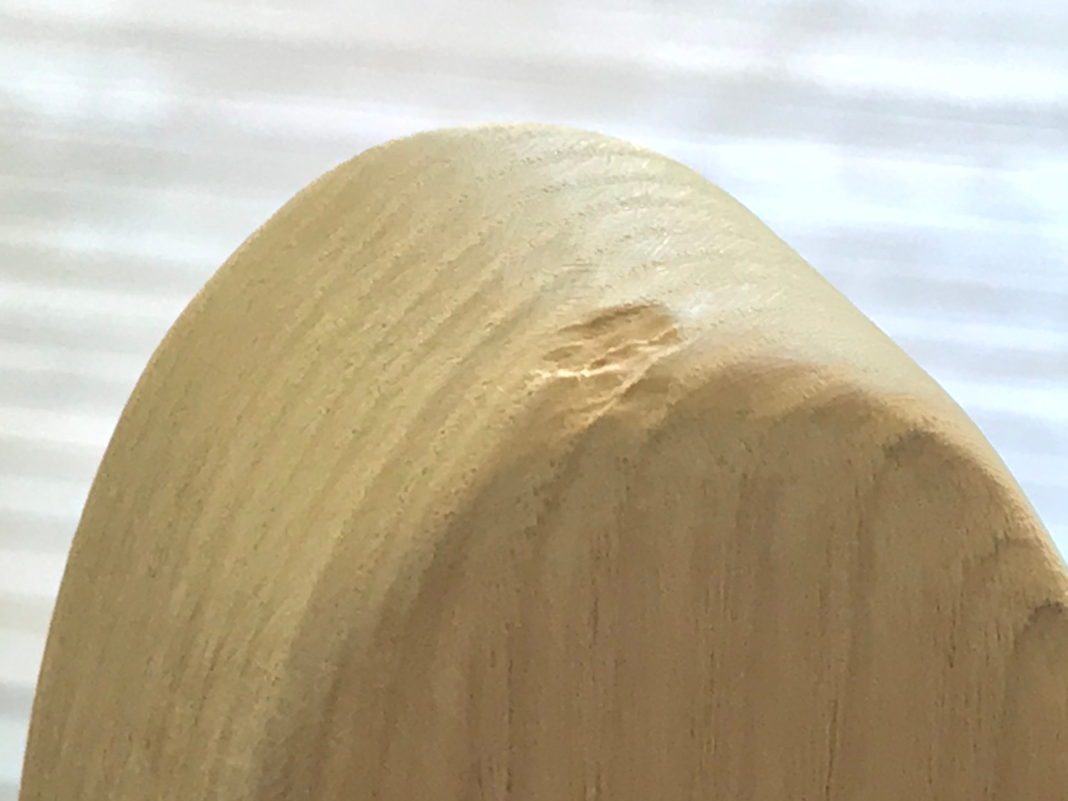

    In the meantime, I have the new body. The plan is to still do a transparent blue nitro finish, so I'll go through the process of timbermate and sanding. The new body has a little damage to the lower horn that doesn't look like a dent, so I don't think it'll come out with the steam iron, though I haven't tried that yet. Any ideas how to address this other than filling it? (I'm not going to rush into that so quickly this time.) It's also got a couple of cracks on the edge that look like they've been covered in glue.

    Unfortunately the neck bolt holes don't line up with the holes I have already drilled in the neck. I could try plugging and re-drilling the holes in the body to see if I can get them to line up with the neck, but I can't think of a way to do that reliably. The alternative would be to plug the holes in the neck and just re-drill them. I'd welcome any recommendations!

    If I were doing that build, I would just sand out that ding in the horn. I would also have a go at sanding those cracks in the end grain as well. The don't look that deep and it would be good to at least make sure that all the glue (or filler???) is gone from there.
    With the horn, I know it will alter the traditional tele shape a bit, but I personally prefer making the edges & horns more rounded than standard strats & teles anyway, but that's just me...
  6. #26
  7. #27
    And, what Simon said about plugging the neck...
    Thanks McCreed - I don't know why I didn't think of that ;-)

    Plug the holes in the neck itself and re-drill those.
    I needed to make a "handle" to hold the body while I paint it, so I figured I'd use that as template to transfer the neck bolt hole positions from the old body to the new one, and if that didn't work, I could just plug and re-drill.
    So I fitted the "handle" to old body, put marks on it using the neck bolts through the holes, drilled them out, fitted the handle to new body, used the holes and bolts to make marks on the new body, and then drilled them out.

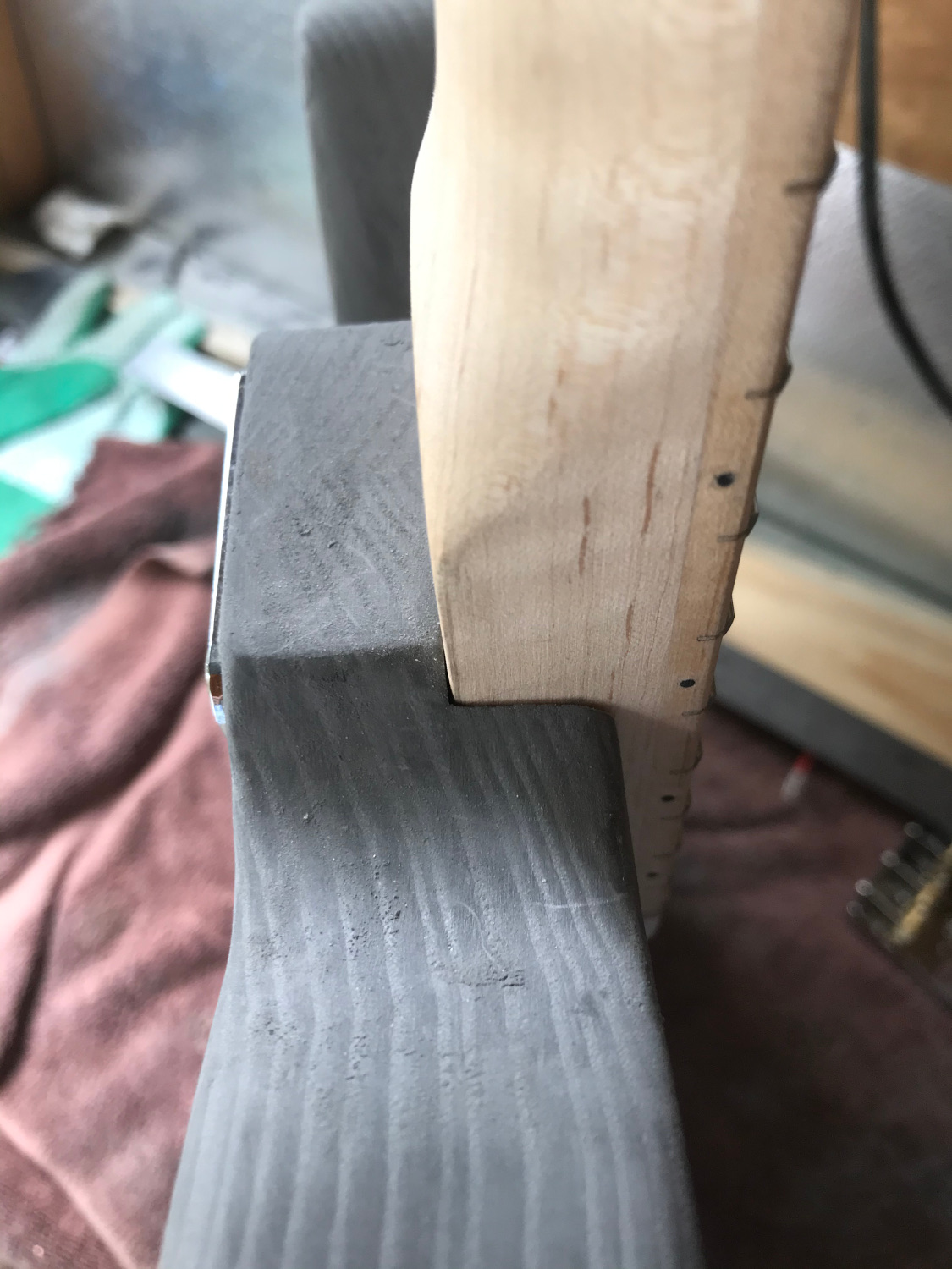

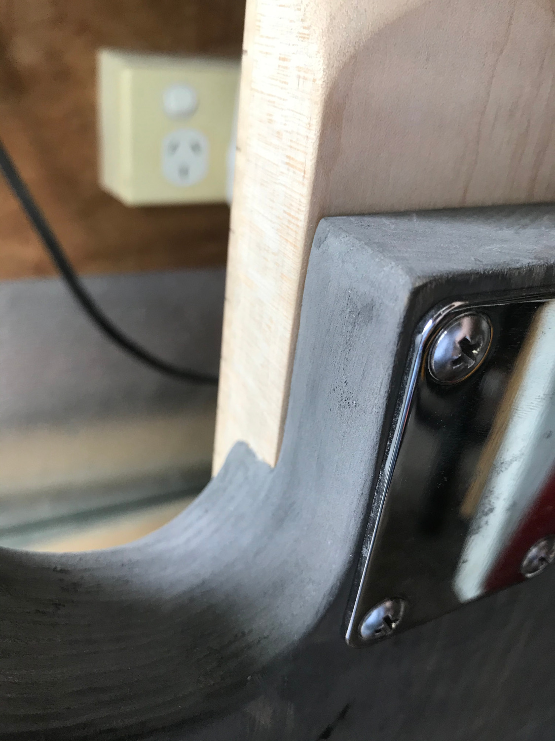

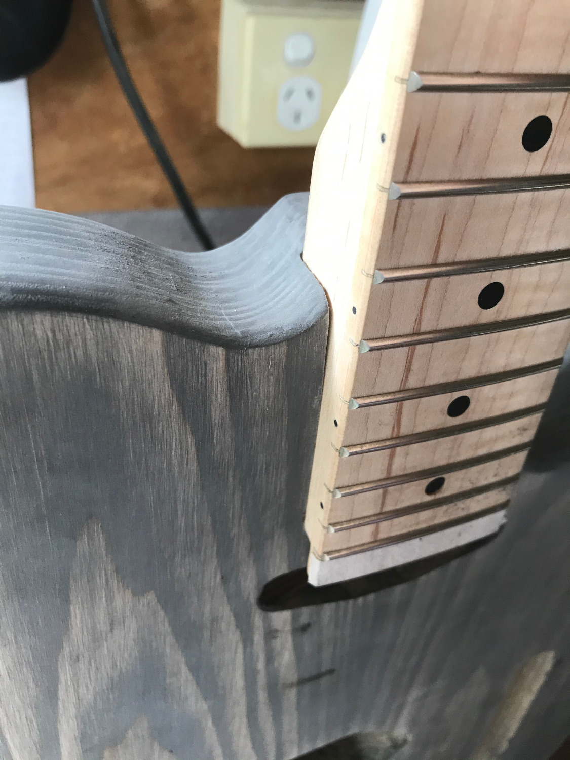

    That seems to have worked OK. Before I mark out where the bridge goes, I'd be grateful for confirmation that my neck placement is OK. The neck is a very snug fit in the pocket, though the treble side of the pocket isn't a straight route, so there's a bit of a gap. Also, the neck itself slightly overhangs the body on the bass side.

    Does this look OK, or should I try to reshape the pocket? I should have noticed this before I drilled the bolt holes, but that's hindsight for you.

    Most important thing is the string alignment between nut and bridge.
    Is the neck finished yet? If it isn’t finished you may find that once it is finished it will be too tight, so you may need to tidy up the bass side of the pocket. The neck slightly overhanging the body on the treble side shouldn’t affect playability, it is just a minor aesthetic issue.
