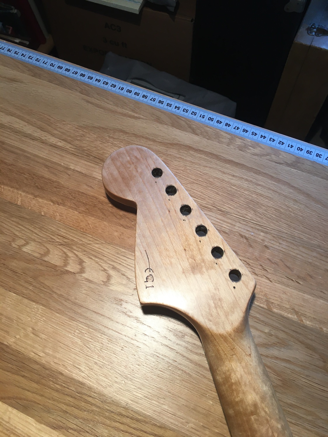

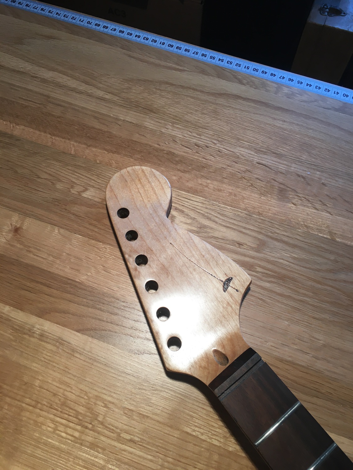

Anyway, to the guitar diary. DMS-1 unpacked, all the parts seem to be present and correct, including the upgrades to a bone nut and Grover tuners. Two-piece ash body, maple fingerboard

No major dents or damage to the body or neck as far as I can see, but there are a few niggles to overcome; I'd be interested to hear if these are common on Pit Bull kits.

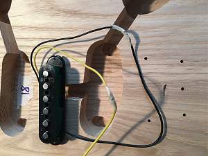

1. A couple of wiring niggles; the wire to the selector switch only just reaches from the volume pot to its location, pulling tight on the cavity corners, so I'll be re-wiring that to give a bit of slack, and there's a joint in both wires on one of the pick-ups for no apparent reason, other than possibly wanting to make use of every last scrap of wire on a roll! Again, I'll re-wire that to avoid all unnecessary joints.

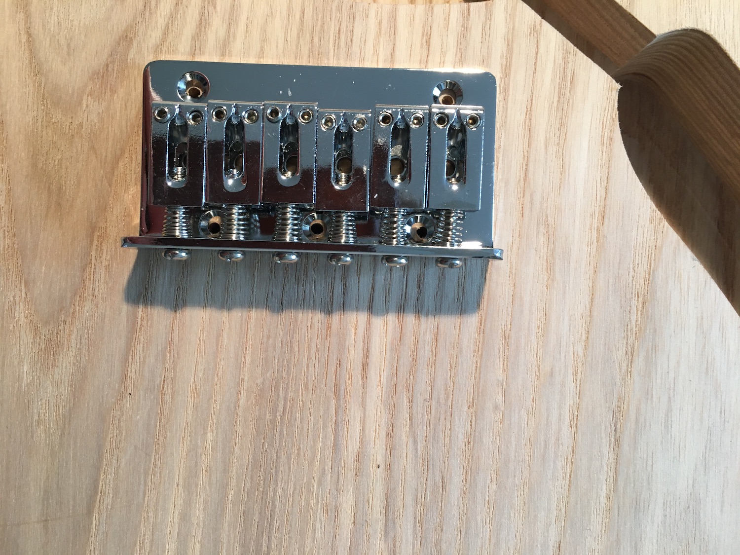

3. The pre-drilled holes for the bridge aren't all aligned - maybe the template was for a different bridge. The front two and the middle rear one look OK, so I'll think about plugging and re-drilling the other two - I hate screws that go in crooked!

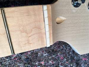

4. It looks like the router took two passes at the nut slot, and didn't get them aligned. I wouldn't have worried if the extra gap was at the back, but at the front it may allow the nut to twist. Maybe another sliver of maple...
