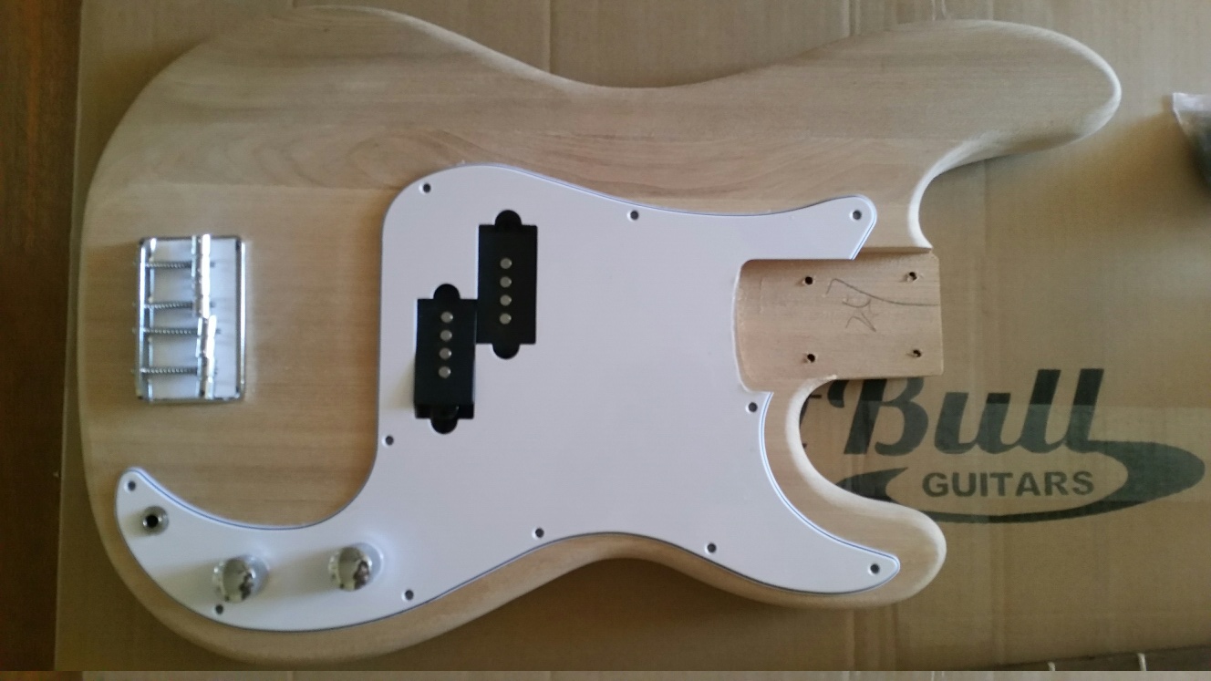

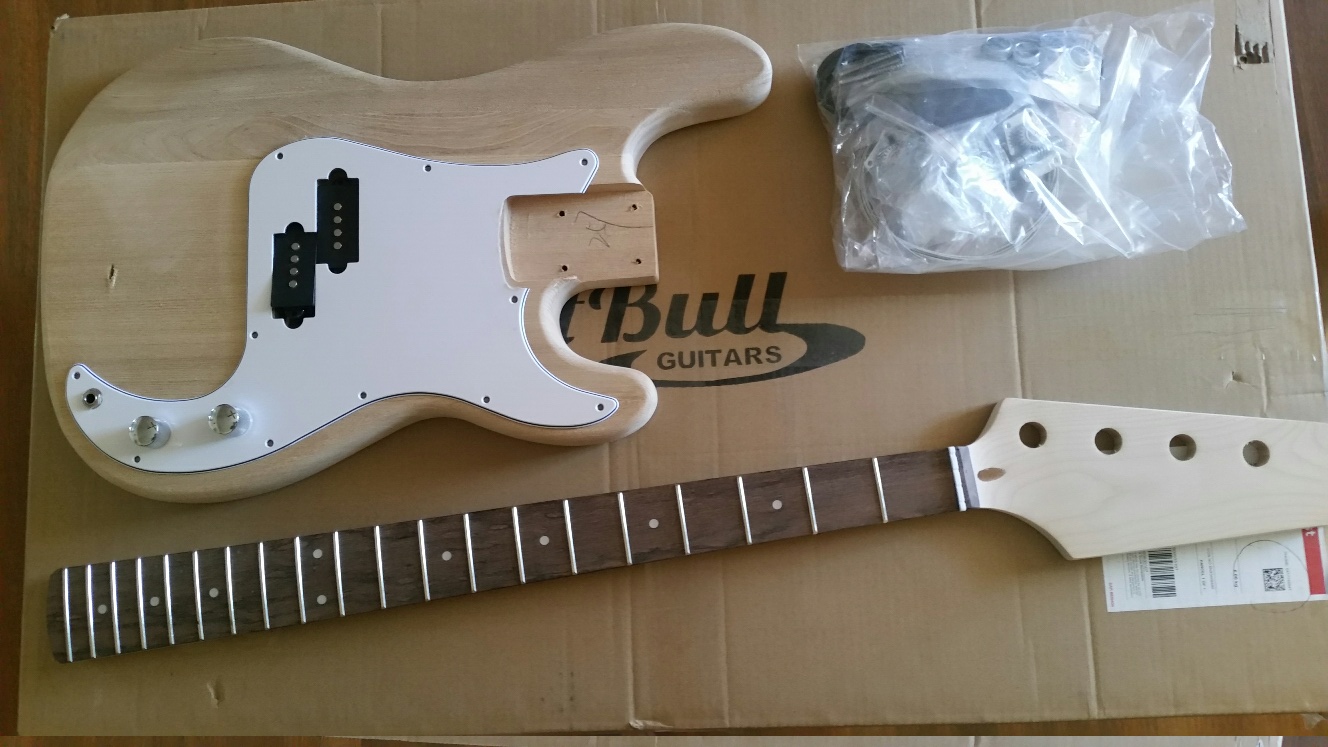

    Quite soon after arrival I started checking the box contents and ensuring I had the right number of screws and bits and pieces, and the bone nut I paid that tiny bit extra for. All was good. Next was a closer examination to ensure there was nil damage during transit. Something that cant be seen in the photo is the two round puncture/crush marks in the box where the volume and tone knobs had tried to exit the box. A check of the two controls confirmed nil damage to the kit parts so I figured I could let that slide.
    Neck fit is good into the body. And there are nil dings of significance that sanding will not correct. The electronics person in me feels a little abandoned as there is nil soldering to be done as this kit comes with a fully wired pick guard, 100% completed... lol.
    So my job is to give this neck and body a colour and a finish, bolt it together, tune and intonate, and then play.... Simples!
    My heart is telling me to try for a burst... my head is saying that a Yellow/Red/Black burst would be a skills challenge...

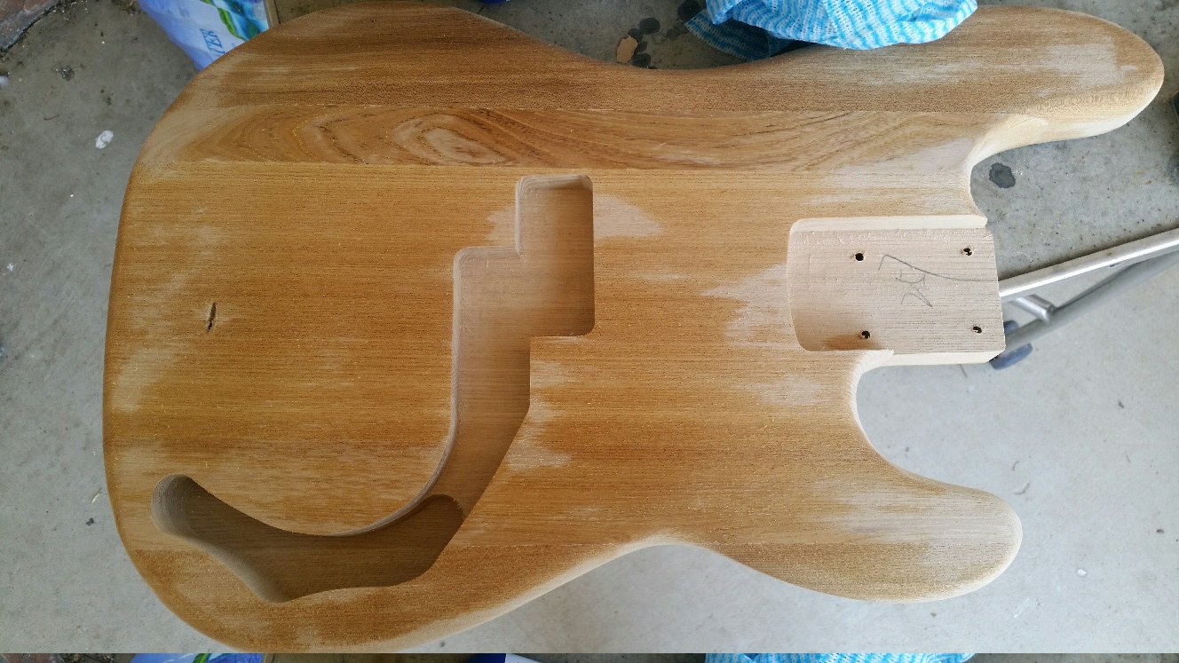

    Got stuck right in and started sanding with 320 grit to refine those edges and prep the surface.... Of course you damp down to raise the grain a little so the when it comes time to paint you don't have many of those little buggars standing up through your paint layer....
    But, Hmmm.... something looks off if this is going to be a burst.... Starting to think this might have to be a solid colour.... like this old 1959 I found on the interwebs...
