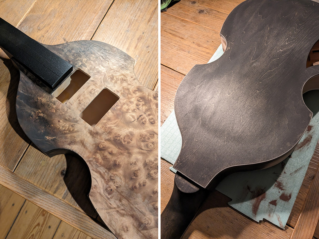

    Well, some time has passed...took a break during the winter, but the last weeks have been productive though...
    After sealing the electronic cavity in the front I tried one more time to veneer a body...and like the last time it did not went perfect...
    Again there are some bumps...i think curved tops are very hard to veneer without a vacuum press and experience maybe it is also because of the veneer, which was thin and dry...maybe you have first to soften such veneer, to make it more flexible...but I am still fine with that result...

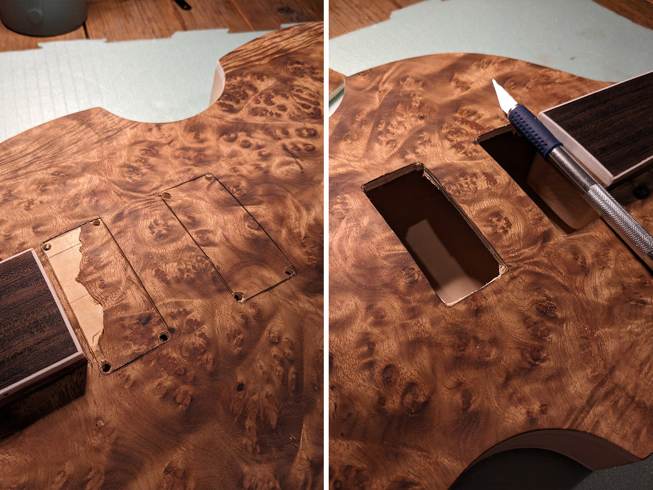

    After reparing all the cracks and broken parts of the veneer I went on cutting the Humbucker cavities, using a scalpel knife...
    The placement is similar to a Höfner Cavern Bass...

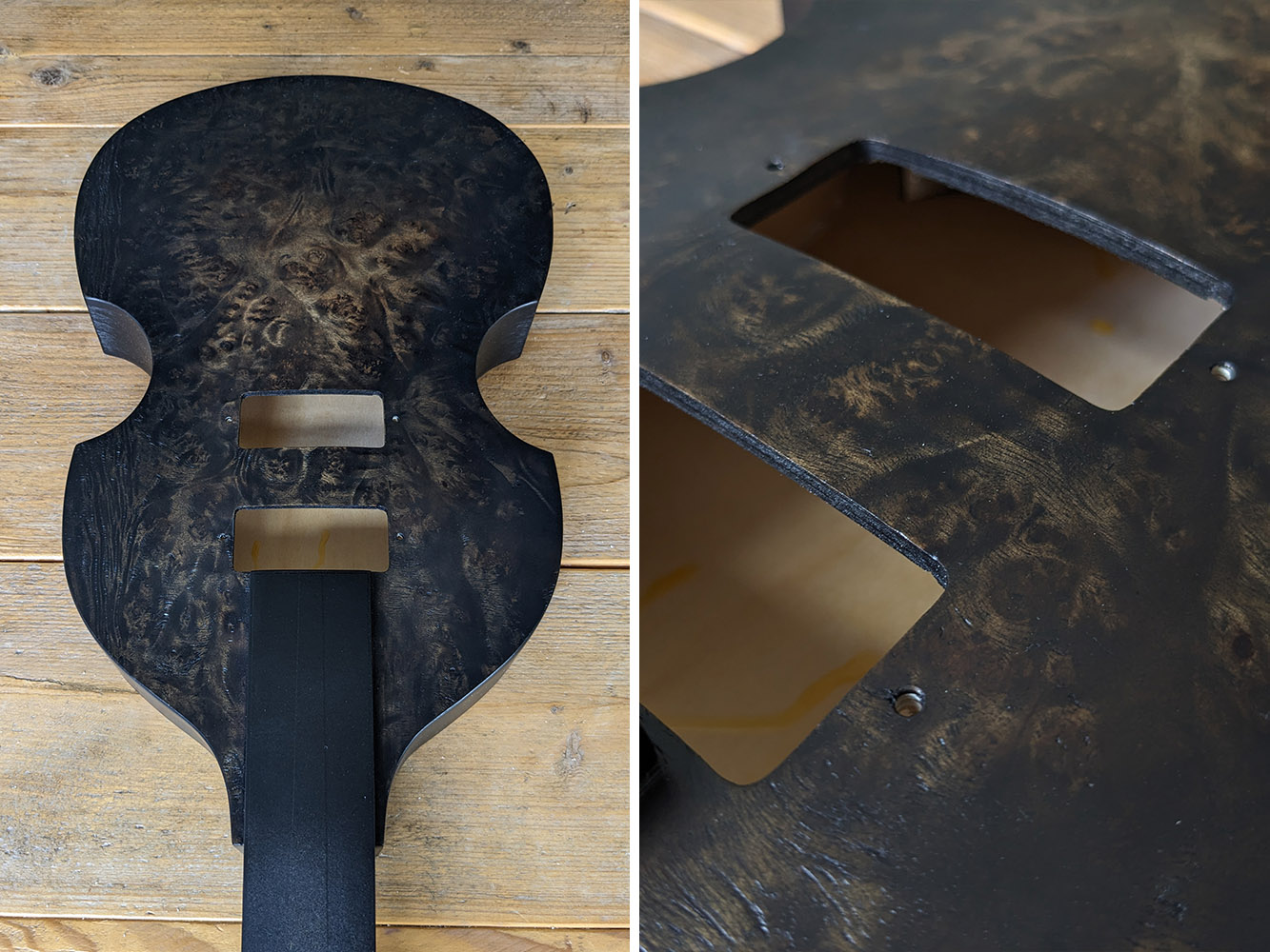

    As I planned to color it black I went on with some black color oil to make the front black on sides with lighter gradient to the centre of the body...the neck and sides are painted plain black, trying to cover the white binding in to black ...I sealed it with some coats of clear lack and hope that it wirll stay black

    Wow, that veneer looks amazing! What type of wood is it?
  7. #17
    Jun 2020
    Berlin, Germany
    128
    I translated the name like "Golden Madrona Burl Veneer"
    Not sure if it is right 🙂
