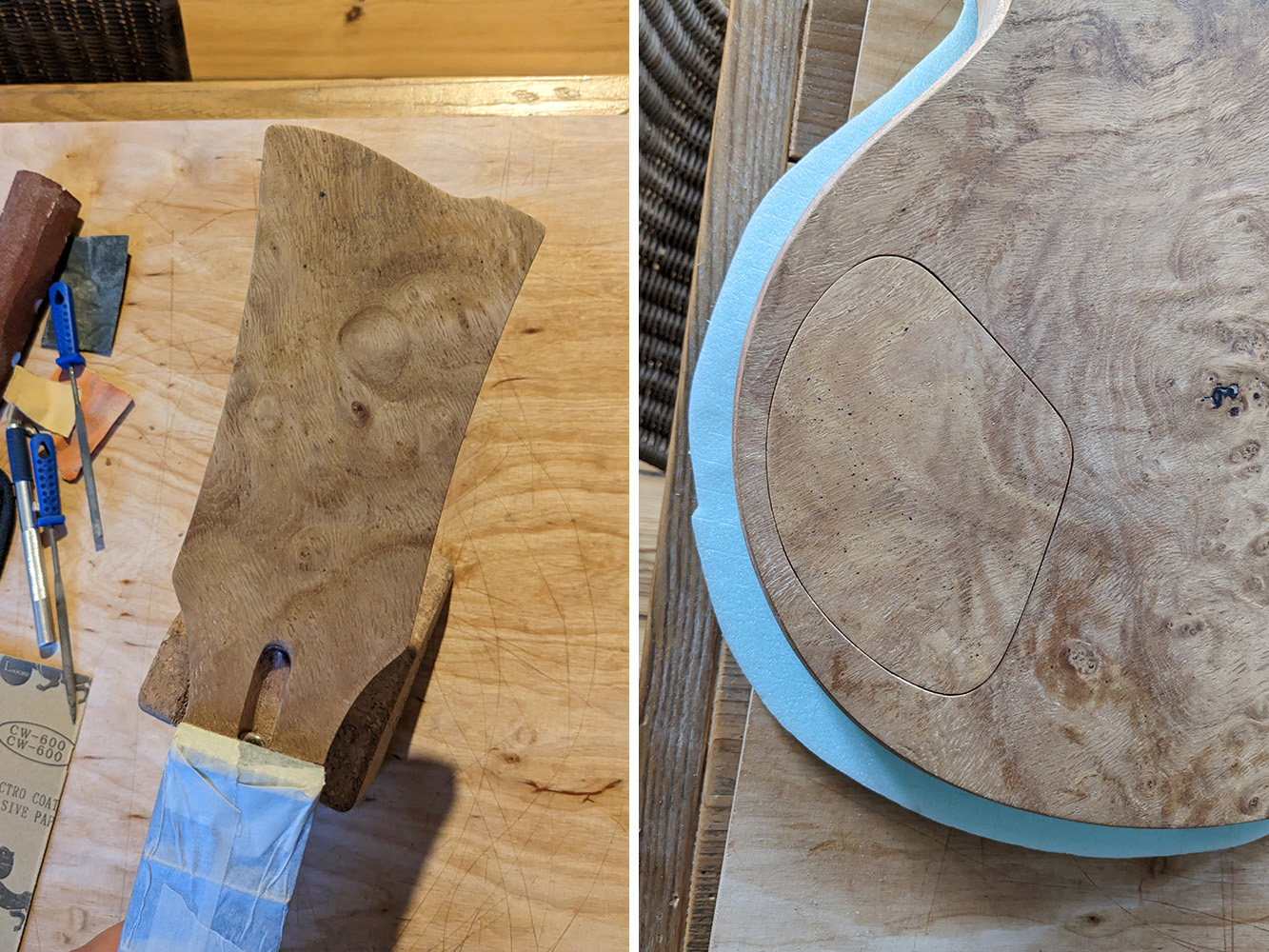

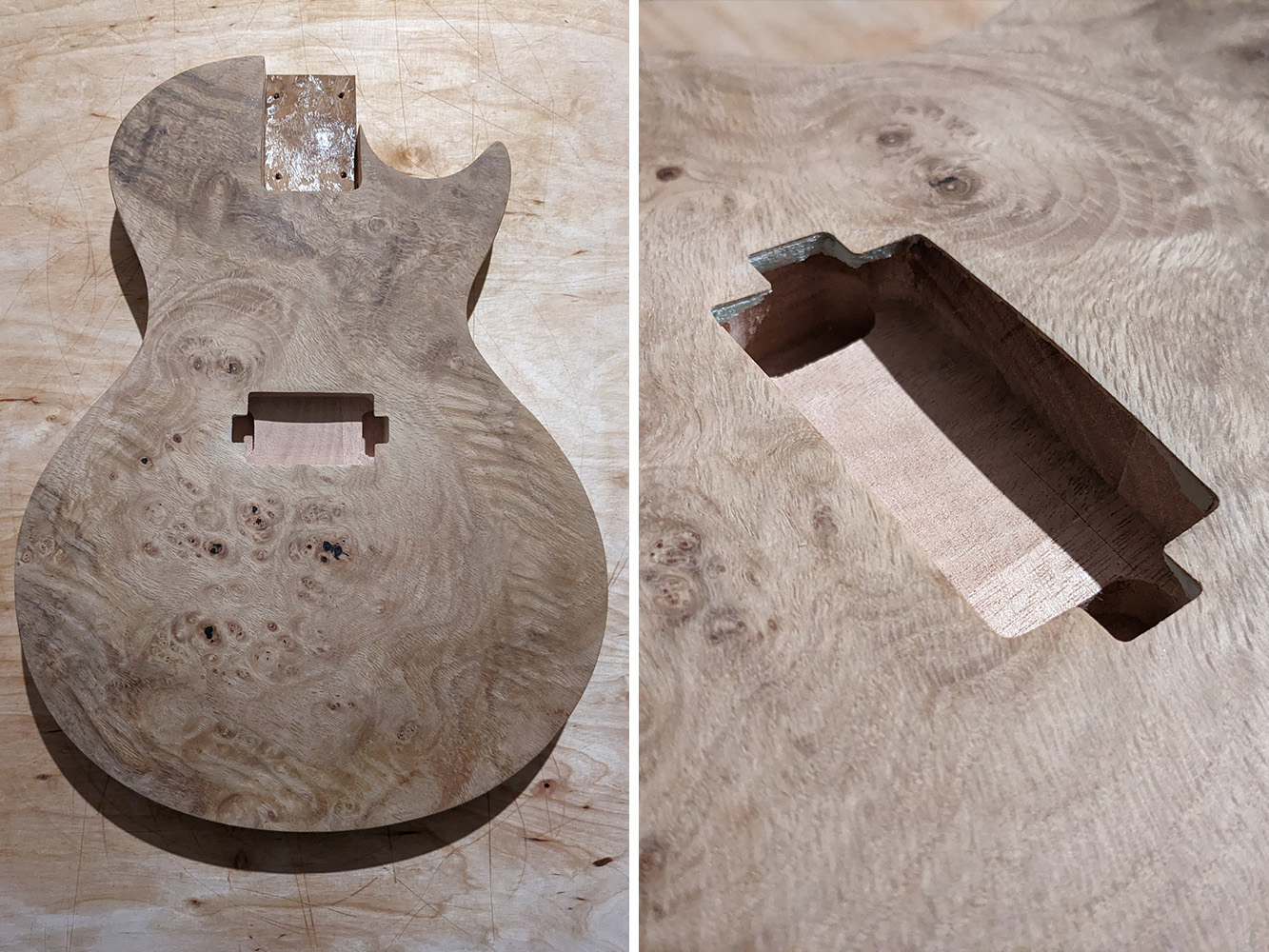

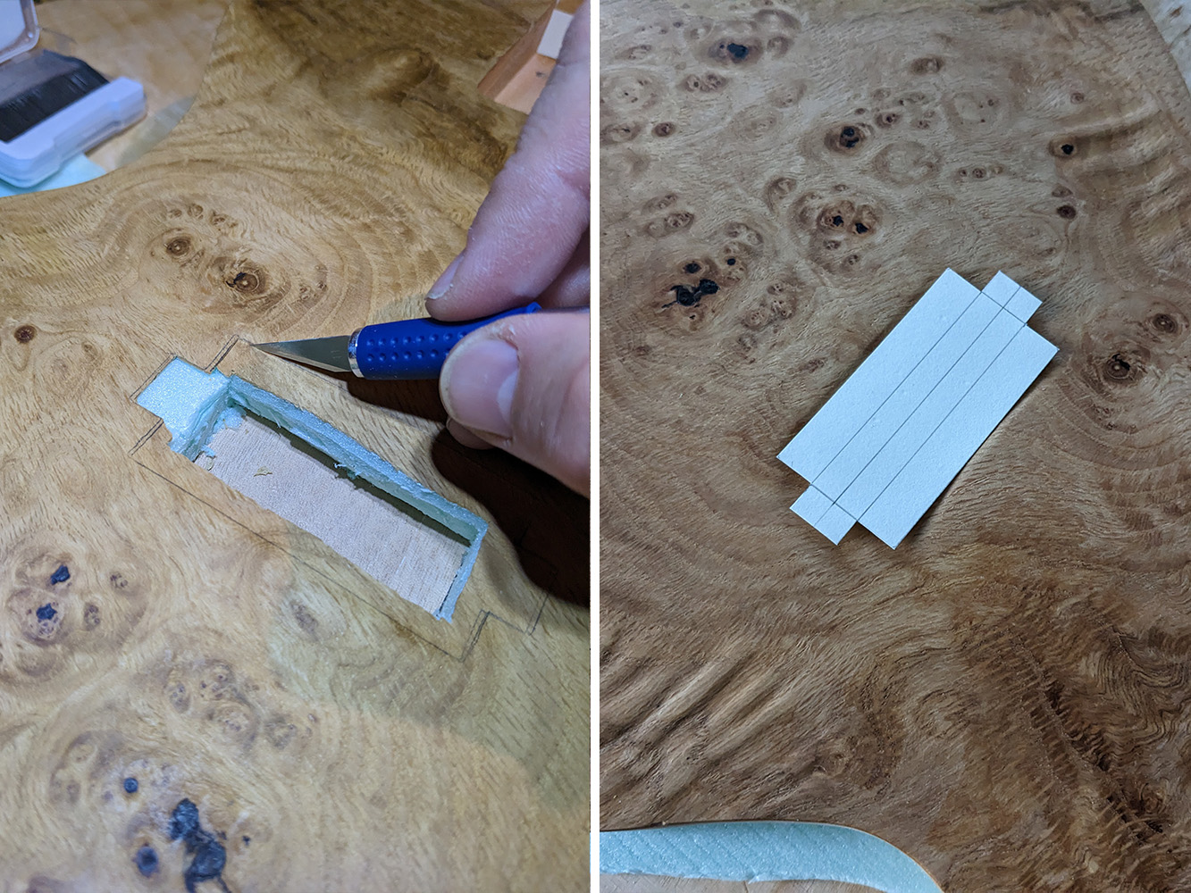

    Moved on with shaping and veneering the headstock. Also made the pickup cavity and electronics cover.

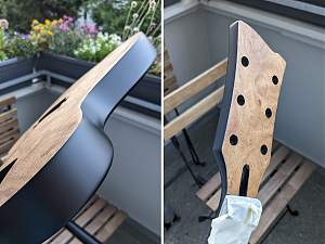

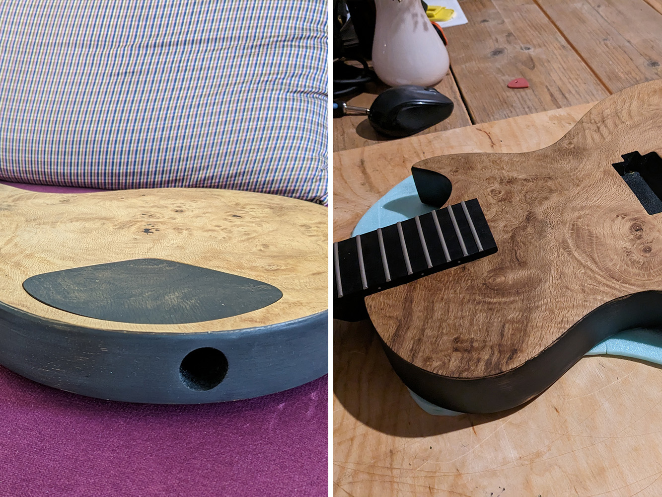

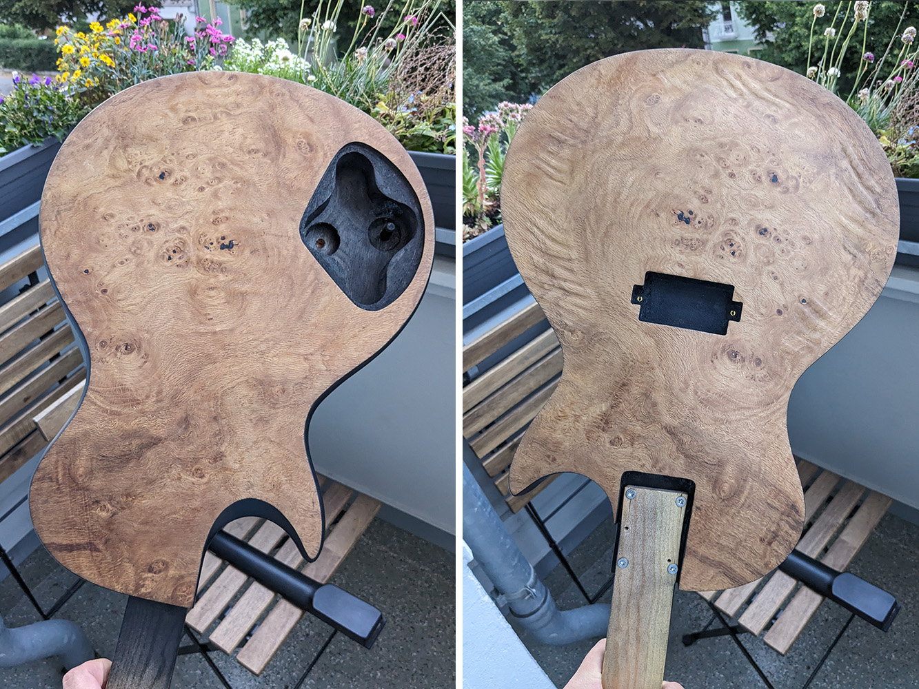

    Moved on, trying out some black stain and black colored oil. The oil is fine, but becomes glossy and sticky with every coat (maybe it has to dry out longer) But I could not get the right result for the black sides and the neck. Between veneer and wood I still had some parts of glue and woodfiller which could not be covered properly by stain or oil, of course.
    So I came back to black mat finish aerosol which I already used on my Explorer. This seems to work fine for me. Did not use any grainfiller, so the wood structure is still visible, which does somehow correspond with the wooden parts.
    The wooden parts get some coats of clear semi-gloss/mat finish and that will be the final solution for this two colored guitar.

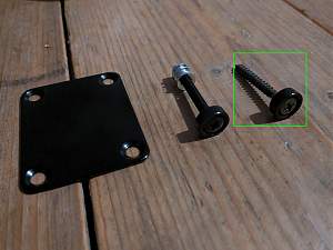

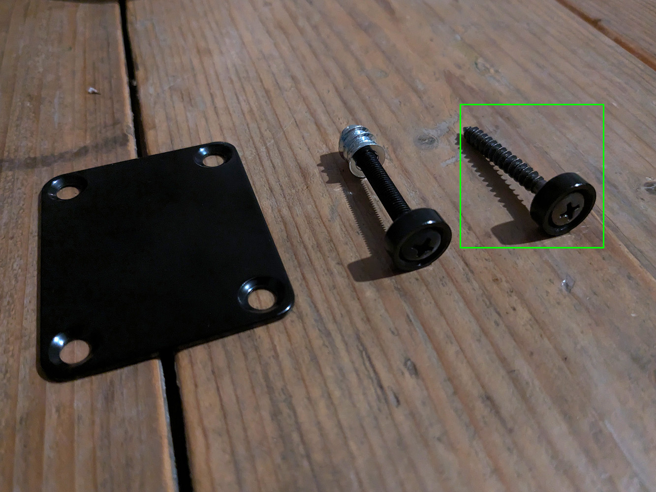

    For the mounting of the neck I was not sure which direction to choose, but I think I prefer the marked one. The metal plate (as supposed by the kit) looks just to massive and takes too much attention on this wooden structure. It looks better with the screws put inside the "pods", don't know how to call it. So I think the classic screws directly into the neck should work. And I dont think I will ever remove the neck again, but did not want to glue it this time.

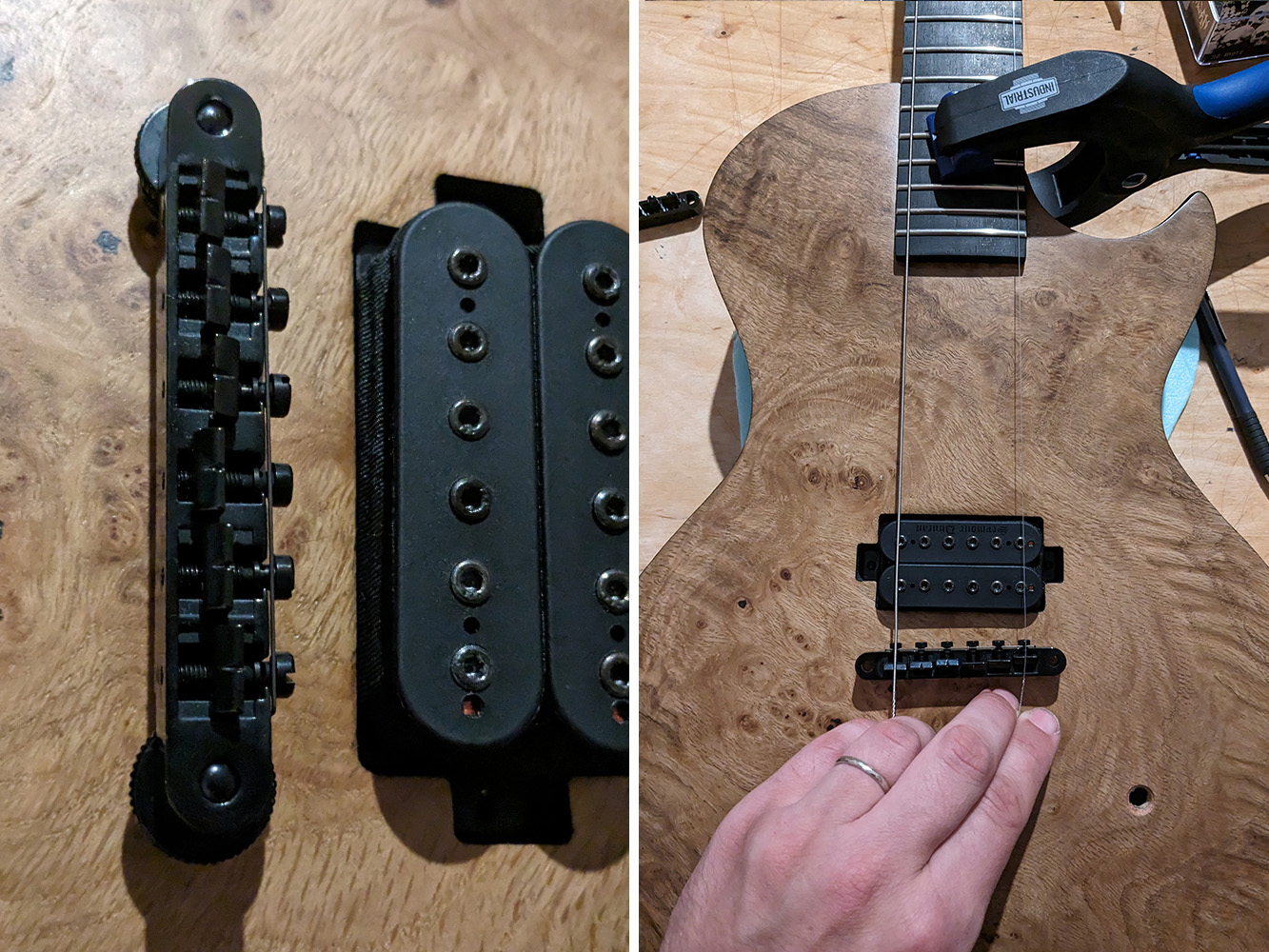

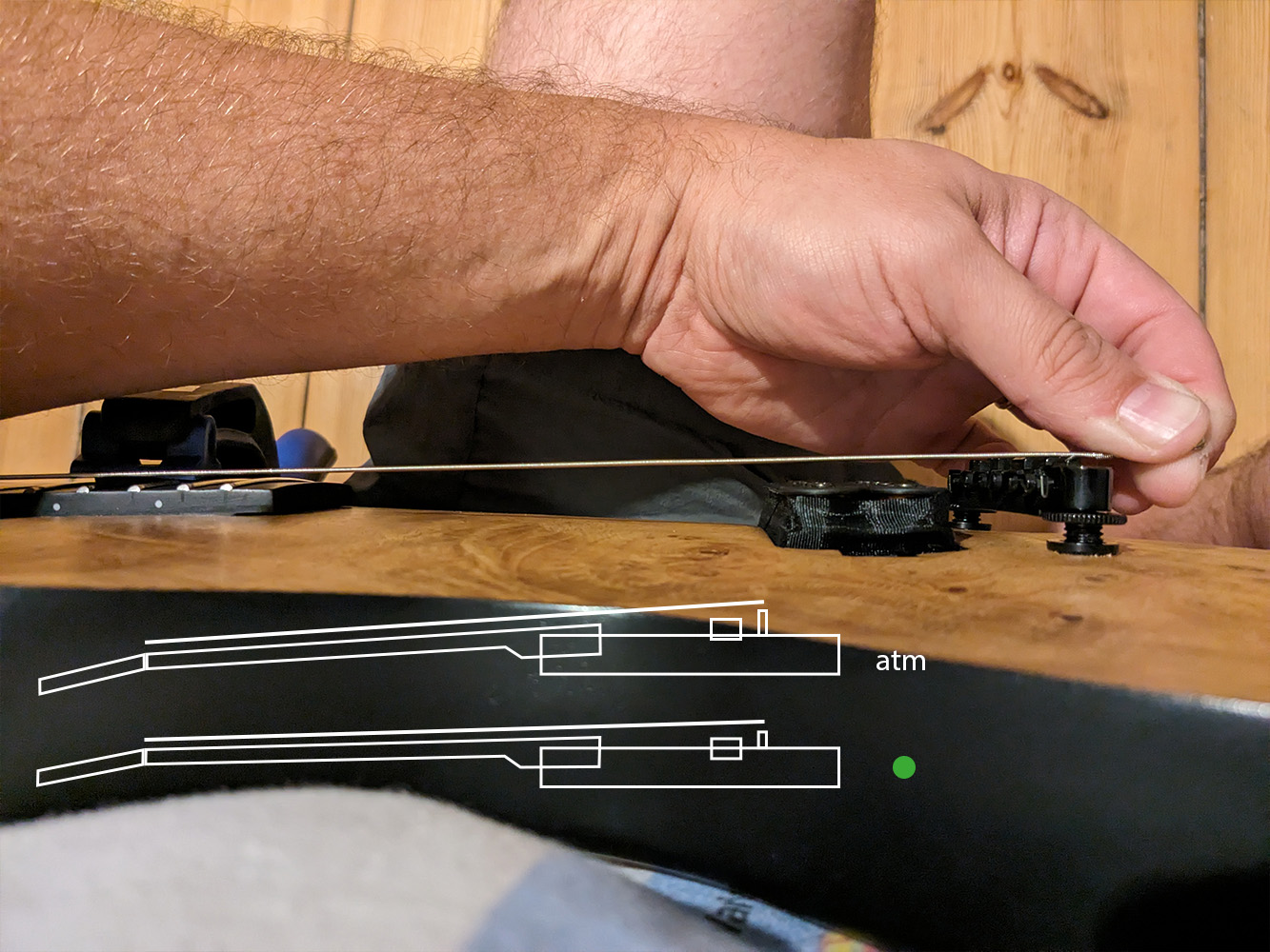

    Now I went for the bridgeadjustment. At least I tried. And (like almost everything with this kit) it did not get totally right. I messed up the holes a bit. They are now a bit more than 74 mm away from each other. Most bridges have something about 74, now it is a bit tight. At least one bridge that I have fits, and the other does not. But somehow it should work.
    What I am more worried about is the neck/body angle. I think about reducing the angle, so the bridge does not have to come out so far catching the strings and preventing them from touching the fretboard. In my eyes it goes quiet far, also for the humbucker. So why not flatten the angle and making the neck and body run more parallel. For example like on an explorer. Actually it should work, or could this negatively affect the whole thing?
    I also think, that for the strings through body version in this case a more flat angle would be better for the strings going in a better flat angel into the body after the bridge. Or am I wrong?

  10. #20
    You certainly can reduce the angle, but you need to be very careful and only do it by a minimal amount. I’d first use a very thin shim (say 0.5mm) at the front edge of the pocket and see where that gets you. This should give you a good idea about the angle change required. It should take the bridge down by around 2mm. What you don’t want is to decrease the angle so much that you can’t lower the bridge enough and end up with a high action. A high bridge is preferable! You might consider living with a shim (if it’s not too obvious) as the safe option.
