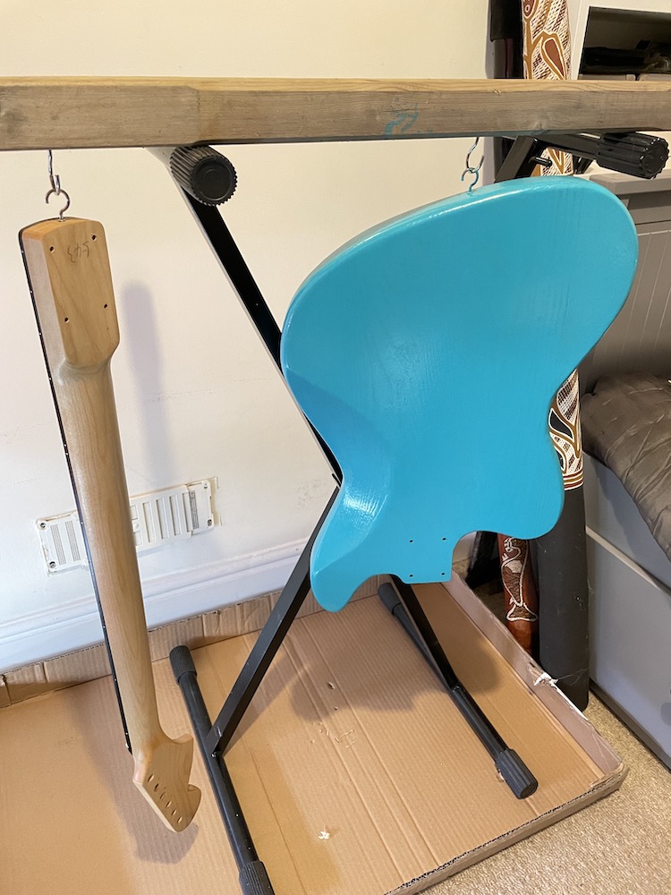

    Third colour coat on the body and second clear coat on the neck.
    I'm probably only going to do three coats on the neck. The body will have around three more colour coats and then around four clear coats.
